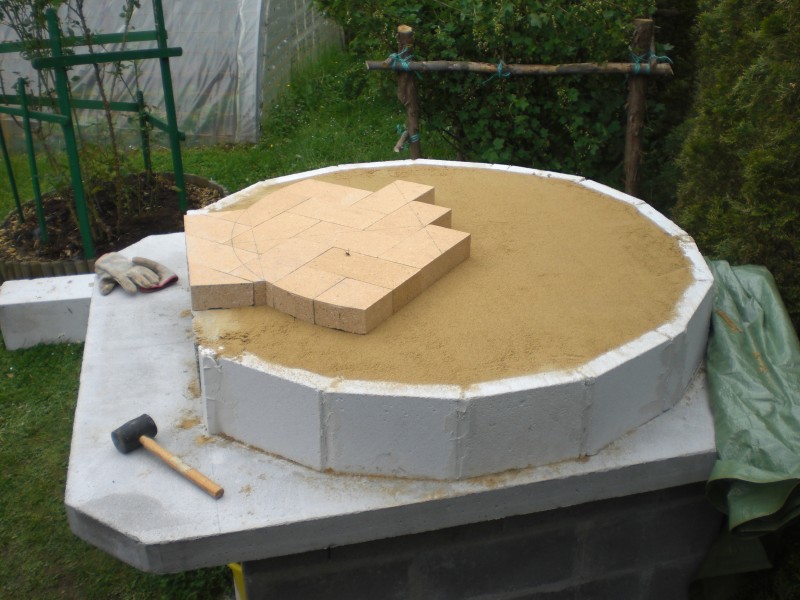

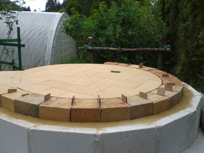

Hi,

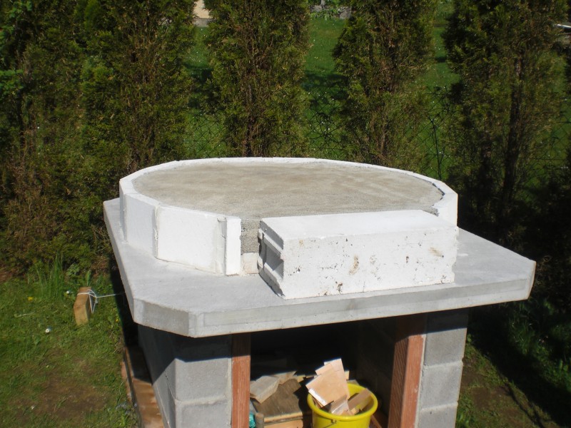

after finding this forum a year ago I had to start my own build

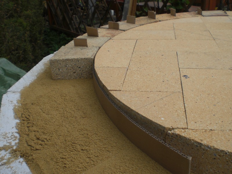

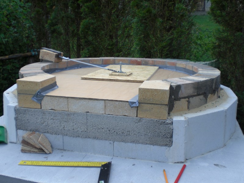

Cement block base is 120cm x 120cm (47" x47") and top slab is 152xm x 168cm (60" x 66"). Height so far is 90cm (35.5").
I am thinking of doing 20cm (8") vermiculite concrete for floor insulation. What do you guys think? Will that be enough?
I can get vermiculite V3 (1-3mm) and V6 (1-6mm) which one is better?
Looking forward to your comments.
Gorazd
