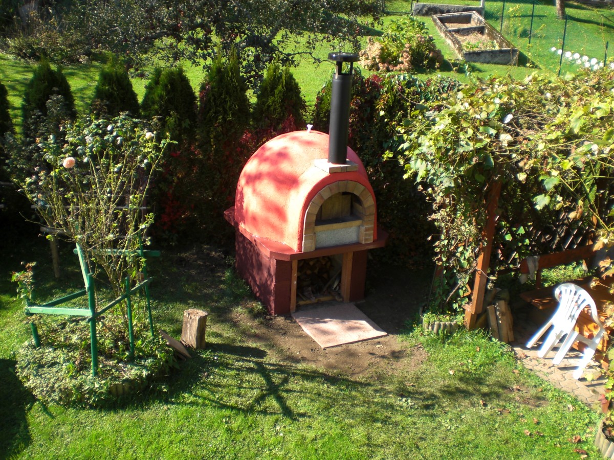

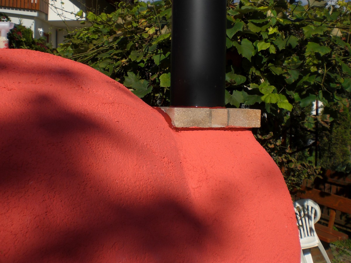

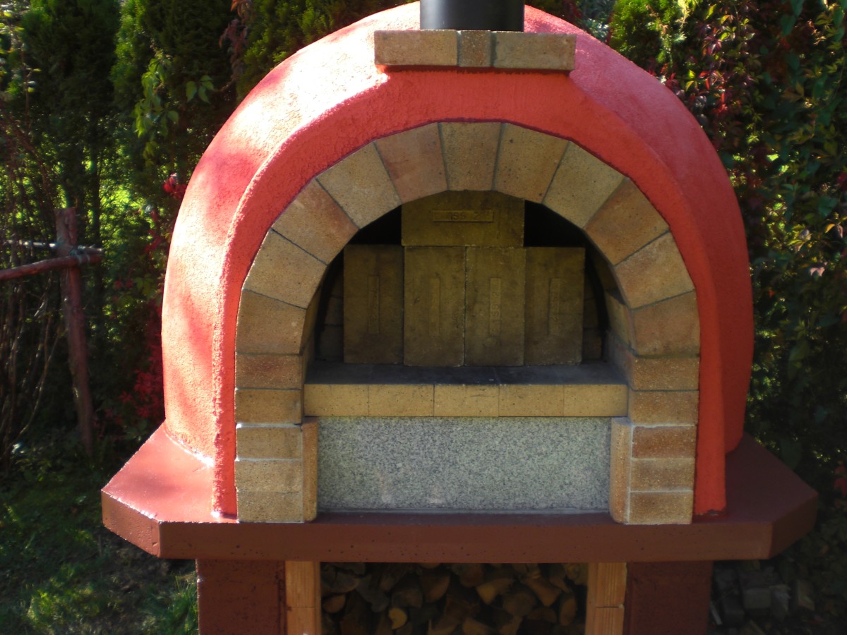

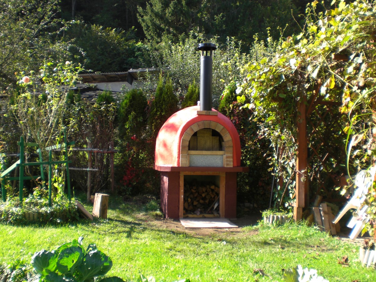

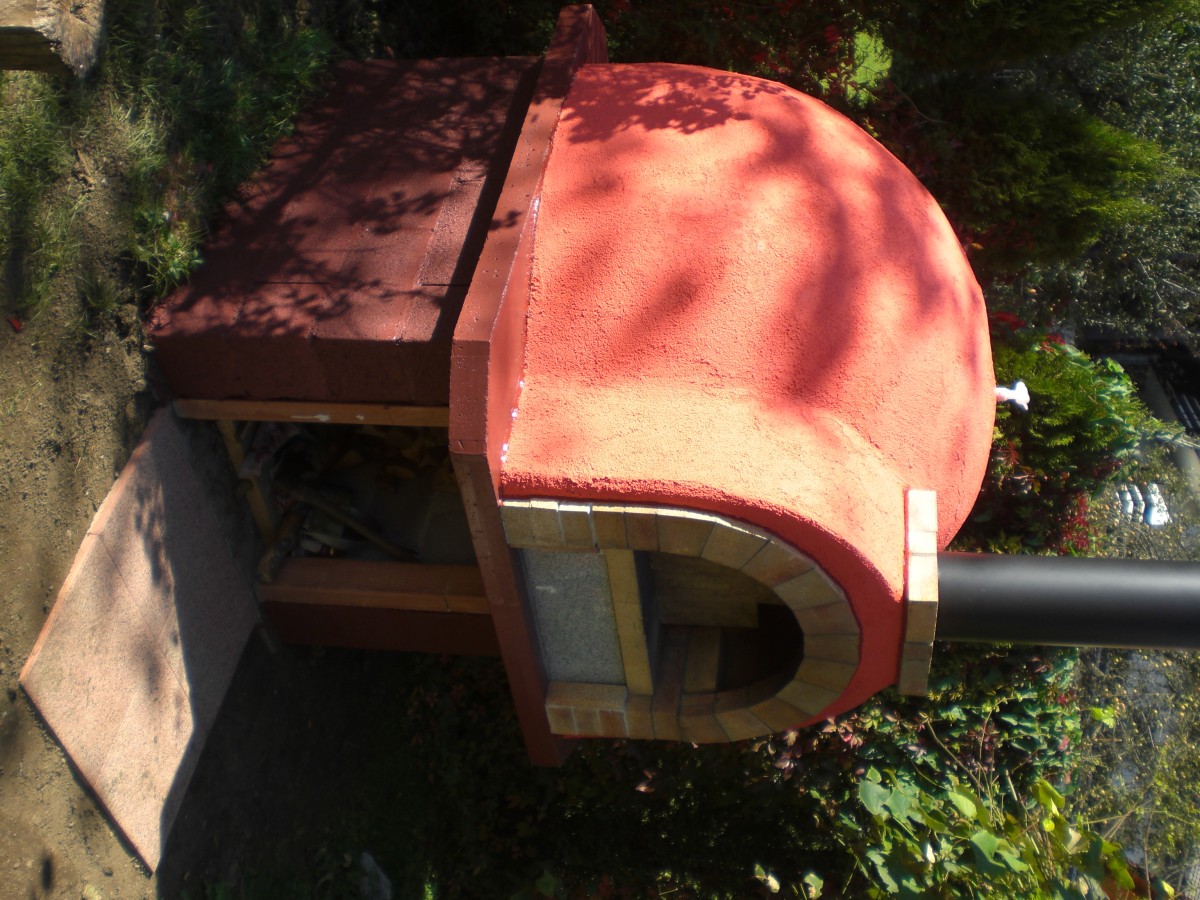

        • #64
          Finished oven
          I finished the oven. I still have to make two doors but it is now waterproof.
          Here are some pictures:

          • #65
            Re: 38" build in Slovenia
            Nice!
            How do you colorized the cement?
            • #66
              Looks good. Not sure that the colour would reflect my personality but whatever floats your boat. The food tastes the same regardless of shapes, colours and the occasional smoke stain. Good job.
              Cheers ......... Steve
              • #67
                Looks nice. Enjoy!
