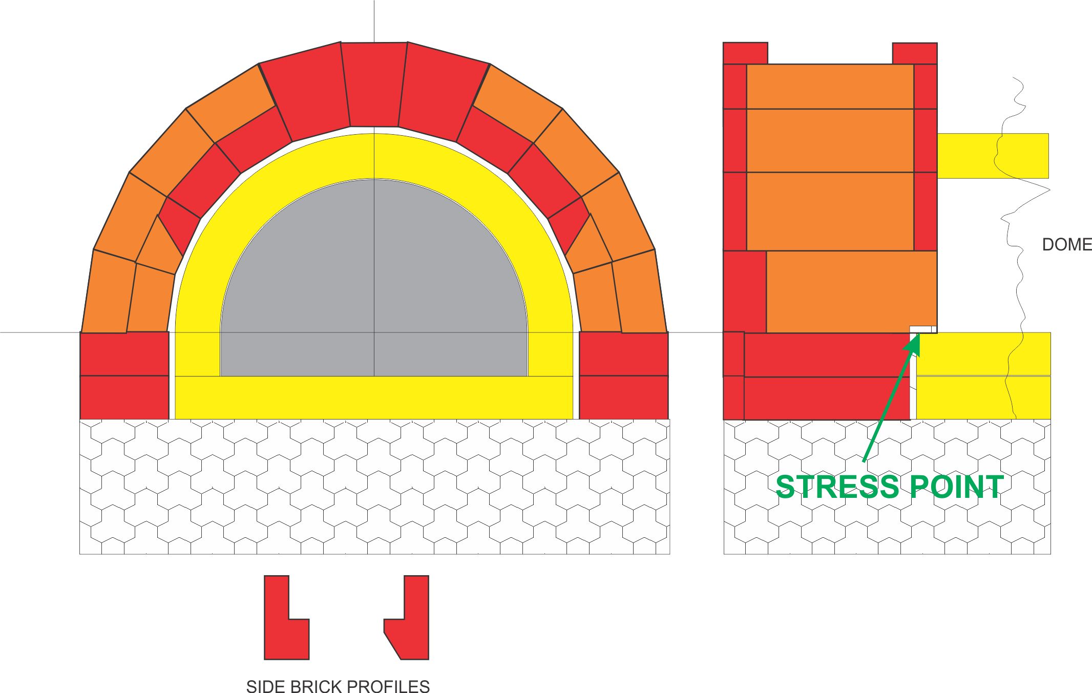

      #47
      Re: 38" build in Slovenia
      I changed my design on bottom parts of the arch to minimize stress in area marked with green arrow. I turned full bricks vertical to maximize strength after cutting clearance slots.
      Here is my revised plan.
Name:	zunanji vhod2.jpg
      Gorazd

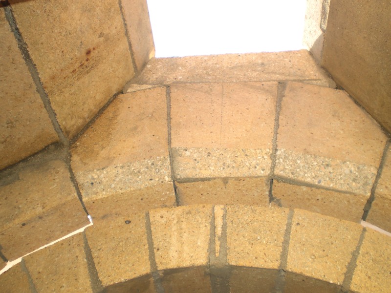

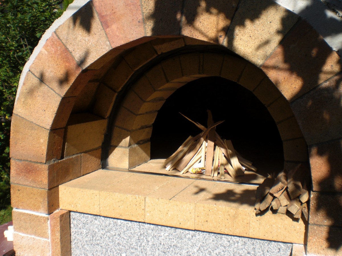

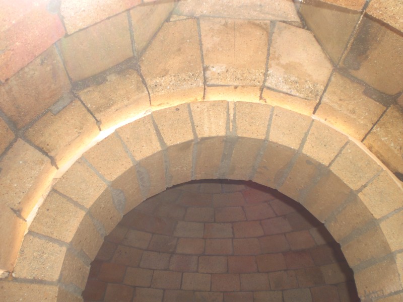

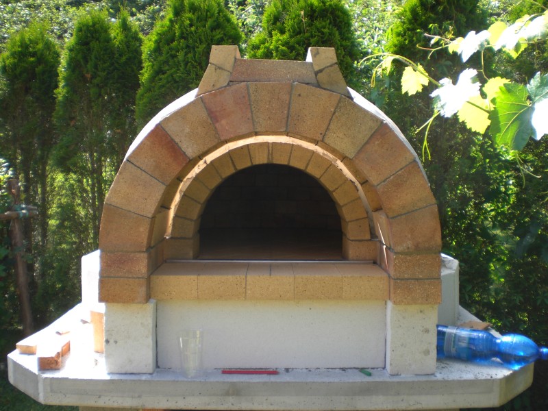

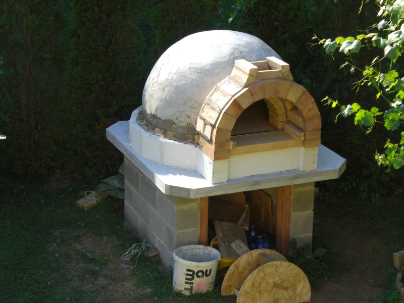

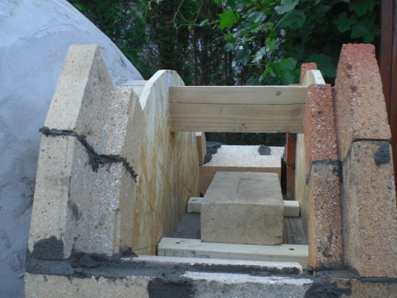

        #48
        Front arch
        Yesterday I started building front arch.
ID:	305048Click image for larger version
        Midday it was to hot for my mortar (it went in 4 minutes) so I was a bit behind on my schedule.
        Today I finished it.

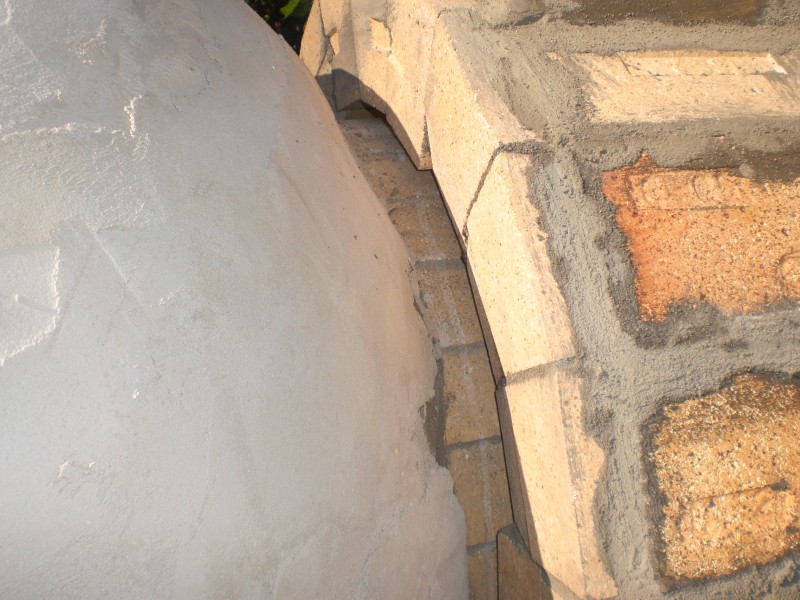

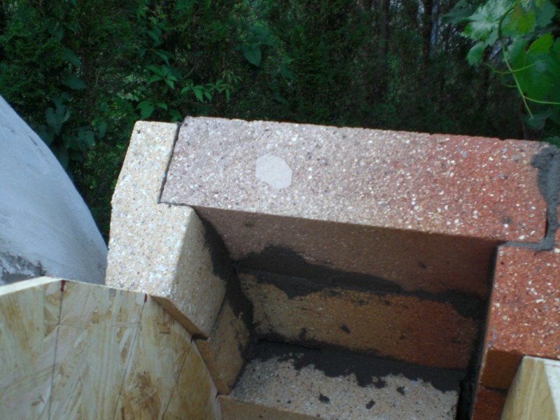

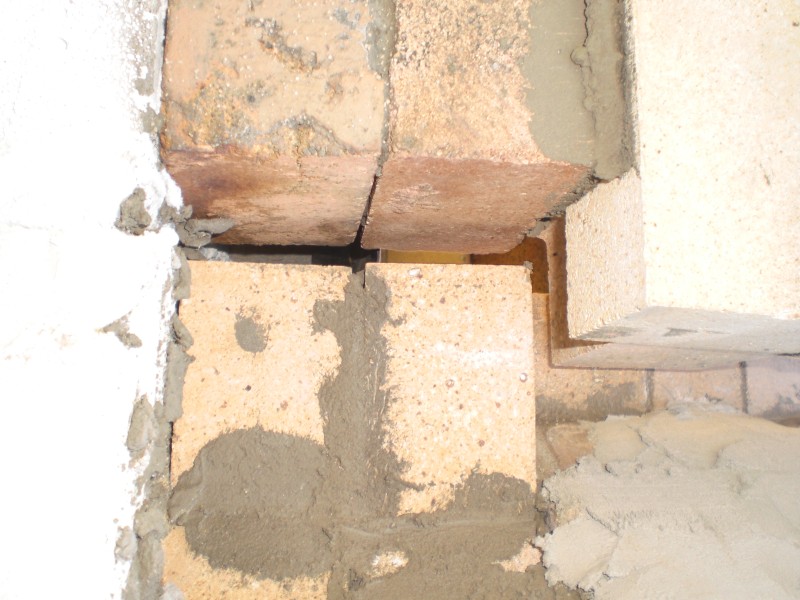

          #49
          Thermal break
          Here are some detailed pictures of thermal break.
ID:	305053Click image for larger version
ID:	305054Click image for larger version
ID:	305055Click image for larger version
          What should I put beneath the stainless U bar on the floor break?
          a) nothing
          b) vermiculit
          c) perlit
          d) leica balls
          e) something else
          Gorazd
            #50
            Great looking entry! It should draw real well. Again, it is an interesting design. I am looking forward to hear how it performs. After packing the heatbreak, and giving it some support with the vcrete and reinforced stucco, the entry should serve you well. I am guessing, that you will be making the reveal for your weather door out of vcrete and stucco?

              #51
              Thanks Gulf. I removed forms after only 20 hours of drying and it was ok. Over that I will render with perlite stucco with added reinforcement fibers (commercial product) 1" thick followed by acrilic/silicate stucco or gress tiles, haven't decided yet.
              I will be packing heatbreaks with ceramic rope and hi-temp caulking, but I do not know what to put under floor heatbreak?
              Weather door will be inset into entry so no extra reveal. I will do that in autumn months before first snow.
              Weather forecast is 3 days of rain after that I will start curing the oven.

                #52
                I've never worked with the stucco with the fibers. I have heard some good recommedations for it from this site. I'm an antique so I used the mesh. Are you still applying the stucco over 2" of vermicrete?
                I did not use the ss channel for a heatbreak. I just separated the oven floor brick from the entry brick with ceramic fiber tape. Maybe someone who used the ss steel will answer that for you .

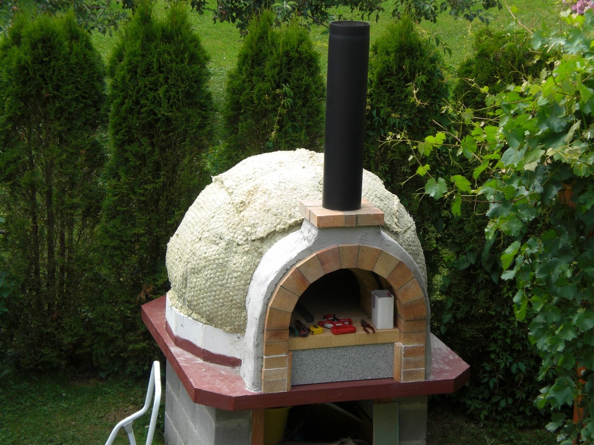

                  #53

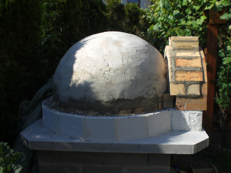

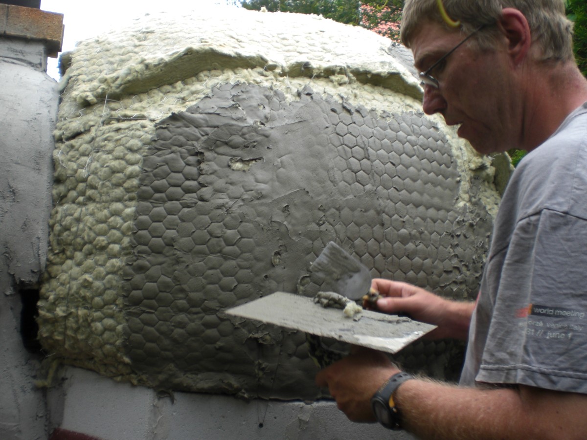

                  Dome insulation
                  After curing the oven with light bulb and gas burner I covered the dome with insulation. I used two layers of 4cm (1.6") rockwool over the entire dome with extra 4cm layer over the top. In the pictures you can probably see that I also covered front entry with fiber reinforced perlite.
                  I then covered the rockwool with thin layer of ceramic tile glue. I did this because I would like to minimize water from vermicrite layer seeping into rockwool. I did not see anyone elso do that but I thought it made sense.
                  Here are some pictures:
ID:	305205Click image for larger version
                  Gorazd

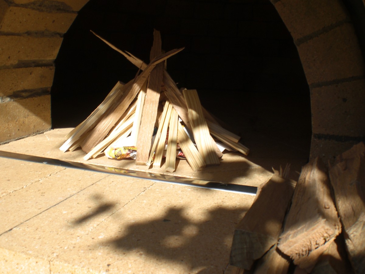

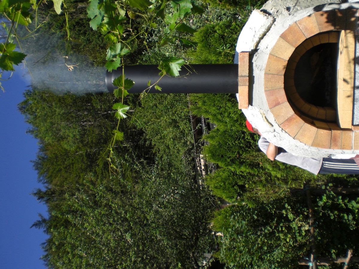

                    #54

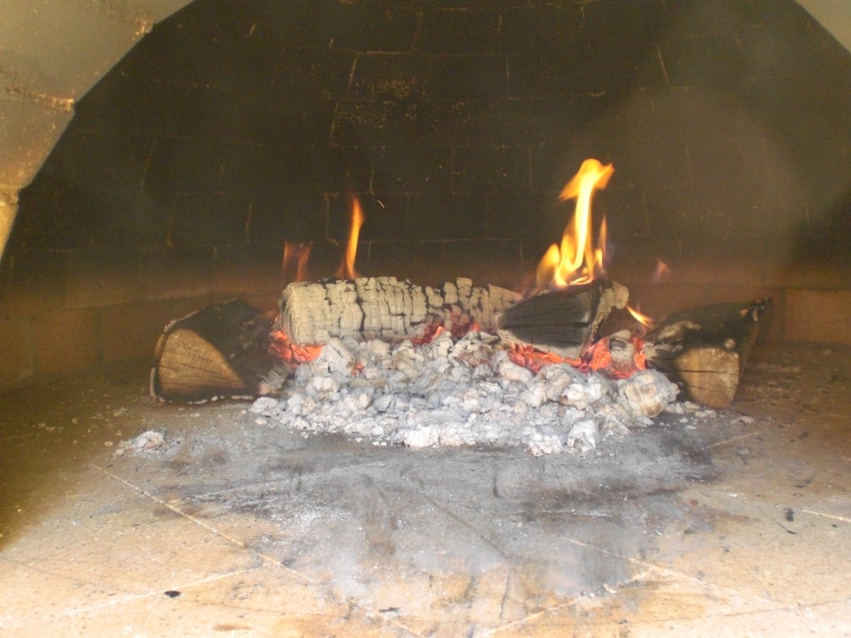

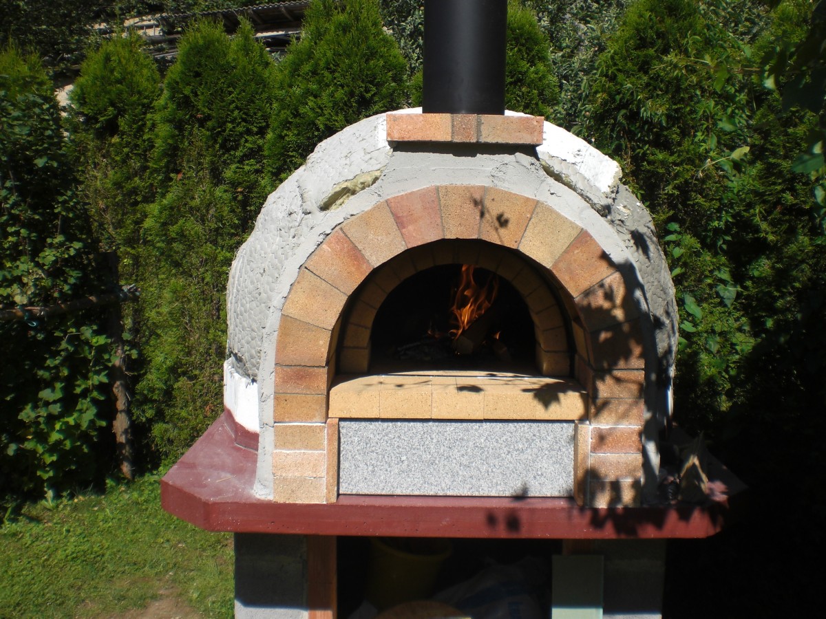

                    First fire
                    After the insulation was on it was time for first fire.
                    I tried to keep flames low. Top of the dome peaked at 310C/590F and the floor at 220C/428F but that was for only short period of time. After about three hours I let the flame go out. With only embers the temps went down to 250C/482F on top and 190C/374f on the floor.
                    Flue was drawing well when the flames were high but there was some smoke when the flames were low. Flue temp was at max 90C/194F.
ID:	305207Click image for larger version
ID:	305208Click image for larger version
ID:	305210Click image for larger version
ID:	305211Click image for larger version
                    Gorazd

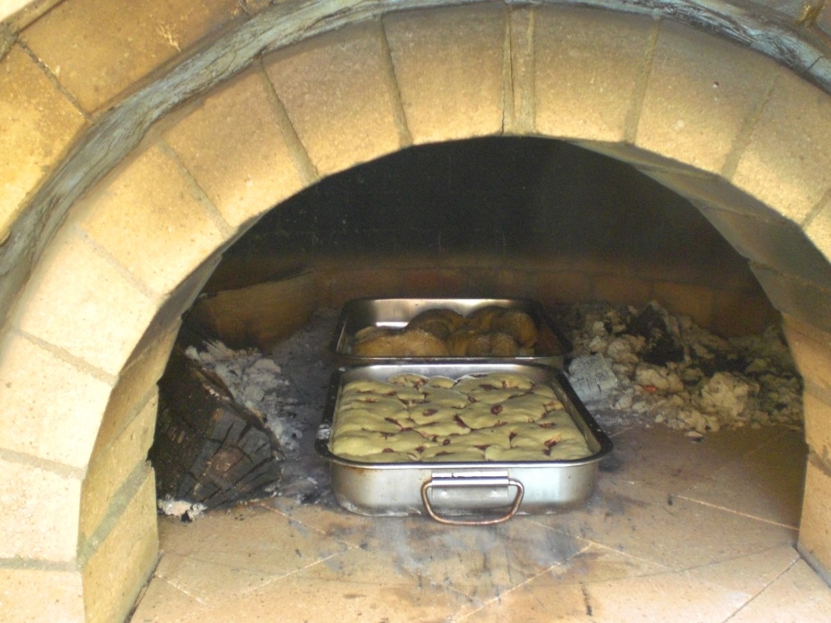

                      #55
                      First goodies
                      With only embers left I tried some cooking/baking. I planned to bake cherry pie but I got hungry so I threw in also some chicken and potatoes. Embers cooled down so I was a bit sceptical but after an hour and 15 minutes I got the best chicken I ever tested. The pie was also very good even on top and bottom.
                      Whoau I got hungry again must go and east some more pie.

                        #56
                        Re: Dome insulation
                        Something that has been recommended many times is using ceramic rigidizer or a Portland/acrylic slurry over insulation for just that purpose. Hope it worked out for you.
