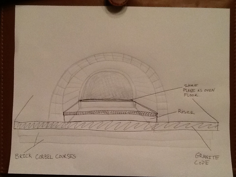

    Quick question...if a lot of water somehow gets under your granite vent landing, where is is draining too? You have weeps in the brick?

      Ok so now I get your thought. Would you use the ceramic insulation as a thermal break just behind the riser? You mentioned in an earlier post about capping this off with some homebrew or was it something else? The reason as you know, with the water drainage slots is to get it out along with the pitched pan. Something totally solid will make it for water to drain. The drawback is a subsurface that has voids. With that in mind, a dropped log or tool could cause damage to the granite. The slots would need to be narrow. Thinking of maybe cotton rope wicks but these have been proven to be not effective over time. Maybe they could be installed longer and your mix put in place. Then pull them out after everything is hard. I believe we have a plan, thanks S.C.
      Ok. Thermal break goes between the oven hearth and the vent landing. I used ceramic rope to fill the break, then made a slurry of Portland/acryl 60 as a rigidizer, so no fiber contaminates the cooking surfaces.
      You work in commercial masonry right? Grab a scrap of drainage mat or mortar net before put down your setting bed. Then you have a drainage plane and a fully bedded granite landing when your done.
      Here's a crappy sketch of what I was talking about with the riser......

          John thanks for the compliments. I am sure my wife and I will have a great time feeding everyone!!!!! Stonecutter, there are weeps in the brick allowing tne water to pass all the way to the bottom of the precast base panels. Nice sketch, just one thing, the granite slab will be flush all the way out to to the outside edge. In other words all on the same plane from oven entrance to outside edge that hangs over front of brick by 1". So I would not need the 2 3/4 ".Wayne

              Ahhh...ok. I should have asked if you were going to do that instead of launching into all that. So what are you doing under the vent landing...brick channels?

                Stonecutter, that was my thought, would you do it different with the brick channels? Thinking I need a sub base that will not suck up moisture and provide support for the granite. Plus have water raceways to drain.

                  I don't think I would do the brick channels, mainly because outside of a torrential driving rain falling directly into the vent for hours, I don't see a lot of water getting under the granite. Especially so if your joints are tight and full. With a solid stone for your floor, there is minimal chances for penetration, not like a brick vent landing with many joints..
                  It's a preference thing for me...to set stone into the solid setting bed. Besides, if your vent landing is a one piece stone ...( I'm assuming ) ....you (should) put a slight fall on it to encourage any driving rain to run away from the oven hearth.
                  All that said, if you want brick channels I don't see any big issues, as long as water drains freely. Sound like you have that covered.
