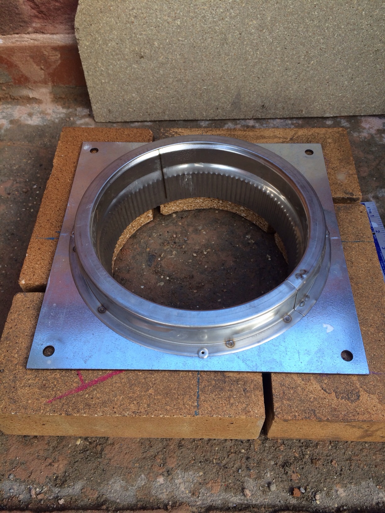

    I left about 1/4 - 3/8" gap to the outside of my double wall SS chimney but I did end up putting mortar in the gap. No issue with expansion due to double wall pipe but could be different with single wall. BTW nice chimney/vent transition.
    • Re: 7 years in the waiting i get to start my 42" pompeii
      Thanks Russell I made the cut it was the size around the bottom part if the plate I left a small gap anyway here's the pic Click image for larger version

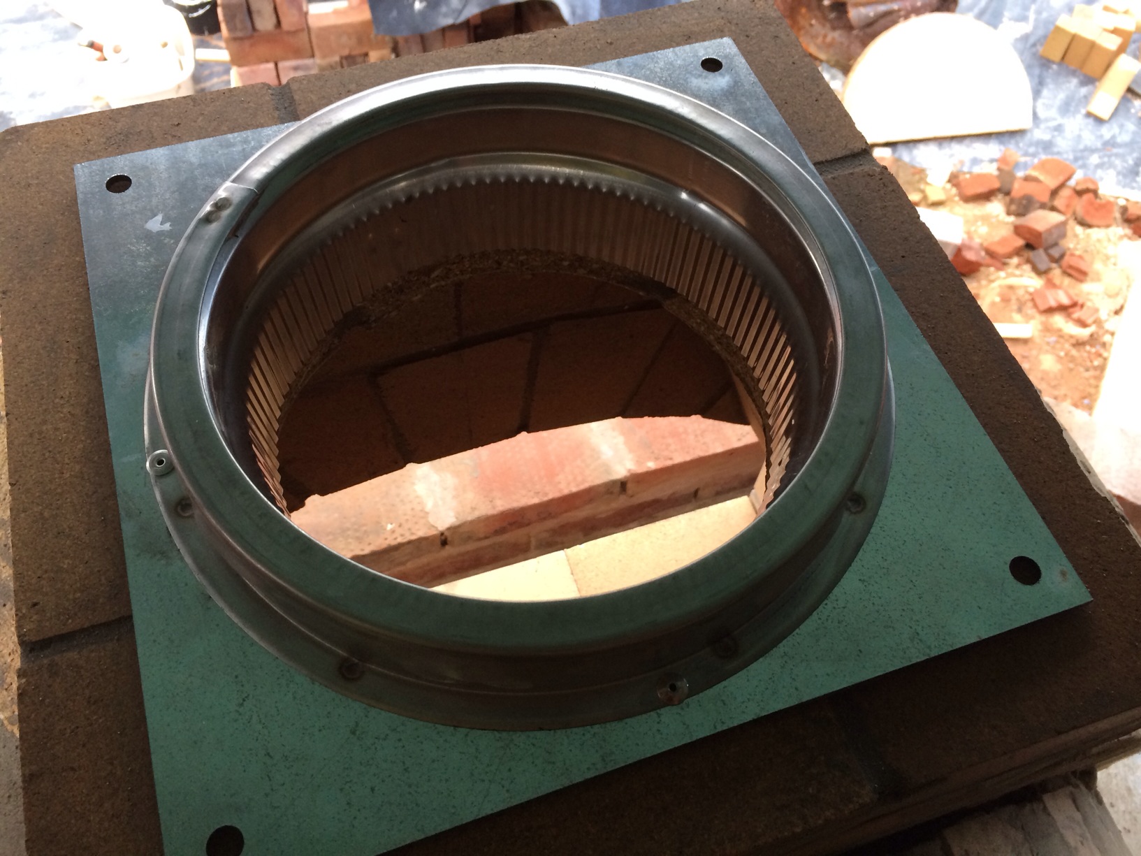

          i got everything mortared together just ran out of mix for the anchor plate so il just use the high temp seal i used on the heat break to set it tomorrow looks a little crazy from the outside but everything is tied in and hopefuly strong and none of this will be seen Click image for larger version

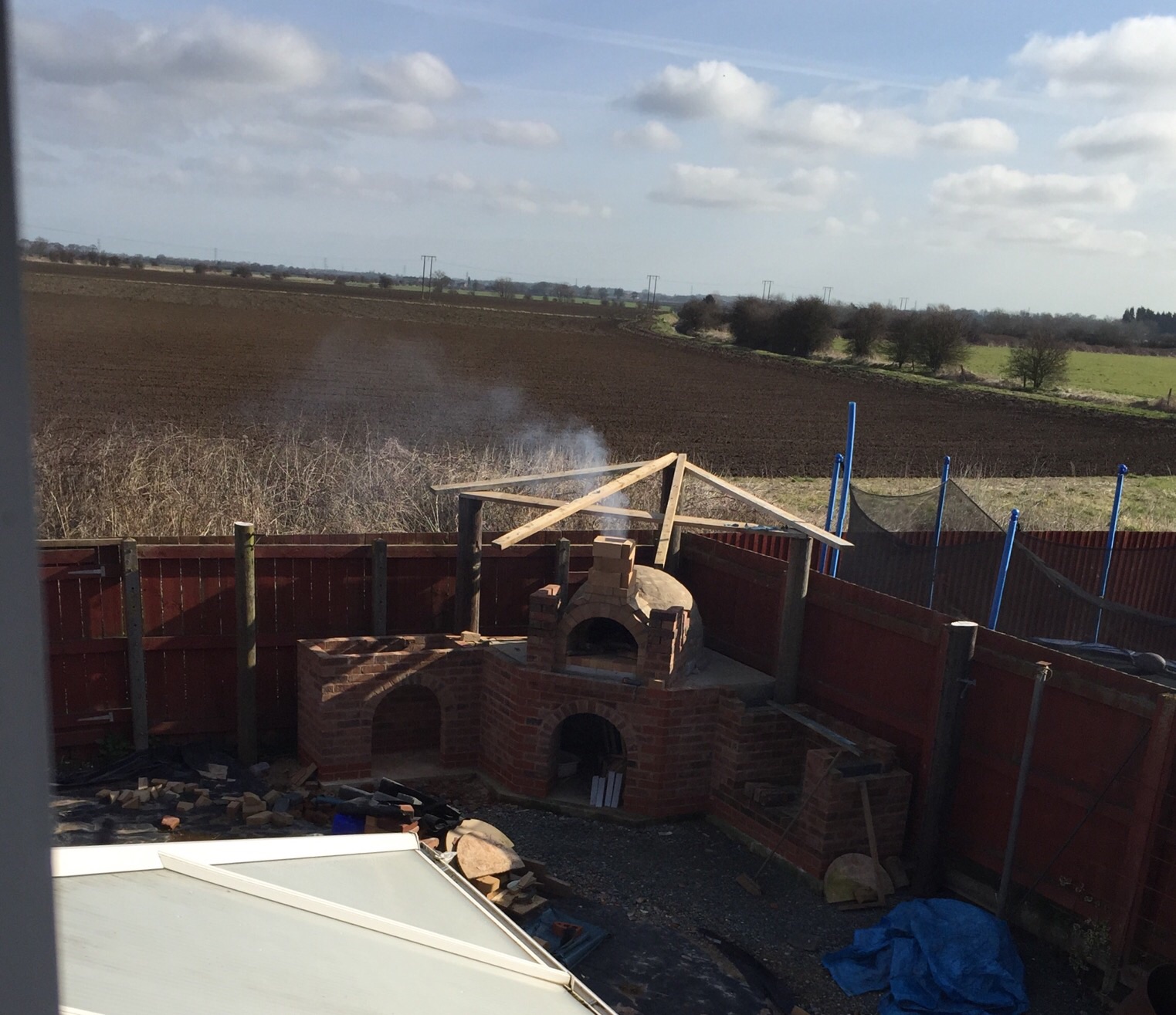

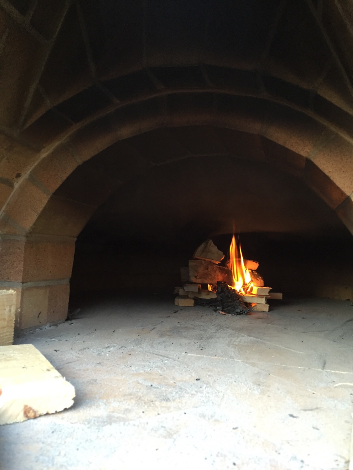

            Hi guys I've had a long spell away from the oven due to what life can throw at you and then the winter hit so I covered up the oven with tarps and yesterday finaly striped them off my temporary roof took a good hammering so I took that down too. So I thought while I have the chance I would start to do a few curing fires my mortar has now had months to do its own curing so do I still need to follow the curing regime from the plans? I took the fire to 300f today for an hour or so but something came up I had to go out and had to let it die. Also do I need to let the oven cool completely before the next raised temp fire? Really looking forward to getting going on the oven again it's been to long!
            This is the first time my oven has seen fire I think it liked it!

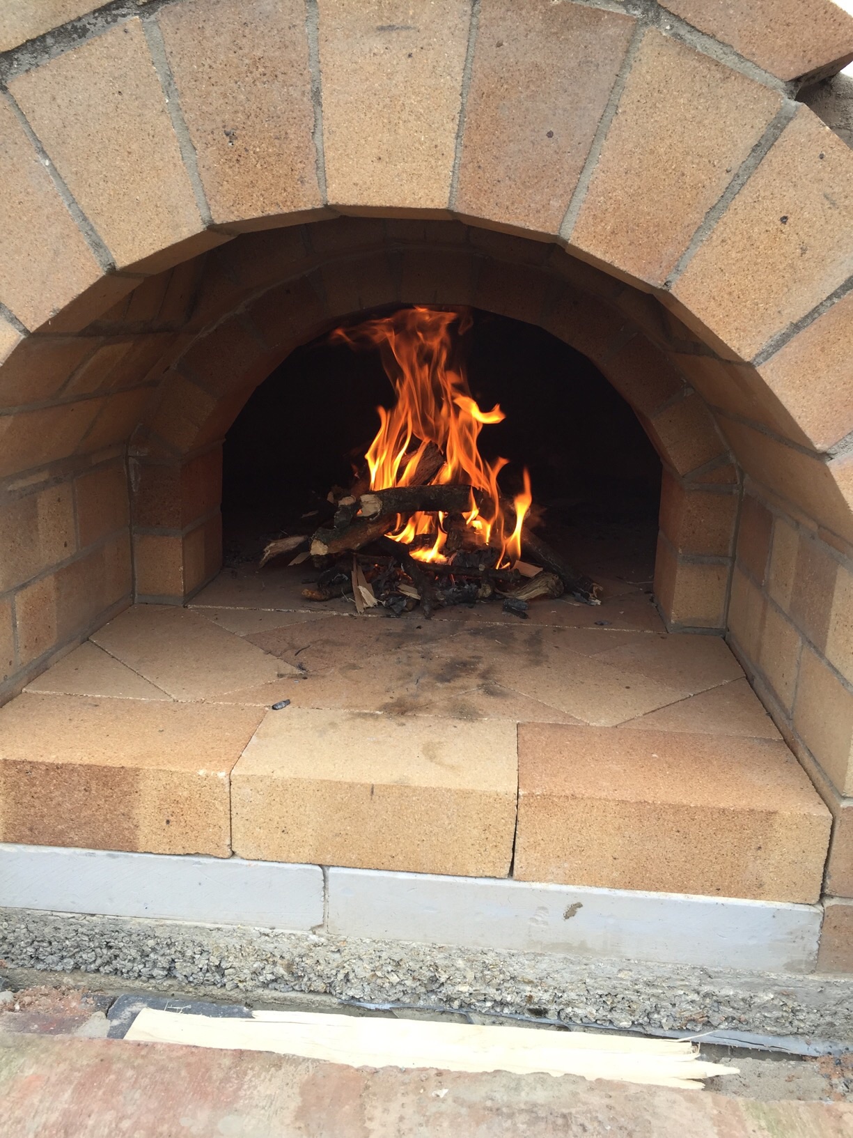

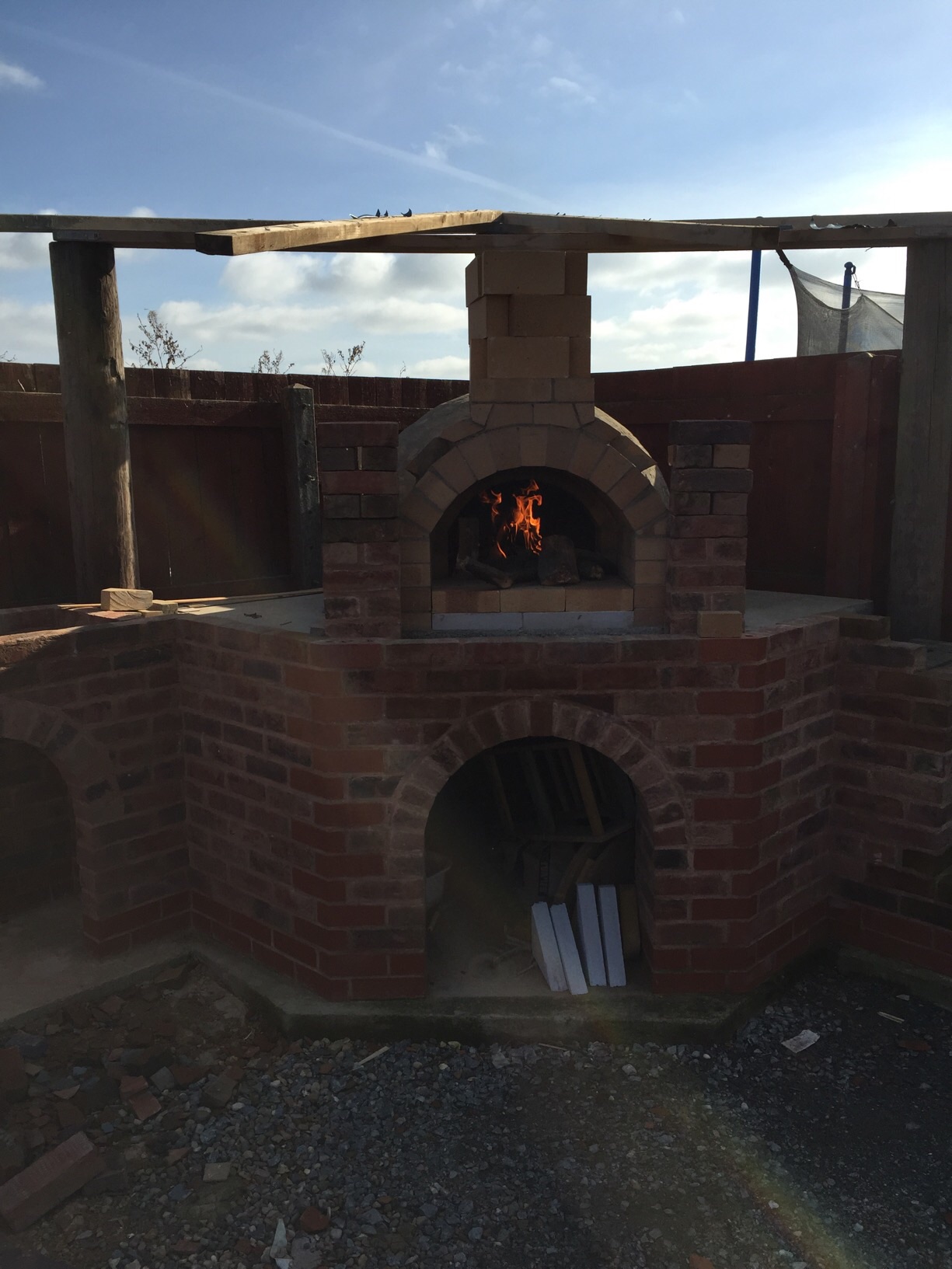

              I got another fire going this morning hopefully be able to keep this one going for 6 hours I dry stacked a few fire on the chimney to get a bit of a draw my chimney will be about 3 times higher when finished and theses few dry stacked ones are working a treat not much smoke out the front at all I used a mix off soft wood a little Apple wood I've been drying and some chucks of oak which have just perfumed my garden beautifully and me! Click image for larger version

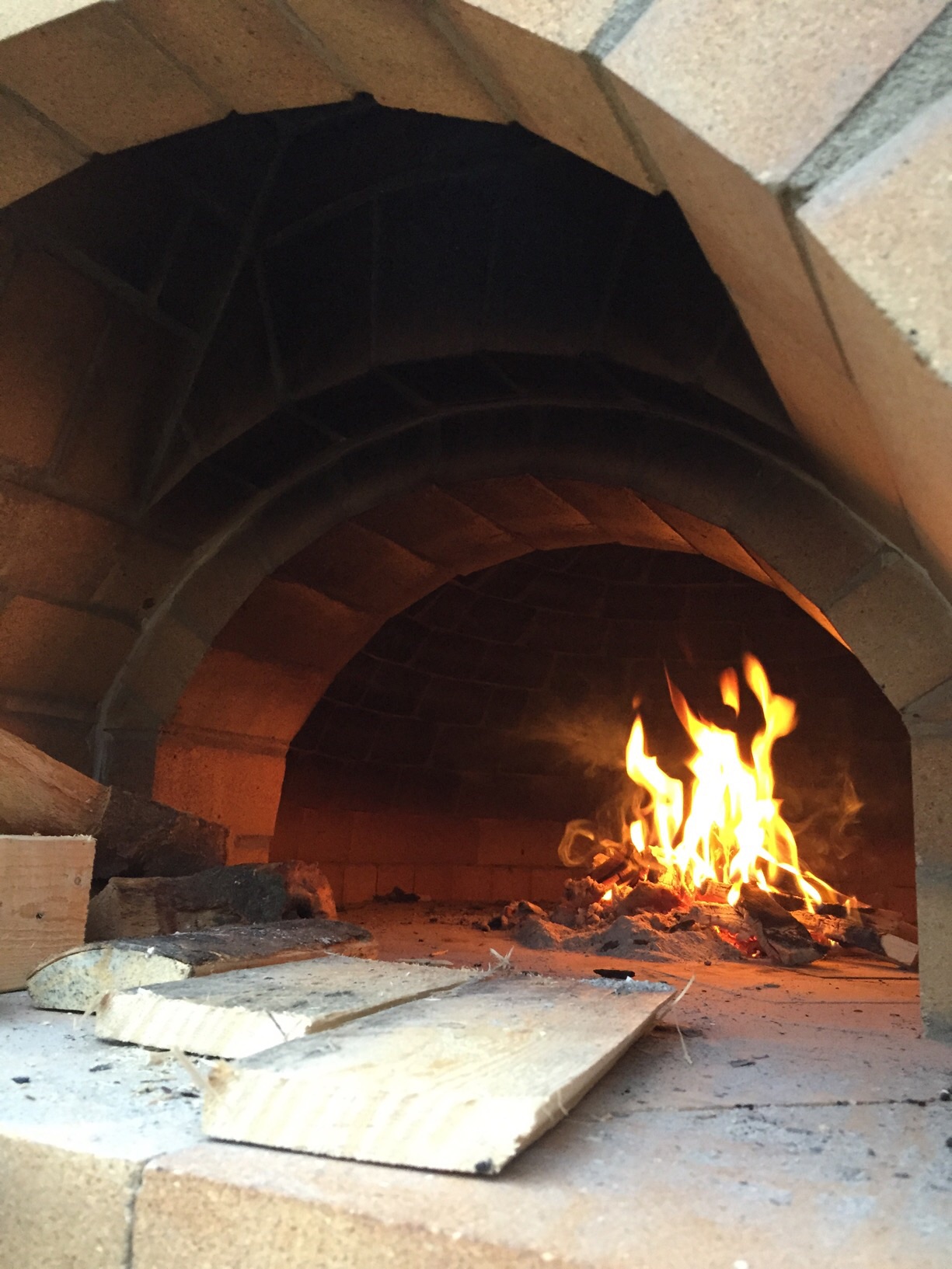

                Bellowing like a good 'n' Click image for larger version

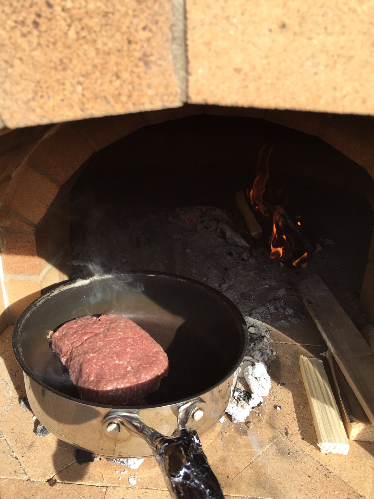

                      Make shit door made left to cook for 2 hours thermometer reading 368f when door on Click image for larger version
ID:	307748. Didn't get chance to photo the end product wolfed it down. I've made this dish same recipe for years and this was another level perfect smokey flavour even noticed by my 3 year old. I can see and distantly taste good things from this oven hopefully next fire tomorrow
