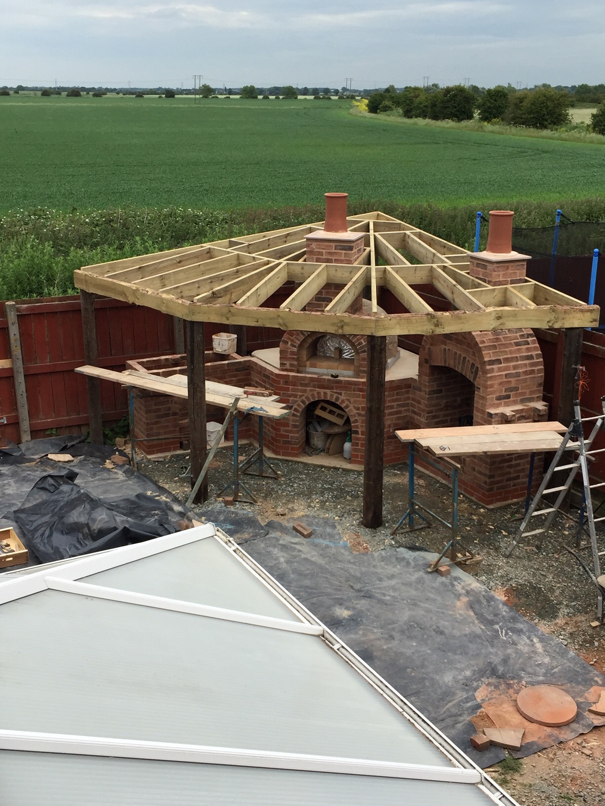

      thank you carl and steve. the roof took a few hours this morning as well as yesterday to finish the cuts going into the fascia beam took a long time to do the beam had to be notched out with a chisel. And the supports all had to be chopped in an L style angle type cut to lock into the beam the 2 pics hopefully show this

      all in all 213ft linear of timber has gone into this roof a lot of weight but its as solid as hell ive done the walk test and my joiner pal has done me proud
