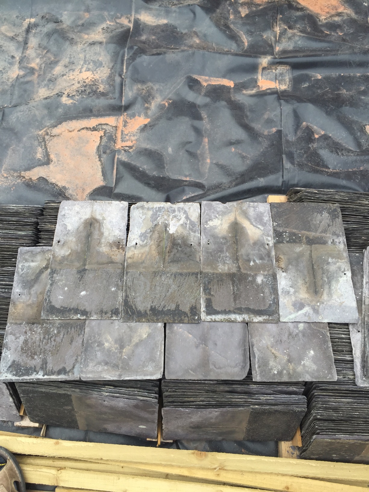

    back at the oven this weekend after some time away due to family parties I managed to get the chimney on the bbq/fireplace done the last 2 post for the roof set in and today the oven chimney brickwork up il put the twin wall in at a latter date I need to get it ordered
ID:	308408 I also managed to bag my roof tiles from ebay more than enough to do the job plus a wet polisher for the counters when I get there!

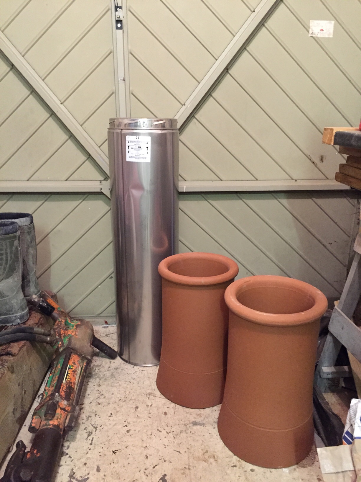

                I went down to the merchants to check them out I needed to get a length of 900mm and is was way to heavy plus like you say Carl they need insulation so more weight. so I got a twin wall ordered and my 2 chimney pots I also got 2 of the pavers im going to use on the patio and round the oven to use as a start for a crown for the chimneys also some impregnator that is food safe so I can use it on everything counters the pavers and the concrete that will finish the chimney crowns I got 5 packs of the stuff so I should have plenty its called meta cr?me this stuff is meant to be the best on the market ive used it once on a slate paving job and it was fantastic ?60 a pack so it bloody should be. I got the holes cut out in the pavers ready for laying tomorrow weather all been good for the paver that is going on the oven chimney I cut a line all the way round the outside of the paver for a water drip. the over paver for the fireplace wil get the same treatment but I need to trim it down first and I used the anchor plate to draw around giving half inch gap around the twin wall that should just pop through the paver. then just entering the bottom of the chimney pot (it just fits with clearance) that will be mortared to the top of the paver.

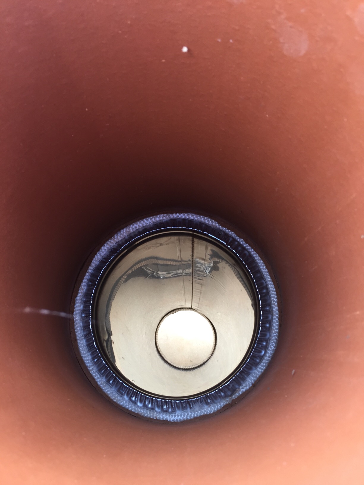

                    I locked my twin wall to the anchor plate and used this sealant I used for the heat break to set it in place Click image for larger version
ID:	308572 I then cut2 collars from the blanket and pushed them down around the twin wall to insulate to anchor plate and the firebrick you can just see it here Click image for larger version

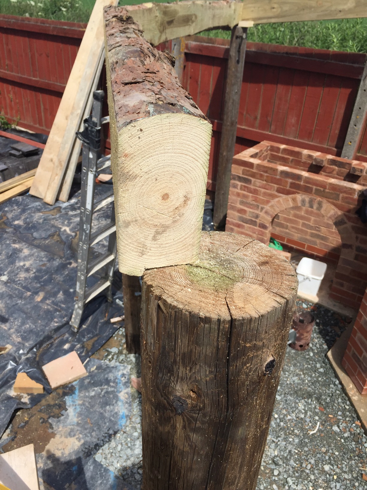

                              hi guys Ive got myself a week off this week to crack on with the roof ,made some good progress today with the help of a joiner friend Im using treated 9x2 for all the inside frame work and some sleepers that still have the bark on top and bottom with a rough cut face for the front 3 fascias they measure around 9x4 to hopefully blend in with the posts and give an old style look. we notched the bottoms out so they sit in to the post and mitre cut them to give a better look from the front here are the pics from the day still a lot more supports to put in as yet
