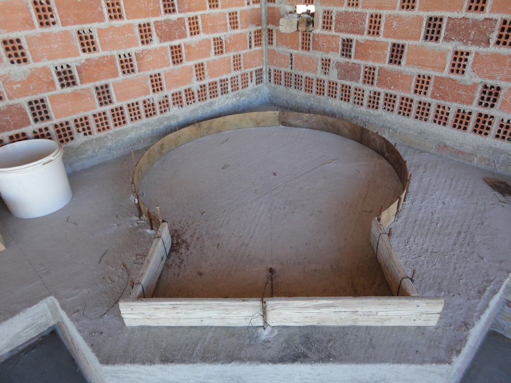

    replied
    Just put a piece of card board (abt 1/8" thick) around the floor and between the first course of the dome and leave in. This does two things, first gives you an expansion gap spacer, and second, it keep errant mortar from falling down and filling you expansion gap. The cardboard will burn out during your firings and the gap will eventually fill with ash.

    I have a question about the expansion gap.
    I will make the floor inside the dome so the bricks will go around of the floor.
    Between floor and bricks how much must be the epxansion gap?
    Leave a comment:

    replied
    You should be good to start work,but if possible, leave the forms on to protect the edges of the p-Crete while you construct the dome

    Guys,
    How many days need to wait until the perclrete will dry?
    Here the temperature is 30-40 oC.
    As you can see in the photos,from the first day until today which is the sixth day.
    Leave a comment:
