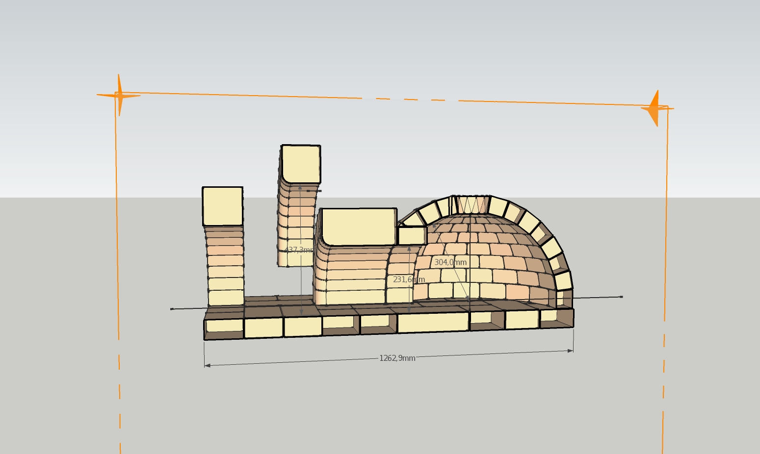

    Why do you use bricks without trimming. The figure is one of the bricks for Pompeii oven which I designed for my friend. Joint thickness of not more than 3mm.

      Short answer, because I was convinced in previous posts in this thread that it would be a waste of time. I do like the look of it though...
