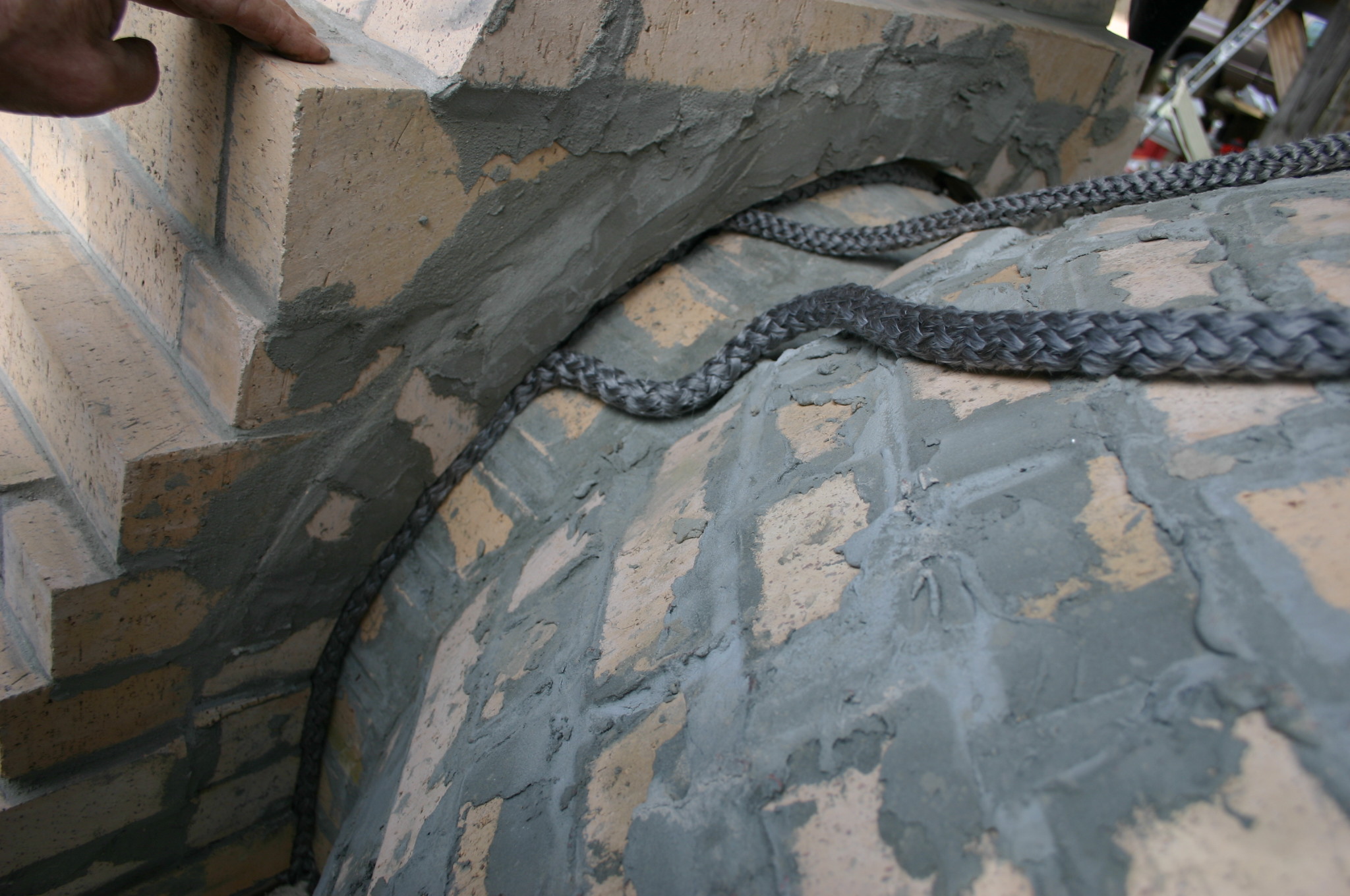

          Where you show the Vermicrete Thermal Break in your drawing I cut the outer arch bricks into a "L" shape and filled the gap with Wood stove door gasket. A fiberglass rope.
          So far it seems to be working.

                Like Gulf said. And............if you use it rather than CF rope or fibreglass rope.
                Something that restrains the vcrete is necessary. It will deteriorate over time and if it is suspended then there is only one way it will go.
                The use of a thin stainless barrier to contain it will not make a significant difference to the performance of the oven or the ability of it to retain heat. The thinner the metal barrier the less impact it will have on heat bleeding. I have been using mine for a couple of years and the stainless is still shiny and the vcrete is still where it belongs.

                  You only need a 1/4-1/2" gap for a heat break. As Greenman suggests, you can fill with CF rope. I also used a high-temp caulk. But you could just cap the break with vermicrete. The hot gas will take the easiest way out of the oven so as long as your flue is drawing it won't be a problem.
