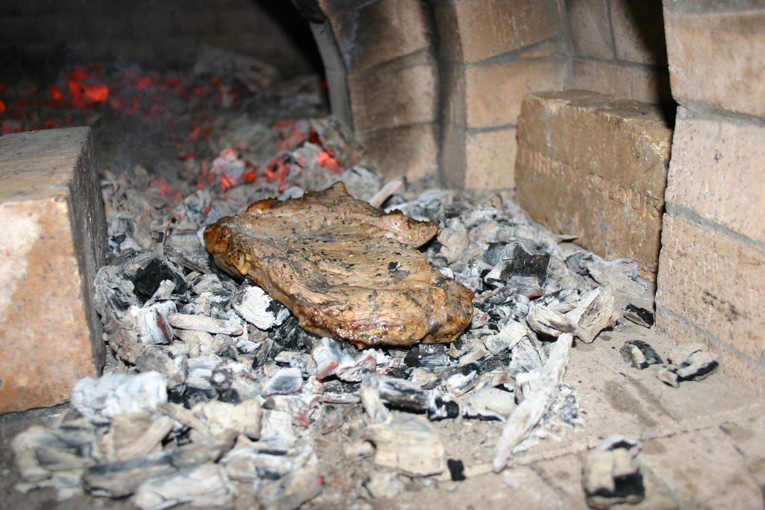

    I love the tuscan grill. It helps make these ovens much more versatile. When the wife ain't around, or at least ain't lookin', I go caveman, aka dirty steak .
Name:	dirty steak 014.JPG
ID:	384637 The flash on the camera doesn't do the cook justice. Click image for larger version
Name:	Dirty Steak2 028.JPG
