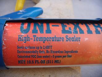

                      I used Uni-Extreme made by McGill Airseal it is good to 2400 F and environmentally friendly. I is NOT silicon based and sets up firm. Used it to seal in my CF rope on my arch heat break. Click image for larger version

                        #176
                        Russell, did you buy the Uni-Extreme online? I found an online source for the stuff RandyJ used, but could not find a source for your produce. Plenty of info from the McGill website but did not see any pricing.
                          • 5263
                          #177
                          JR,
                          I found it at a surplus store that I frequent every week. I bought all they had for a buck a tube and sold the extra to other members on the forum for cost plus shipping. Unfortunately I sold them all. So short answer, you may have to call them and see how much. There is a another modeable caulk called kawool cf caulk that is good to 2000 f. I have not used it personally but others have. I think it is about $20 a tube.

                            Wow, a dollar a tube was quite the score. I was able to search, now that I have the brand names (thanks to all) and found both Kawool and Inswool moldable for about $15 a tube. I also found some for $42.73, do I guess it pays to shop around
