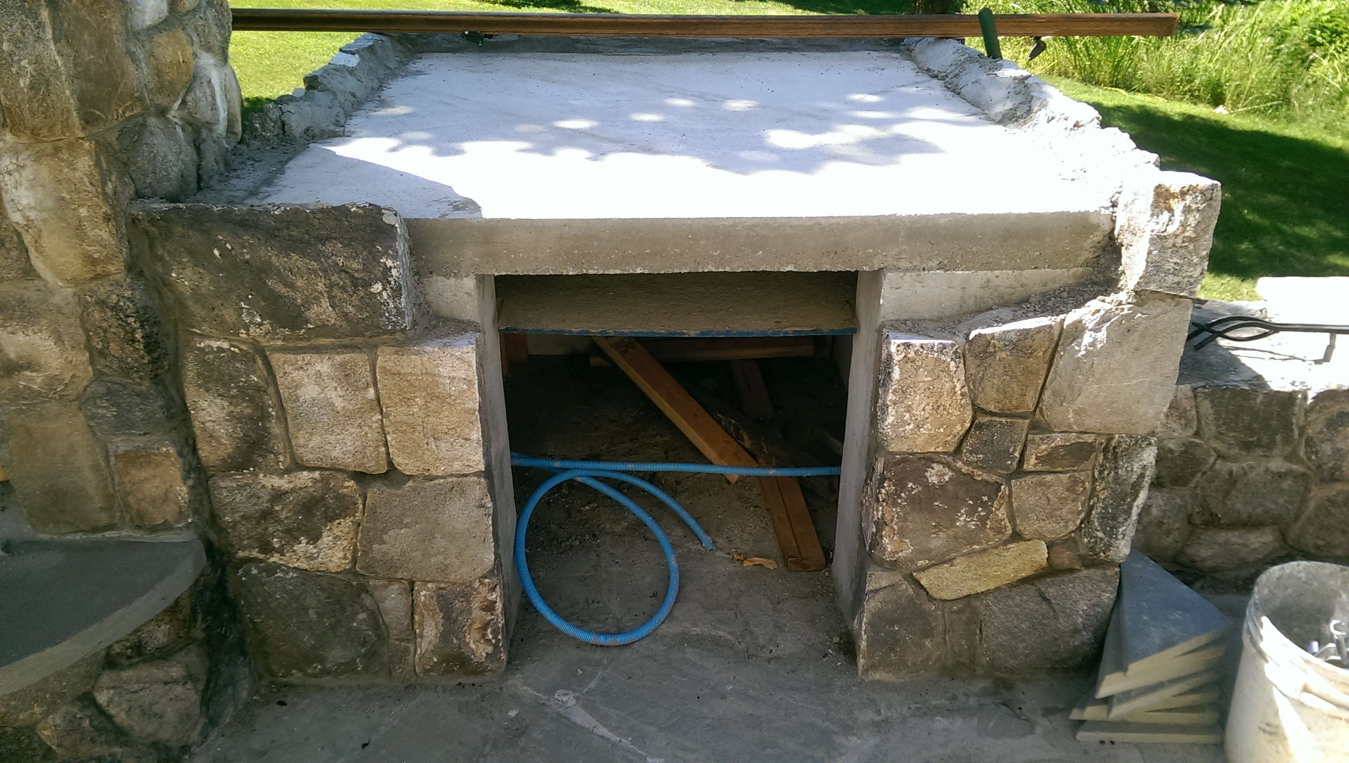

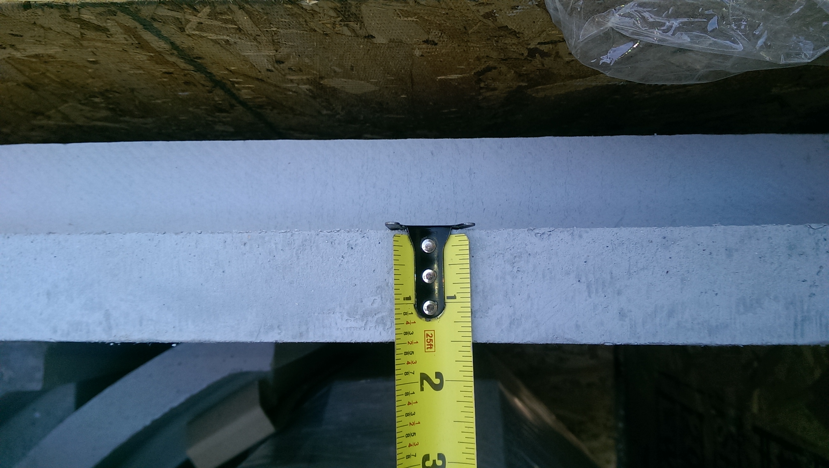

                • Looks great. Congrats. I have a question for you guys I have a 4" slab. I have 1.5" of insulation board. Should I go thicker? I see people using anywhere from 1"-4". Another question the slab isn't perfect. I noticed a corner of the board rocks. What should I use to level it?
                  • Originally posted by Pologuy9906 View Post
                    I would go with at least 3 inches of insulation. It's really worth it, and you can never add it later. You could use a little mortar or self leveling concrete to build up the area where it's not level. I wouldn't use sand for this purpose, it may wash away over time.
                    What kind of housing are you planning? I notice the stone extends up around your slab. If you're planning an igloo, make sure you don't set yourself up to catch water on your slab. It's hard to keep it out of the bottom of your oven.
                    My build progress
                    My WFO Journal on Facebook
                    • I was planning on making a bluestone cap with a slight anglefor water to shed off. I was thinking4.5" of calsil board. Then pour a Verm/crete 5:1 and fill the void. Bluestone would sit on top of that right up against the outer wall of the oven. I want to cover the oven with stone. Should I cut this out making the slab level with the edge? Build around the oven with blocks and create the same bluestone shelving? I could only imagine the best practice to keep water from pooling at the base?
                      • I used insulating brick (2 1/2" x 4 1/2" x 9" standard brick size) below my 2" of ceramic insulating board. It doesn't become mushy if it gets wet and keeps the insulating board off the ground. So far I've been very pleased on how that has turned out. You can use mortar or self leveling as deejay mentioned. You can also use a grinder if its some small high spots you're trying to address (I had a small high spot I just grinded down).
