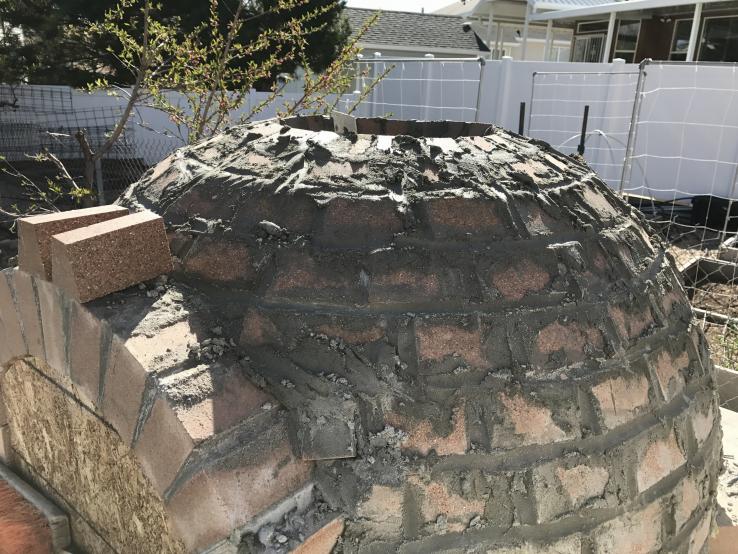

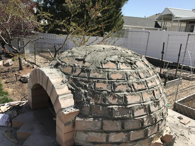

    • #17

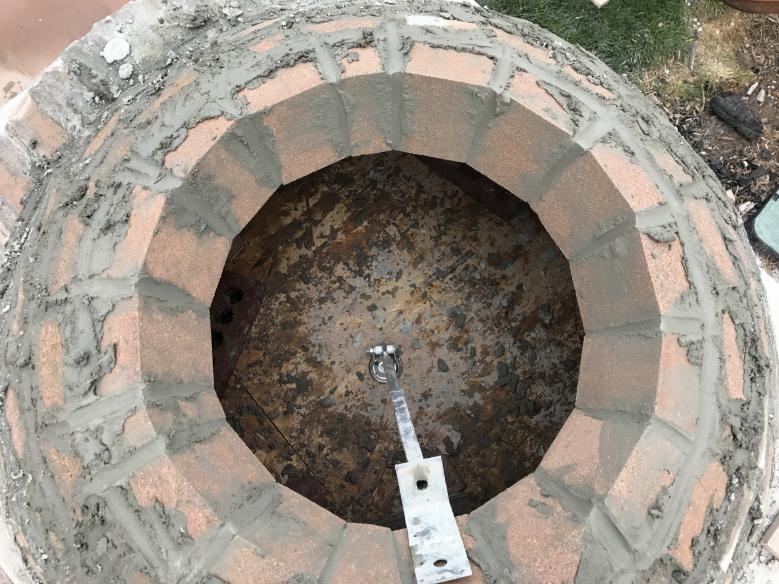

      Closing in. Closing in. Gravity, Click image for larger version
ID:	397084Click image for larger version
ID:	397085Click image for larger version
ID:	397086 You will not win!

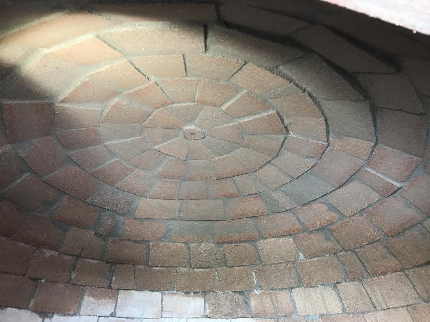

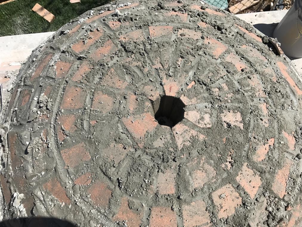

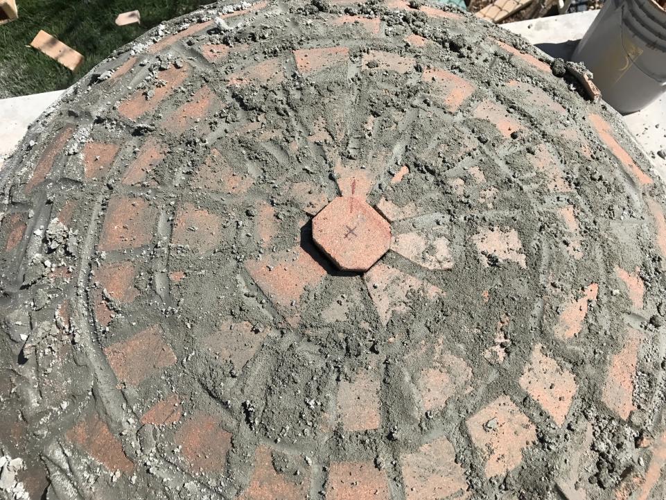

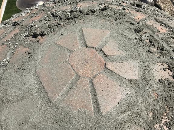

      • #18
ID:	397102Click image for larger version
ID:	397103 Finished courses 10,11,12,and keystone plug today Click image for larger version  Name:	IMG_4703.JPG Views:	1 Size:	309.2 KB ID:	397092Click image for larger version  Name:	IMG_4704.JPG Views:	1 Size:	96.4 KB ID:	397093Click image for larger version  Name:	IMG_4710.JPG Views:	1 Size:	102.1 KB ID:	397096Click image for larger version  Name:	IMG_4708.JPG Views:	1 Size:	78.0 KB ID:	397097

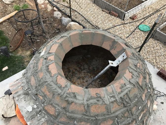

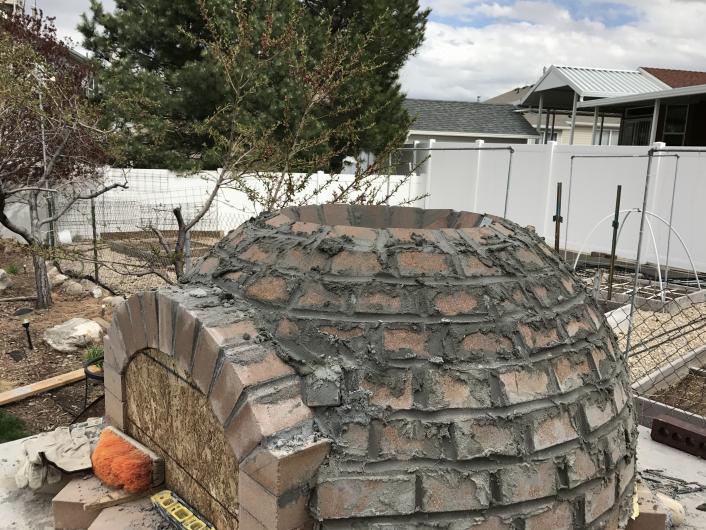

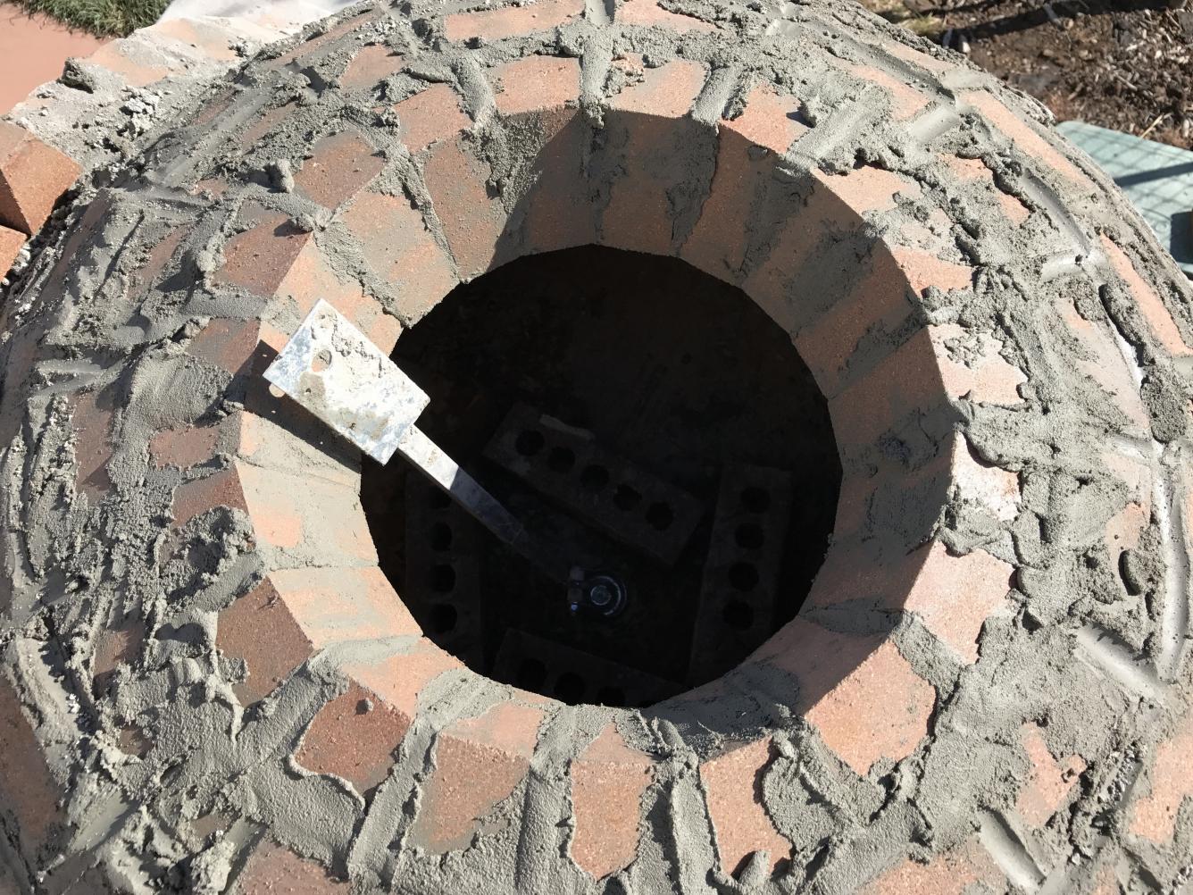

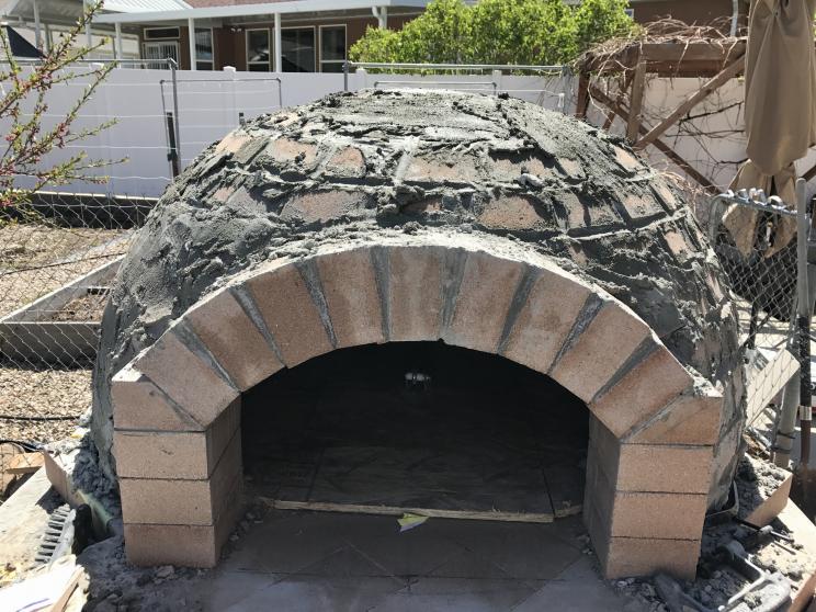

        • #19
          Click image for larger version  Name:	IMG_4713.JPG Views:	1 Size:	95.0 KB ID:	397099Click image for larger version  Name:	IMG_4715.JPG Views:	1 Size:	86.9 KB ID:	397100Click image for larger version  Name:	IMG_4714.JPG Views:	1 Size:	93.4 KB ID:	397101
          More pictures.
          If anyone is curious, I spent 35 hours just working on the floor and dome, and a total of 56 hours starting from the cinderblock portion.

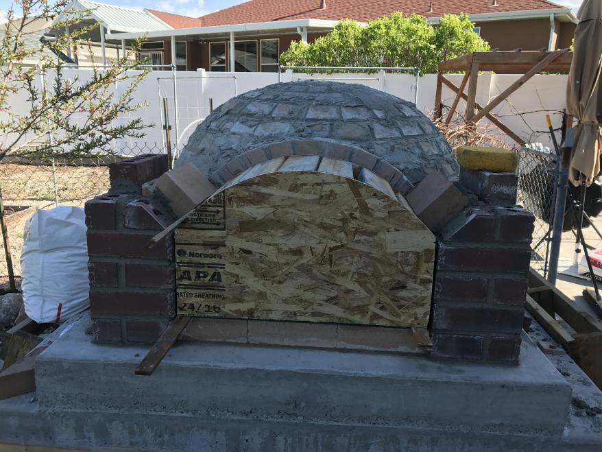

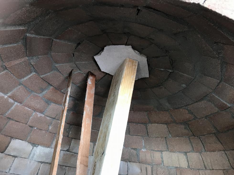

                              • #30
ID:	397263 This a couple days ago.
