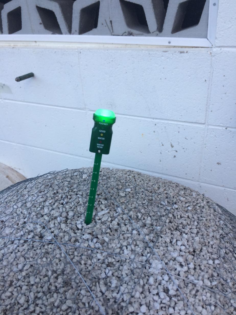

    When / how do you know when the oven is dry completely? When is it then safe to fire it for pizza?
    I cant see steam coming off of it because it is enclosed in a walled structure filled with loose perlite.

ID:	397696 If you've had plenty of extended fire in it and all the carbon has burnt off the entire dome on the inside then you're done. If you are concerned that there is still moisture in the perlite, try throwing some sheet plastic oven the oven during firing to see if moisture condenses on the underside. You can also get a cheap garden moisture meter and use it to tell you if the insulation layer is dry.

        I guess the only way for me to know if the oven is dry is when the carbon burns off. Since my oven is under a walled structure with a roof on it. I have no way to see it on the outside.

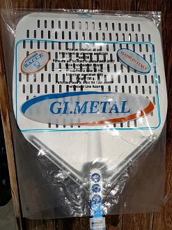

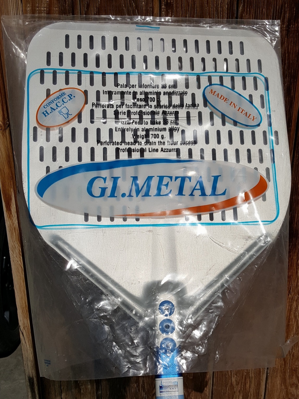

                  Hey Ron,
                  I have a brand new in the package GL Metal peel from Italy. PM me if you are interested, I can let it go for less than half of what it sells for on Amazon.
