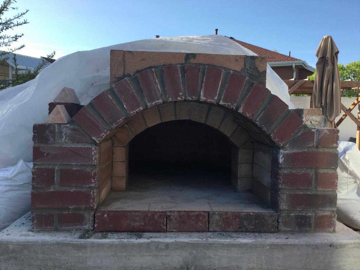

    I worked a couple hours doing the finished brick arch and some firebrick arch behind it. Ill figure out the rest tomorrow.
