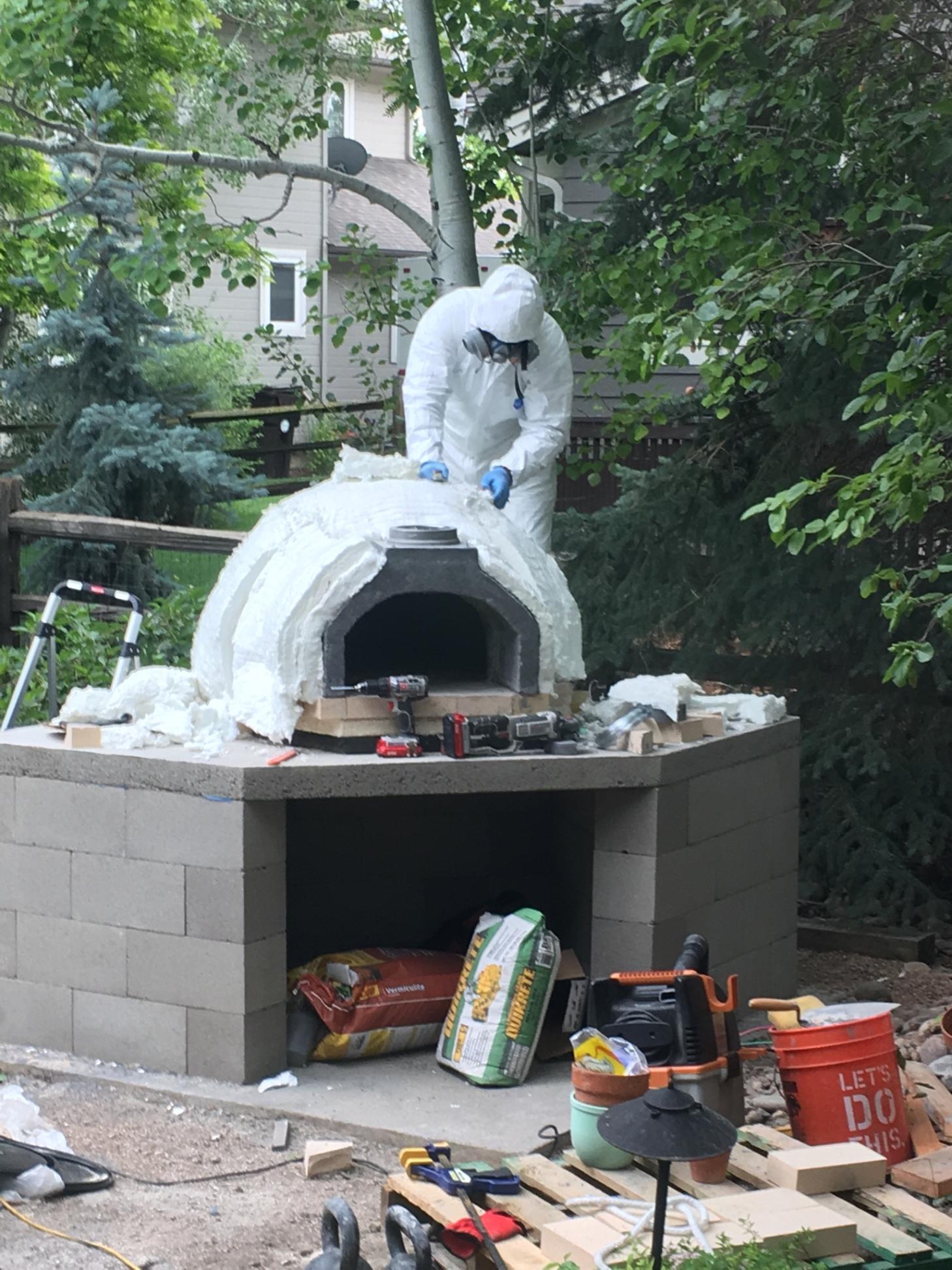

                I got in the bunny suit and did my insulation blanket today. Same brand as Russel had used , but mine was foiled on both sides. The foil came right off, so no problem there. It was 2" and I did three layers. The last one required I use some smaller pieces.
                Because I didn't cut the insulation board and firebrick floor exactly to the shape of the dome, it has a jagged bottom circumference. This keeps me from snugging the blanket up to the bottom.
                Because I'm building a enclosure, I will fill the bottom well with vermiculite. I hope that's a good plan.
                Do folks who build an enclosure ever render over the blanket? I'm tempted just to have that nasty stuff covered and sealed.

                  Render or not?
                  • fox
                    • Mar 2017
                    • 388
                    #99
                    I rendered mine but left a 4" hole in the very top to allow moister to exit when drying out the dome with small fires, I have plugged the hole now & painted over the whole thing.
                      • 5256
                      #100
                      Since you are enclosing and adding dry vermiculite, your labor resources might be better spent on other aspects of the oven. Your oven is really insulated well. FYI, you can drill some Tapcons into the hearth to fasten your wire to hold down the CF blanket.

                        I think that you need to think about how long until you will have this enclosed. Turns out squirrels, mice, & birds love to pick out fibers for their nests. As Russell noted, since you are enclosing and adding vermiculite there are other jobs that should have higher priorities...but that assumes you are going to get your enclosure built & filled & closed soon .
                        As for venting, I don't think you need to worry about it since your enclosure will probably have a built-in screened soffit or two and that will keep out the rodents and let any moisture escape. Looking good on having curing fires pretty soon (if you haven't already ).
