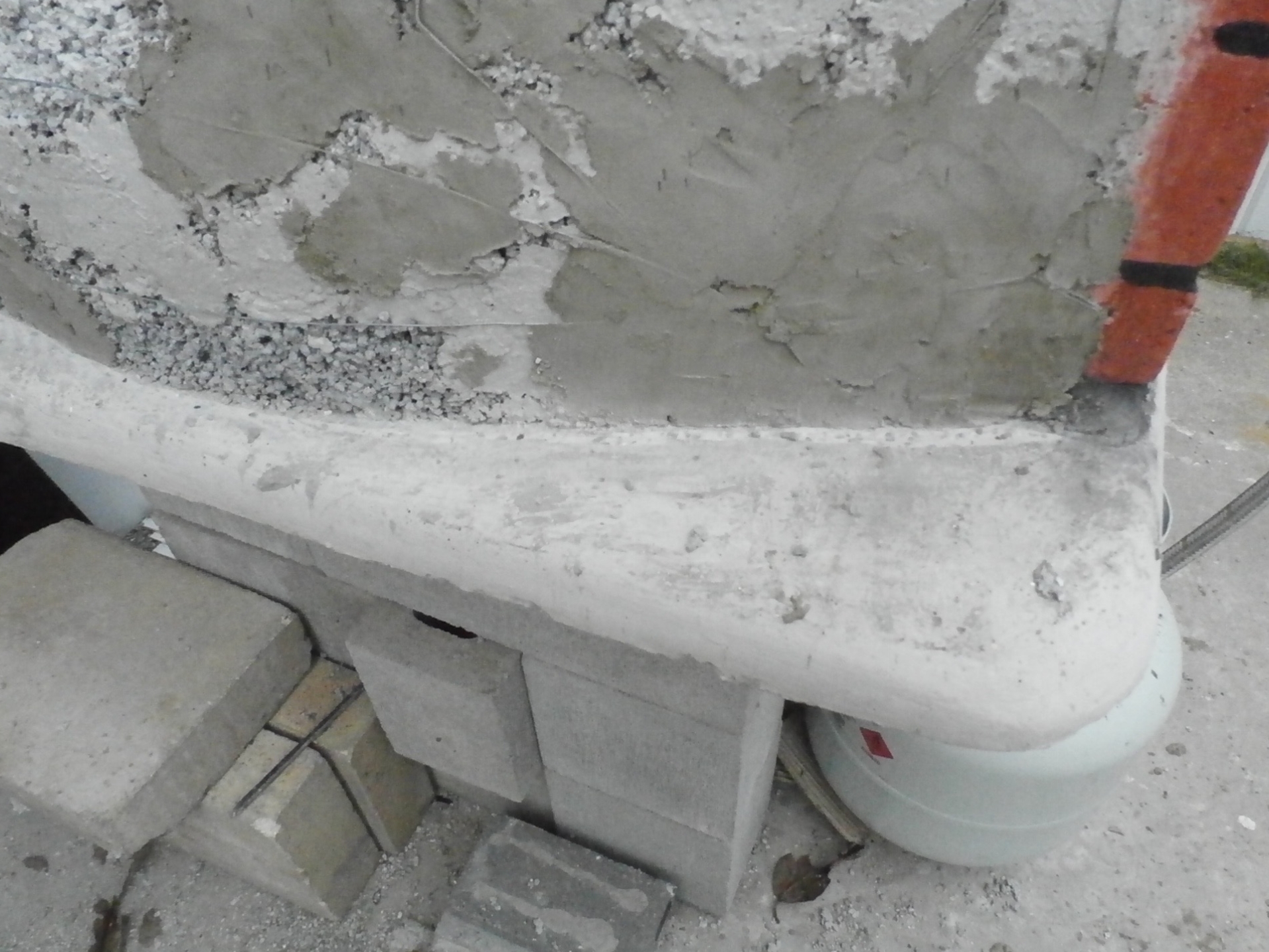

    I'm at that point in a build now. If you are trying to bond onto a polished and sealed counter top then you may have a problem with bonding. I like to clean the area with the angle grinder and diamond blade, then get it damp so the stucco will bond. You may have to look hard at the pic to see what I've done.

      It's difficult to tell what you did from the pic, but I get the gist.
      I sort of did mine in a different order in that I stucco'd the oven and then poured the counter top up to the igloo and stucco.
      I've now polished to 400 grit and I think the grinding pads have cut into the stucco a bit. I shouldn't really need anything there like a bead of caulk I guess.
      I would llike to touch up a few spots on the stucco, mainly because I got some of the chimney caulk on it in a few places.
      Is there a good method to dab some synthetic stucco on the existing in spots? Almost like a small paint brush or sponge I would think?
