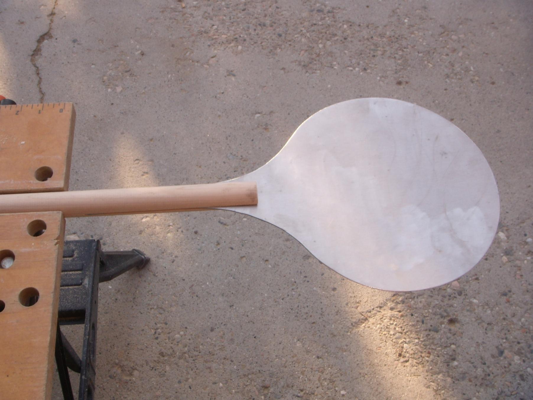

          Do you use a small banjo peel for turning and unloading pizza? I use a large wood peel for loading but after that it is a small 8-9" diameter turning peel to turn, dome and unload. Click image for larger version

              Definitely need to find a good 8" peel for that.
