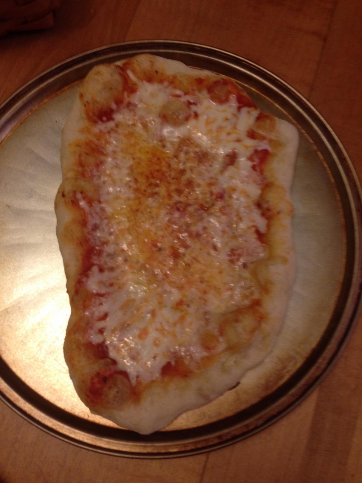

    I waited on the second coat of stucco and cooked pizza instead. It was a learning experience. Unlike the fire I had on Friday, I didn't get to wait until the dome fully cleared due to time constraint so the oven was not at full temp. It took longer than I though it would. First pizza took 2 1/2 minutes but the 5th and last pizza was like 5 or 6 minutes. I think I let the fire die down a bit too much while cooking and the oven is probably not fully free of moisture. I did add some wood and the temp came up a bit but the floor was down to 500 F by the end.
    Kept it simple with a just cheese and a couple pepperoni for my son. They all tasted good which was an accomplishment. The dough was an adventure. I still have some work to do there. 6 dough balls sat in the refrigerator for a day and a half which is supposed to be good but it ended up all merging together to make one big sheet of dough. Managed to get it out and make pizza but it was a challenge. My wife thought if it never got any better that she'd be happy with the pizza. I think she was just being nice.

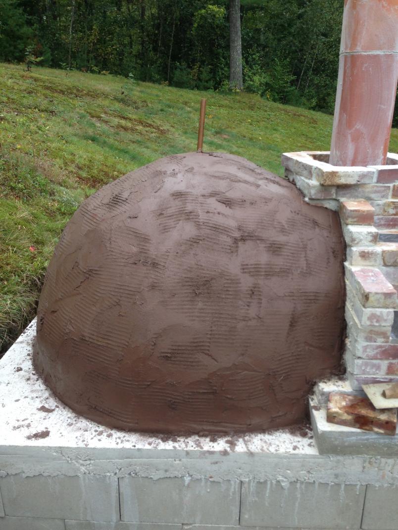

    Took the day off from work and did coat #1 of stucco with the color. Figured I test out how dark to make it with the base coat and it would give me a chance to adjust for the finish coat. I added reinforcement fiber to it and I'm tempted to go 2 coats. It will be 1/2"-3/4" with two coats and it already looks good in my opinion. If I use the same S Type Mortar/Stucco (Sakrete) for a second coat and it looks good, can I get away with stopping? Will the finish coat add that much more strength?
    Also, had some pretty good fires for 4 hours last night and on-going today. Got pretty hot, not on purpose. couple pieces cranked up the fire unexpectedly. As you can see from the second pic it cleared the dome. After today I think it's pizza time!!!

    As long as the vent will relieve moisture/steam and keep rain out, it is all good.
    Yes the oven will clear eventually. Better later than sooner. Later is more gentle on a new oven's brick as it drys. Completely black is normal. The only reason that the soldier course is not black is that the smoke striates at that level. At about the level of the top of your soldier course is where cool air for the draw of your oven mixes with the hot gasses from your oven. The cool drawn air keeps the smoke from touching these brick. As you know heated air rises.This is also the reason that the oven floor takes longer to come up to pizza temps. Follow the recommended drying schedule and, when it is time, you will start noticing the dome clearing from the top and spreading lower with each passing minute. You may even "smell that smell". That smell is of a super heated oven burning efficiently. No, or very little, smoke will be visible coming from the flue/chimney. The creosotes in the smoke and those coated on the oven walls are now being consumed by the intense heat. That "smell" may be alarming at first, but it will soon become the smell of success. Your oven will go black with soot many times in the future. And you will clear the dome many times. By noticing when your dome starts to clear, you will eventually learn when to stop firng when wanting temps lower than pizza making .
