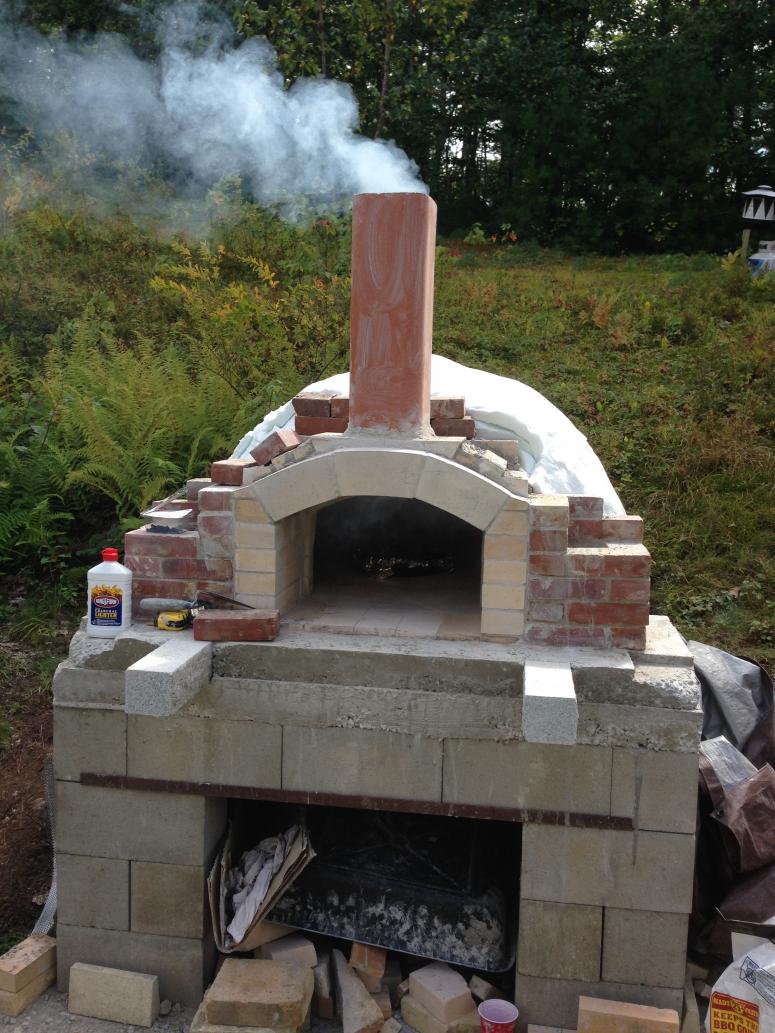

    Curing fire for a couple hours tonight. hard to find the time but now that all the mortar work is done with the entrance I'll be able to do more. What's left of Hurricane Jose coming tomorrow and Weds so nothing going to get done til that passes.

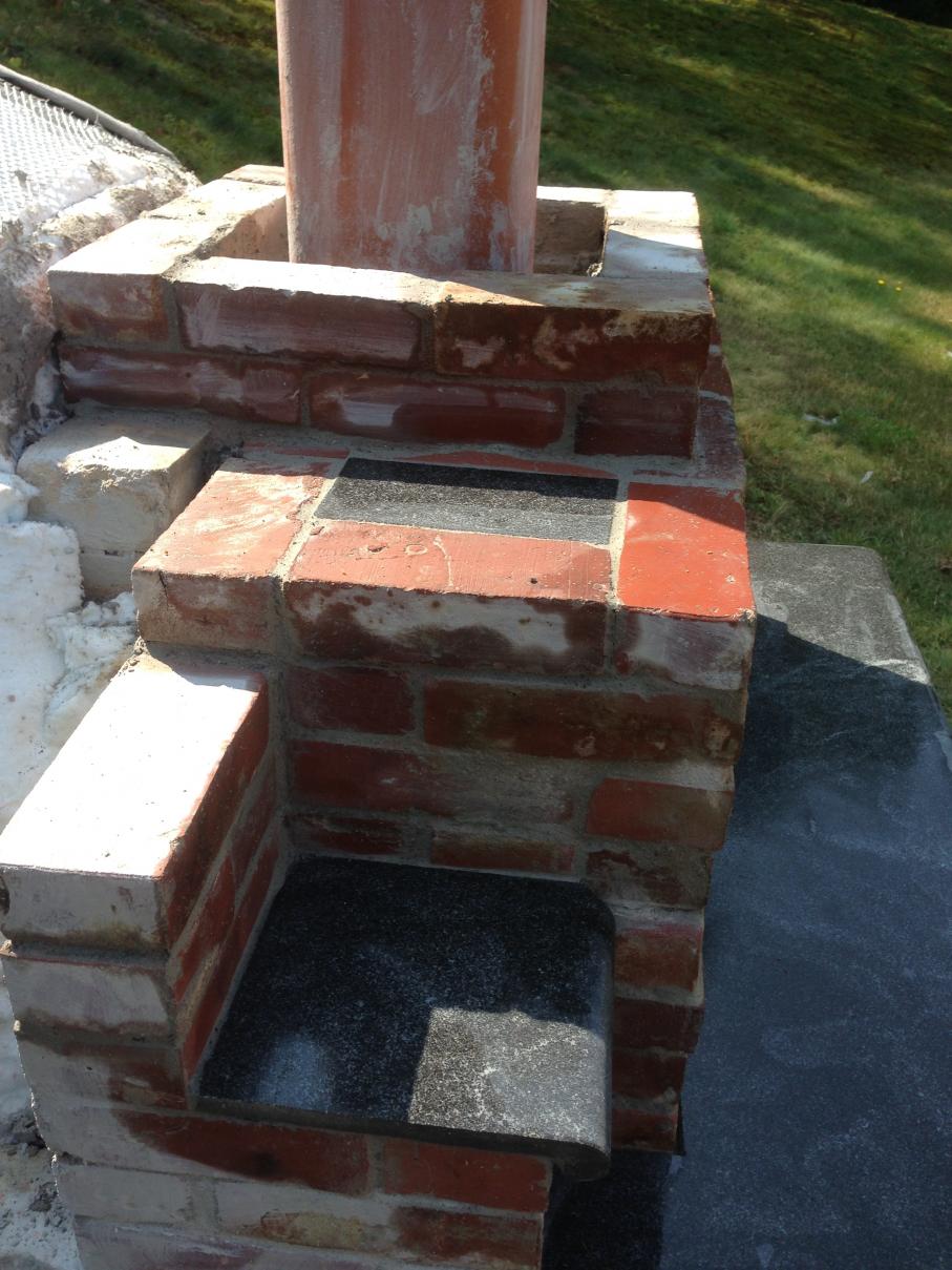

    So I made some really good progress today and totally improvised with every couple bricks trying to get it to look half way presentable. I ended up using some granite pieces from the part I cut off to top off the side flat parts. For a complete amateur I'm pretty happy with the look and I think it will hold up to any stresses from the weight of the chimney. ( I hope ). I didn't have any curing fires since the back of the chimney is actually touching the top of the internal arch and I need to let it cure on it's own for a bit. If anyone thinks it's still OK to have one tomorrow then let me know and I'll fire it up!!
    Here are some pics form today's progress. The last pic is my scrap pile and left over bricks. Pretty efficient for an amateur if I do say so myself.

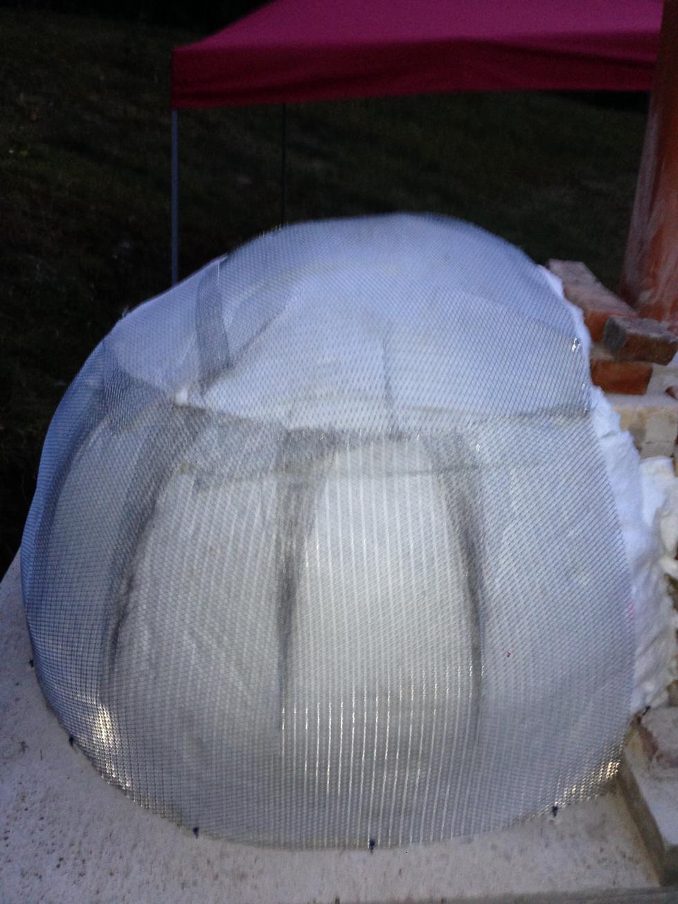

    Nice job on the lath Marc! I hated cutting that stuff...seemed like it cut me as much as I cut it . I do like the insulation on first, then the curing fires choice. I know you can do it either way, but I really think a slower cure this way is worth it. For my money, I'd repeat your 350F fire tonight for the 6-7 hours and then bump it up to the next level tomorrow for the 4ish hours, followed by another 6-7 hours at that level. After that I'd fall back into the normal cure timetable. It's two extra days of curing, but IMHO, during the most critical mid phase and worth it.
    Do you have a door made yet? If you do, after the evening fire has died way down, put the door on the landing leaving a small gap. This will help the retained heat continue to force moisture in the outer layer to exit and leave a little interior air flow/transfer. Here in Oregon, I know those cold and damp mornings too .
    Also, I know many folks might think this overkill but I'd consider putting a bead of silicone seal around the base of your lath where it meets the hearth concrete. That would add an additional moisture barrier to any water that will attempt to move in between the hearth/sloped concrete seam towards your insulation batts and board. Hard to believe sometimes how water will wick through "impossible" places by capillary action.

    Day 2 of curing. Got the upper dome to 350F most of the rest was 300-320, had it going for 4 hours. Smoke wasn't a problem. Got the lath on except for around the entry. I put some screws into the cement around the dome to wire the lath to and then made some cuts so I could overlap the lath and make it as round as possible from the start. Worked out pretty well.
    Next step is to get the first couple courses of the chimney surround on so I can do a base coat up to it. Also put the concrete around the whole thing with a slight angle away from the dome. See the first pic (sorry for it being small) for a very rough sketch of what I'm thinking of doing to get the water to flow away from the dome.

    Looks great Marc! Glad to hear that you'll fill the voids...I angled my rebar towards the arch from the sides in my "buttress voids fill" thinking it might be stronger than just putting them in vertically. Also, my smoke chamber to chimney interface has the same "sharp edges" and creosote does collect there (and sometimes drops down unexpectedly ). I also did the "oops" with cutting my arch bricks and not taking into account the mortar. It seems like almost every build on the forum has a time of "...well, I'll have to wing it..." so you'll figure something out and I'm sure based on what you've done so far, it will end up looking (and working) fabulous)!
    If you can, I'd recommend taking a grinder to the underside of your brick, chimney top plate to round off the edges a bit. It will make for a smoother flow and less creosote buildup. Hope that makes sense...I want to do that to the top corner/space areas of my collection area, but it's going to be a double pain of access and cleanup (so, it's been easy to put off ).

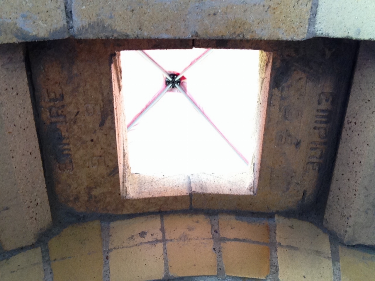

    On your first picture in post #22, it looks like there are spaces behind the front buttress bricks. Is that a space that will be filled or is it just an illusion? If it's a space, being an over-achiever , I'd put in a couple sticks of rebar that lean toward the chimney and then fill it with left-over brick pieces, mortar, and/or concrete to make it solid. !
    I am filling the voids with mortar to make it solid. I'll add some rebar also,
    I finished my vent today. I'm pretty happy with it except it ended up a bit above what I expected because of the difference between dry fit and adding mortar. I will have to wing it trying to get the surrounding surface level so I can start the chimney. I'll also have to add another external arch to support the front edge of the chimney because it needs to come past the existing arch.
    Insulation next before continuing with buttress/chimney work so I don't interfere by mistake and so I can get started with curing the dome.
    Pics of the vent
