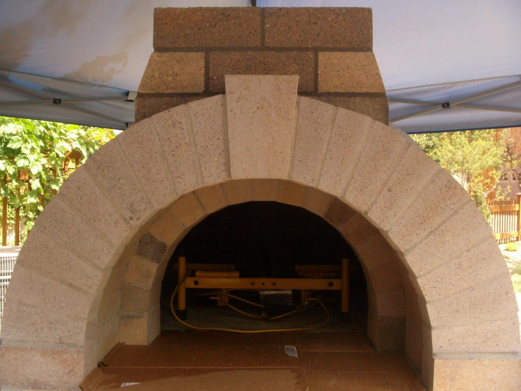

    The key to this question, because I did it, is that the outer edge of my revel on the door is smaller than the outer radius of my outer arch. I have a large brick revel on the inner arch and inset the out arch to act a air dam so smoke would take the path of least resistance, the chimney. As you can see I do get some smoke staining out the front but this is primarily at a cold start up. One the oven starts to heat there is no smoke unless I overload the oven with wood or a green piece sneaks in there. FYI, this is a 42" ID oven and I used a 7" ID double stainless steel chimney but i did have to add an additional foot to get a proper draft.

    Marc, my oven is 39" inside diameter and I had a similar question. I bought 8" ID square clay flue pipe (walls are 1" thick, so I've got basically a flue that's a bit undersized by the book). I did make an enlarged smoke collection area leading into the flue and for the early part of the firing, I do get some occasional "puffs" of smoke out the front. Once the flue heats up however, it draws just fine.
    My biggest mistake is that my outside arch is about the same height as my inner arch. I think if I would have lowered the front arch just an inch or two, I would not have any smoke pop out on startup. Since your round clay flue actually has thinner walls than mine, your larger 7" ID (and 43 sq inch area) should draw like a champ.

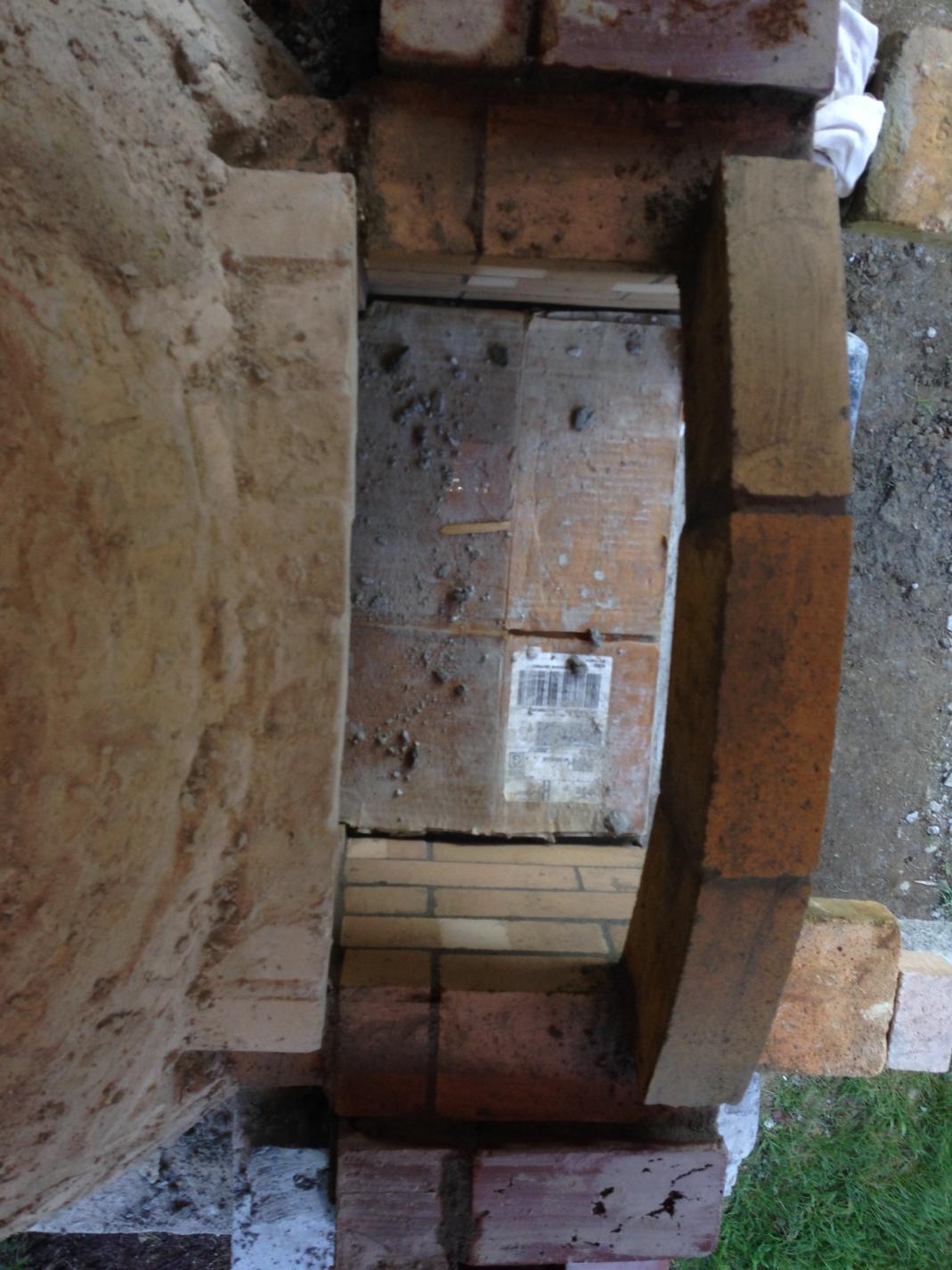

    I added an internal 'arch extension' for lack of a better term and finished out the front arch corners. Also test fit the granite counter top. I need to narrow it to about 17" so I don't have to reach so far into the oven. I'm going to use the trimmed portion to add a shelf to each side of the entrance (see the space in the pics on the last post. I've decided I'm definitely not going to be a mason in a second life.
    Question on transitioning to the flue:
    My plan is to cut some bricks to flatten the tops of the arches. I have some 9 inch square bricks that I was hoping to use at a 45 degree angle on each side. I'll put some angle irons across from one buttress to the other to help take the weight of the brick chimney I plan on having.
    Does this sound like enough support for a 6 foot brick chimney? I also plan on a pergola that the chimney will have to go though which is why I'll need 6 ft

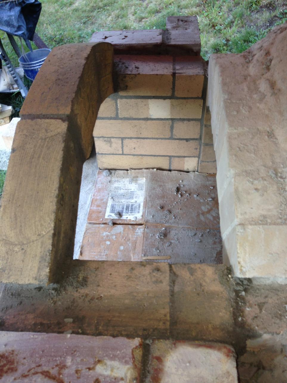

    Had a pretty productive weekend. Finished the entry walls and front arch and the buttress work on each side. Just have to figure out the vent to flue transition now. The opening is 9 inches wide right now. I think I should add another internal arch that will close it to 7 or 8 inches and also bring up the height to match the front arch so it will be easier when I have to transition to the chimney. My door jamb is a little narrow but it was kind of unavoidable.
    Progress pics:

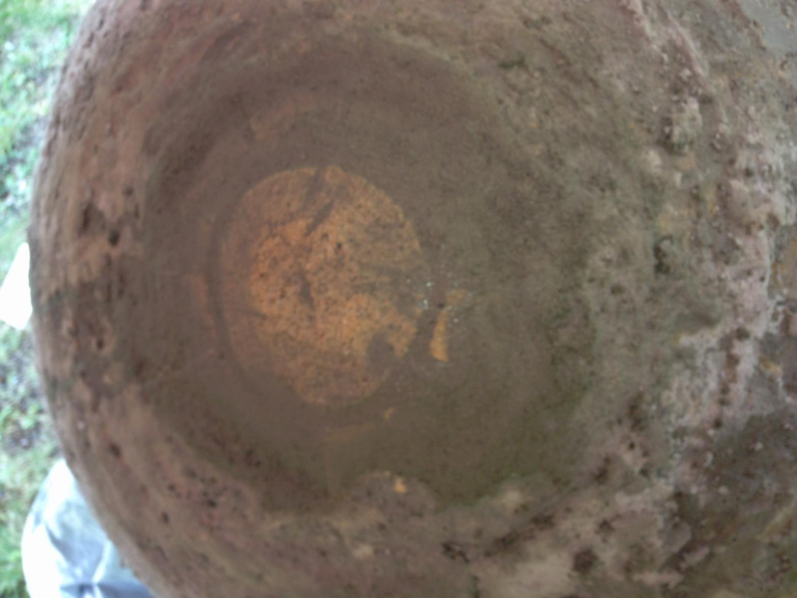

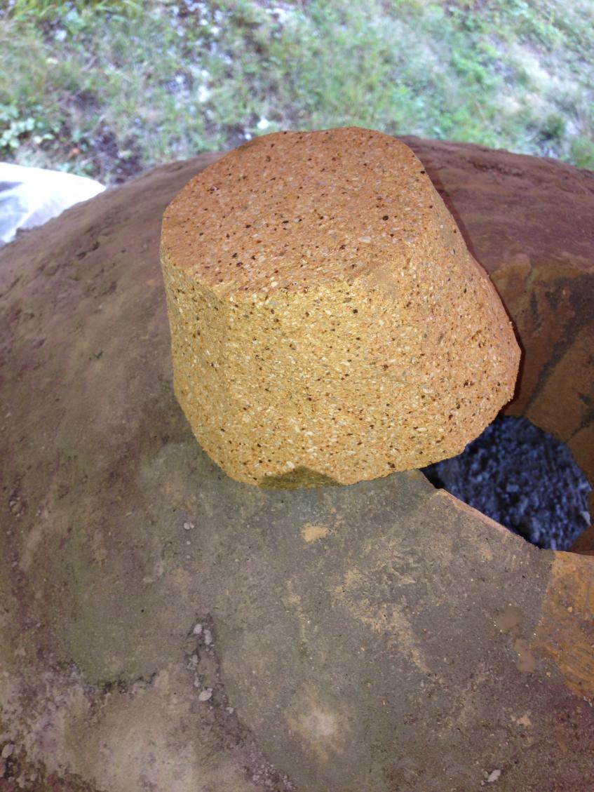

    Well........the dome is closed!!! A lot of cuts to make the keystone see the pics attached. First pic is the large brick I used before and second is the after. Once I got a good look at the interior while cleaning it out I realized there are quite a few joints with no mortar but I had to have my head inside to see them so no worries I guess.
    On to the vent!
