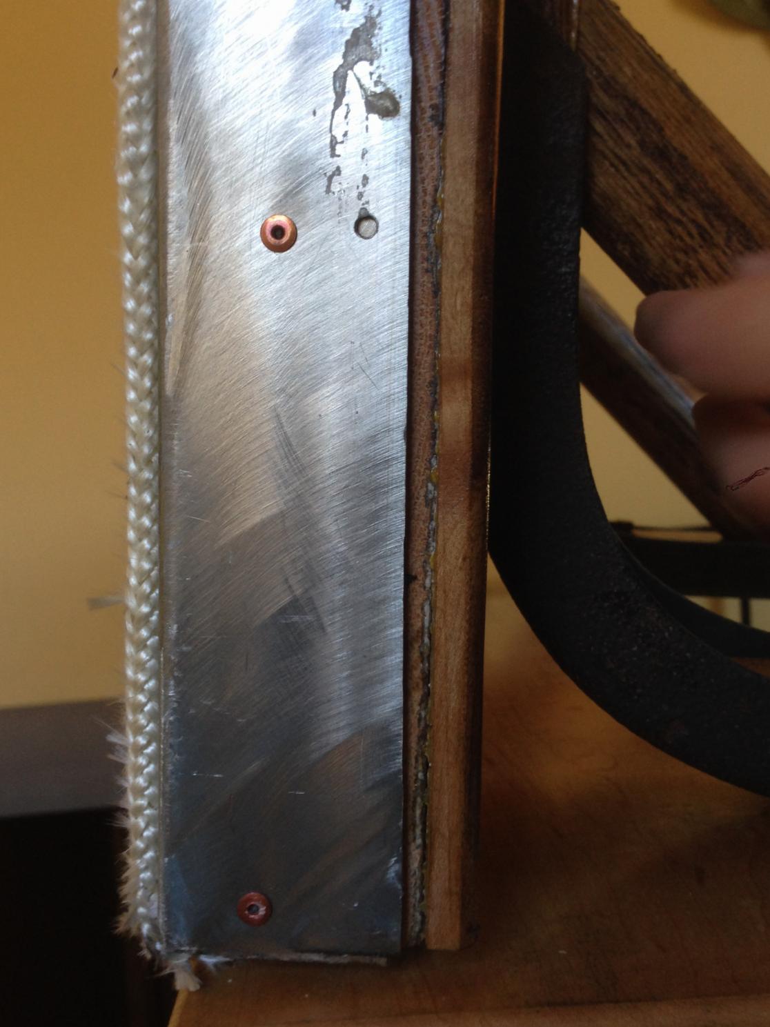

              JR, my door has approximately 1 1/2" of ceramic blanket between the sheet metal and the oak boards. The handles only go into the wood and a little into the insulation but does not reach the sheet metal. I do have 4 or 5 screws attaching the sheet metal to the wood along the sides. The hottest I've had the oven when I put the door on is about 525F and the wood in front ended up a little over 100F about an hour later. I'm wondering if the insulation might be compacted between the sheet metal and the wood and transferring heat more than it normally would?

                If your door is not charring I'd say the insulation is doing it's job. I've put my door on when the oven was HOT and not had a problem cause it's all metal. That said, I think wooden exteriors may be superior as the wood provides some additional insulation and I think they may radiate less. I am planning on putting a wood veneer on mine one of these days.
                • #98
                  I use a wooden door with my ovens, because I like the look of them and they are traditional. Wood is also a far better insulator than any metal which is orders of magnitude greater in thermal conductivity. However a wooden door will char if left in place for prolonged time if the temperature exceeds 300C. 300C is generally way more than you require for baking or roasting. Italians used to soak their wooden doors in a bucket of water to help prevent charing. An insulating panel improves the situation, but if the oven floor is too hot then the contact with the bottom of the door is sufficient to burn the wood no matter how effective the insulating panel has been designed. What you can’t do is to place the door at pizza temperature in an effort to maintain oven temperature overnight.

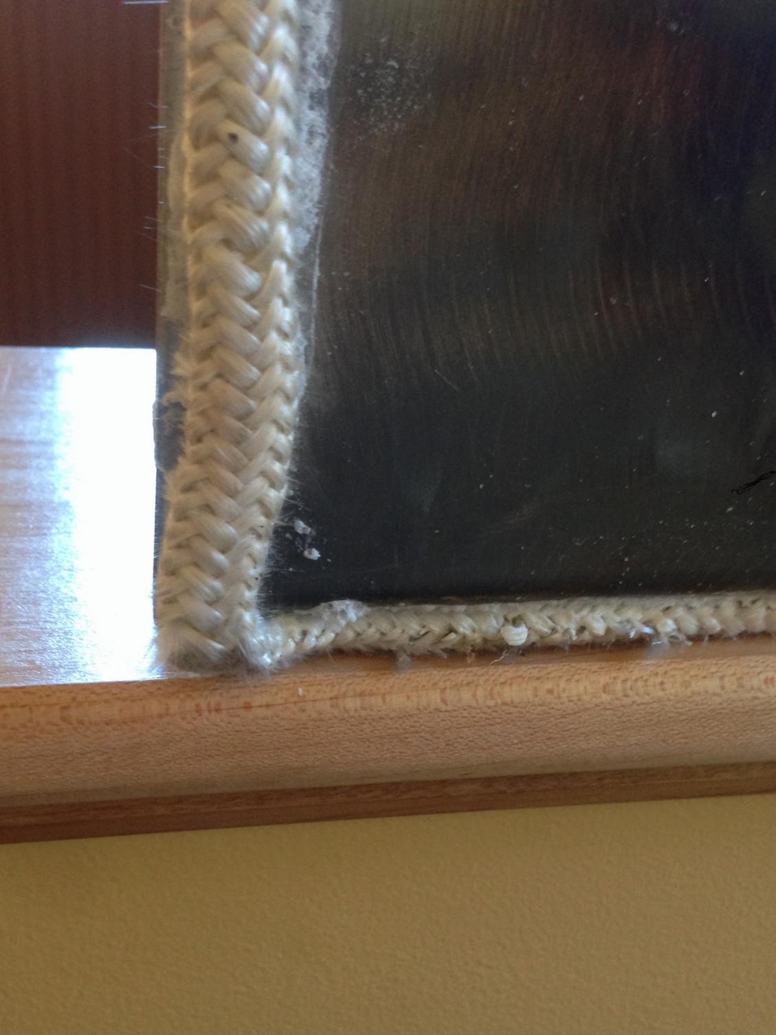

                    I bought a woodstove repair kit and used the rope around and under my door to create a better seal and so the wood will not rest on the brick. It's been working pretty well so far but I don't see the rope staying attached to the sheet metal long term. Already starting to come off. Need better glue I guess. The kit is designed to go in the channel around the perimeter of the woodstove door which is obviously not the case here.

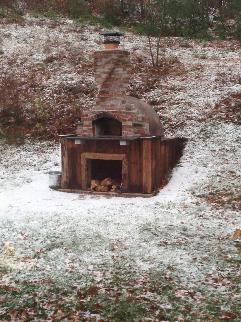

                    As far as cooking goes, had a pizza party and cooked 19 pizzas over the weekend. was a little hectic but went really well. Need some practice maneuvering two pizzas at once in the oven though. Stuck to a single pizza most of the time.
                    Also, looks like my opportunity to put the finishing touches on the exterior will have to wait unless we get a warm spell in the next week or so. (see last pic).

                    • A word of caution, make sure the rope is food safe, in one of the pics you can see the fibers on the rope poking out that can break or shed off onto the cooking surface.
                      • Originally posted by UtahBeehiver View Post
                        Thanks Russell. Hadn't really thought that through since the door isn't there when I'm cooking the pizza and when I cook in my cast iron dutch oven, it's not a concern either. I'll have to see what I can find to do the job.
                        • I think the most food safe ones are made from nomex fiber. The product many folks on the forum use is made to replace gaskets in Green Egg type cookers.

                          • Great! Thanks. Was just looking on the Green Egg website when this was posted. Guess I was on the right track.
                            • I am not trying to be a naysayer, just pointing out "possible" safety and health issues. Here is a link to Rutland's,(one of the major fiber gasket suppliers) addressing possible issues with various type of fiber gaskets. Take it for what it is worth.
                              BTW, after a couple large parties, you will figure out the sequence of cooking more than one pizza at a time. I normally will do two and sometimes three at a time, but three you really need to be on top of things or you end up with black pucks.........lol.

                                Russell, I appreciate the comment and already bought a green egg replacement gasket. The one I have is already falling off and was wondering what I was going to do anyway.
