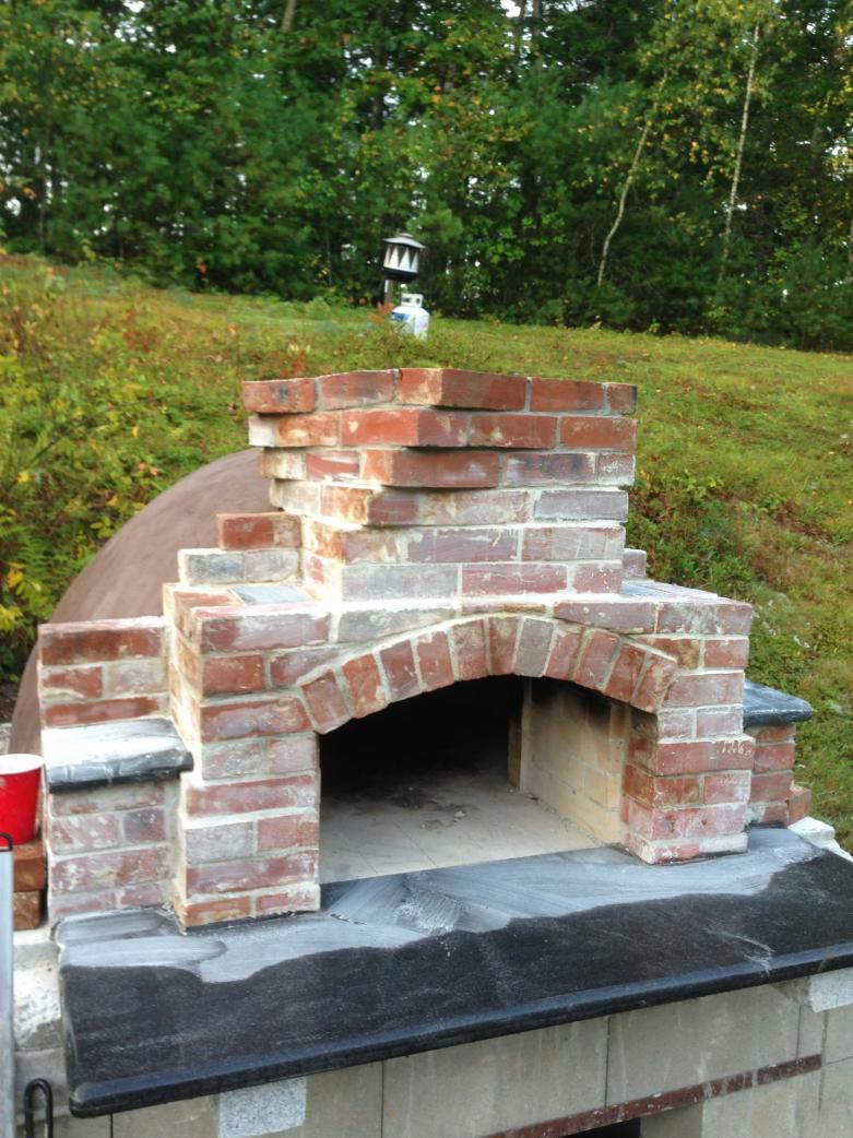

                Was working on my chimney. Going for the spiral brickwork which I saw somewhere on here I think and really liked it. I am even starting to like the look of the old inconsistently sized brick I have to use. I wasn't sure going in what it would look like. Gives it some character. But.......bit of a set back yesterday. I accidently leaned on my flue and broke the bottom mortar joint. Not too pleased with myself and the vocabulary got PG-13 but I guess it's for the best since it couldn't have been a strong bond to begin with. Better now than in another 10 or 12 courses and not being able to get in there to fix it very easily.
                Brings me to the question of strength of that joint: Is it typically pretty week and I just need to be more careful or is there something stronger I should be using?
                I just used my homebrew first time. Just bought some Stove & Fireplace Cement & Mortar that's good to 2000 F. Something better?
                Thanks
                Marc

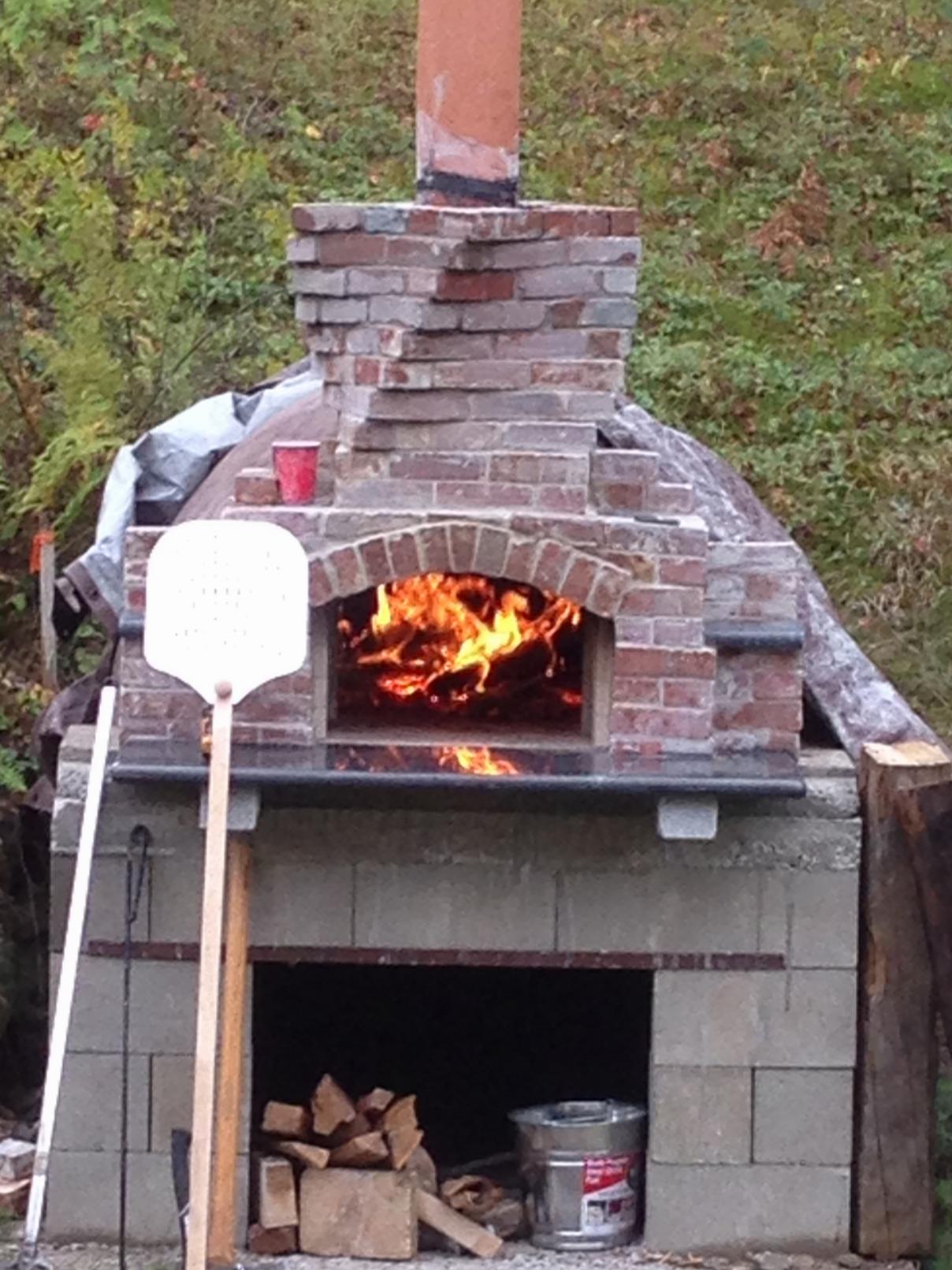

                Pic of the progress (chimney brick) and Lost progress (no flue)

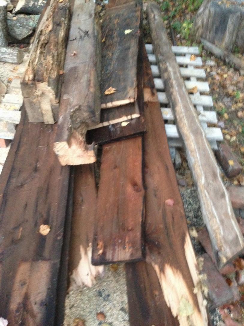

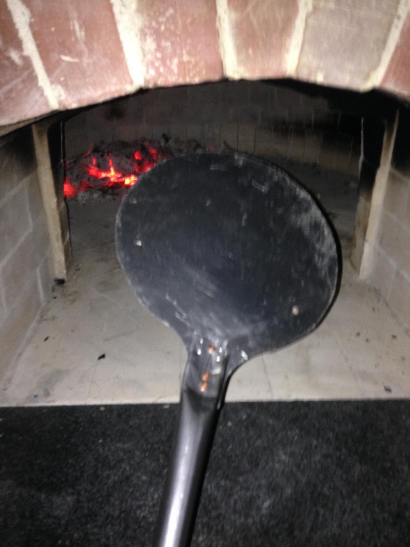

                    Haven't done a lot on the oven but I have cooked pizza a few times. I'm half way on my chimney. Hope to get finished this weekend. My wif e isn't crazy about the spiral but I like it and I think she'll come around when it's back to square. Won't look so crooked. Going to finish the base with 225 yr old barnboard and beams. Hopefully it will stay the dark brown for a while befor turning gray. I like the gray look also so I'll be happy either way. Made myself a turning peel also. $10 piece of 16 gauge aluminium and a $1.72 mop that I used the handle from. Couple rivets later and I saved myself $80-$100.
                    Pics of progress, barn board and turning peel

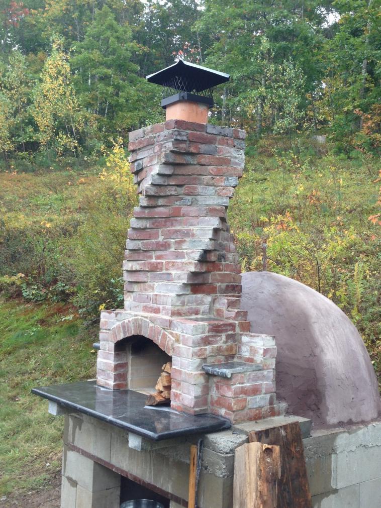

                      finished the chimney for this year. Will add more once I figure out how I'm going to do the pergola over it. Only have the barn board facade and back filling behind it left before the snow flies.
                      Really happy with how the spiral came out and my wife did come around and now really likes it.
                      Pizza cooking is going well with only one near calzone candidate and I see one little crack in the dome which surprises me since I used old firebrick. I expected more.

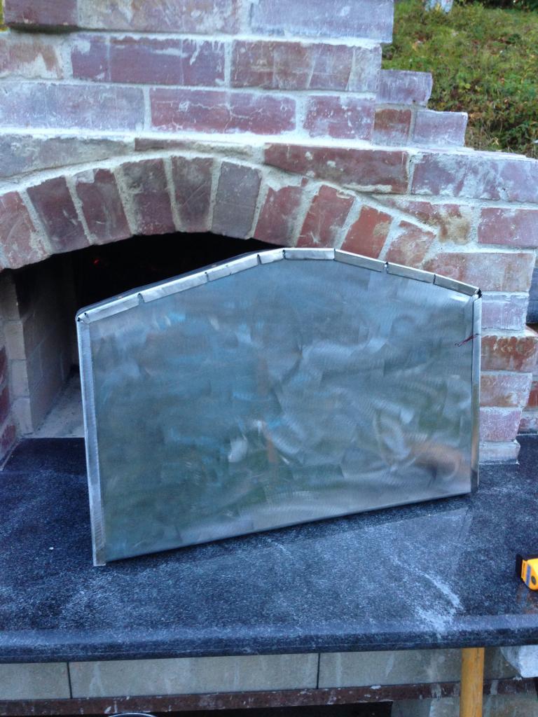

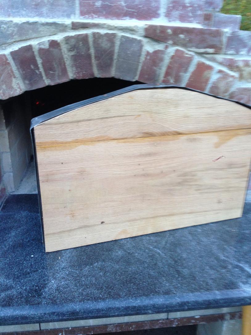

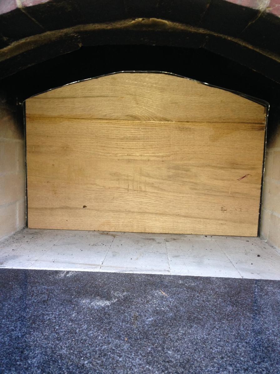

                        I have the door mostly done. 1 " ceramic blanket behind the oak front. need some sort of trim around the edge to hide the sheet metal from the front and some handles.
                        Is 1 " CFB enough"???

                          #72
                          1" should be just fine. The blanket protects the oak. But, the oak is still working as a second string insulator.
                            #73
                            Anything north of 300 C and you may find the wood wil burn. The main problem is the wood sitting on the hot floor. 300 C is hotter than you need for roasting or baking anyway, just don’t expect to be able to place the door at pizza temperature, leave it there til morning in an effort to hold all that heat. You’ll probably find the door will be charcoal from the bottom up.
                              david, although I haven't put it on yet, I have insulated rope that will run along the edges and top to get a good seal along the door jamb and then along the bottom between the floor and the door. I don't have a picture yet but the sheet metal wraps the wood on all sides so the wood will be insulated by the rope and then two layers of the sheet metal......and like you said, I won't be putting the door in place with fullpizza temps
