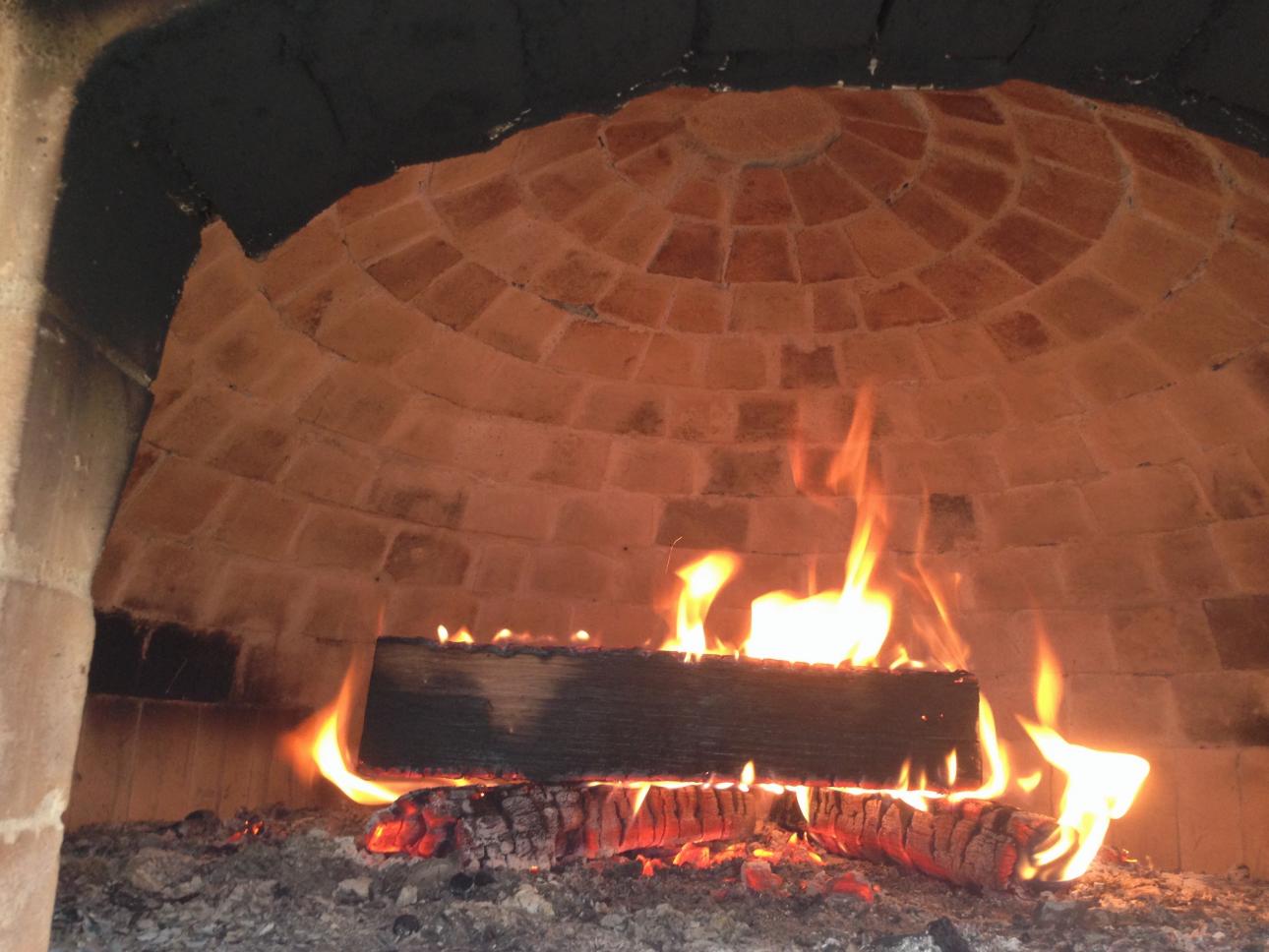

                  Took the day off from work and did coat #1 of stucco with the color. Figured I test out how dark to make it with the base coat and it would give me a chance to adjust for the finish coat. I added reinforcement fiber to it and I'm tempted to go 2 coats. It will be 1/2"-3/4" with two coats and it already looks good in my opinion. If I use the same S Type Mortar/Stucco (Sakrete) for a second coat and it looks good, can I get away with stopping? Will the finish coat add that much more strength?
                  Also, had some pretty good fires for 4 hours last night and on-going today. Got pretty hot, not on purpose. couple pieces cranked up the fire unexpectedly. As you can see from the second pic it cleared the dome. After today I think it's pizza time!!!

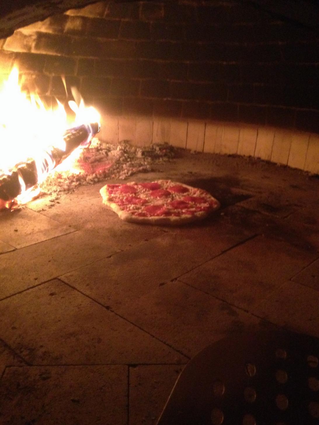

                        I waited on the second coat of stucco and cooked pizza instead. It was a learning experience. Unlike the fire I had on Friday, I didn't get to wait until the dome fully cleared due to time constraint so the oven was not at full temp. It took longer than I though it would. First pizza took 2 1/2 minutes but the 5th and last pizza was like 5 or 6 minutes. I think I let the fire die down a bit too much while cooking and the oven is probably not fully free of moisture. I did add some wood and the temp came up a bit but the floor was down to 500 F by the end.
                        Kept it simple with a just cheese and a couple pepperoni for my son. They all tasted good which was an accomplishment. The dough was an adventure. I still have some work to do there. 6 dough balls sat in the refrigerator for a day and a half which is supposed to be good but it ended up all merging together to make one big sheet of dough. Managed to get it out and make pizza but it was a challenge. My wife thought if it never got any better that she'd be happy with the pizza. I think she was just being nice.
