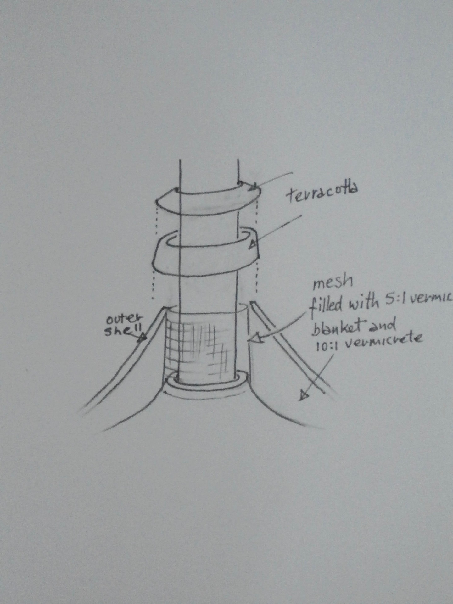

I do mine in a slightly more complex way to both support the flue pipe some 8" higher up and also to allow moisture to escape from the insulation layers between the two terracotta caps.High temp silicon to seal the top cap against the pipe. I use a proprietary castable refractory for the flue gallery (one inch thick) , but if you are doing a one off the home-brew should work fine as the top of the flue gallery does not see the same kind of temperatures as the inside of the dome.
Leave a comment:
I do mine in a slightly more complex way to both support the flue pipe some 8" higher up and also to allow moisture to escape from the insulation layers between the two terracotta caps.High temp silicon to seal the top cap against the pipe. I use a proprietary castable refractory for the flue gallery (one inch thick) , but if you are doing a one off the home-brew should work fine as the top of the flue gallery does not see the same kind of temperatures as the inside of the dome.Originally posted by Chach View Post

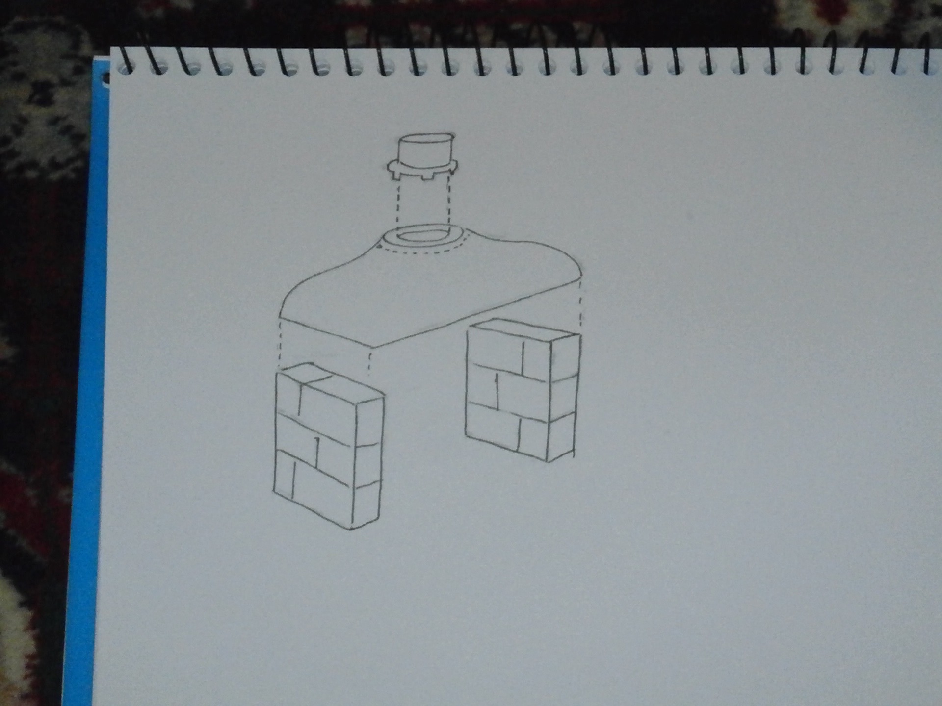

Im listening for sure and very interested in making this easier and efficient. what would be the casting recipe for this and thickness of the cast? . If i do the 3 tab method how does it stay secure? Do youu pack homebrew around it then?. and if i go with the anchorplate i would just cut away most of the square and place it in the wet casting leaving just the top exposed for the flue connection?. supervent sells stainless anchorplates for $22 not terrible price here.

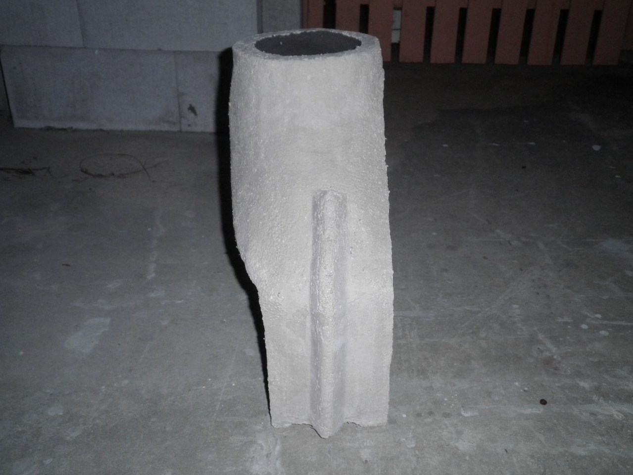

Im listening for sure and very interested in making this easier and efficient. what would be the casting recipe for this and thickness of the cast? . If i do the 3 tab method how does it stay secure? Do youu pack homebrew around it then?. and if i go with the anchorplate i would just cut away most of the square and place it in the wet casting leaving just the top exposed for the flue connection?. supervent sells stainless anchorplates for $22 not terrible price here.Originally posted by david s View PostI cast my flue gallery and it is both shallow and very light because you can make a casting much thinner than the thickness of a brick. I have reinforced the sides with buttresses and the depth of the flue gallery is the same as the diameter of the pipe (5") This creates a very shallow entry which makes working the oven far easier. Nothing worse than having to work down a long tunnel before you get to the oven proper. This is probably too complex for a one off so another idea is to build the sides in brick and cast a piece for the top. If you cut away most of the square part of the anchor plate it can be placed on the casting when you get near the top so the base of the anchor plate is embedded in the casting. I don't use anchor plates, but fit the flue pipe as shown by making 3 tabs. Anchor plates are expensive and fitting by drilling into the brick is asking for cracks to be created there from the constant stress of expansion and contraction of the fixing. Also because the area gets pretty hot there, only stainless fixings should be used. Hope this is food for thought. There are many different ways it can be done, but brick units certainly don't lend themselves to complex forms whilst maintaining structural integrity.

David thanks for all the info...I dont know what i was thinking about the sketch I made my bricks are 2 1/2" not sure why I was thinking 3" I would have 7" between the arches.....ill have to read up on casting. so if I do cast would I cast in the stainless anchor plate for the flue? How would I transition from cast to the duravent flue pipe?Originally posted by david s View PostYes, it’s the cross sectional area that you work on. A 6” pipe has a cross sectional area of 28 sq in. The form of the flue gallery is difficult to build in brick without having lots of joints lining up. So much easier to cast where compound curves and a reduced mass are a breeze. A heavy brick flue gallery can act like a heat sink sucking stored heat from the dome.
Leave a comment:
Yes, it’s the cross sectional area that you work on. A 6” pipe has a cross sectional area of 28 sq in. The form of the flue gallery is difficult to build in brick without having lots of joints lining up. So much easier to cast where compound curves and a reduced mass are a breeze. A heavy brick flue gallery can act like a heat sink sucking stored heat from the dome.Last edited by david s; 06-05-2019, 04:47 PM.
