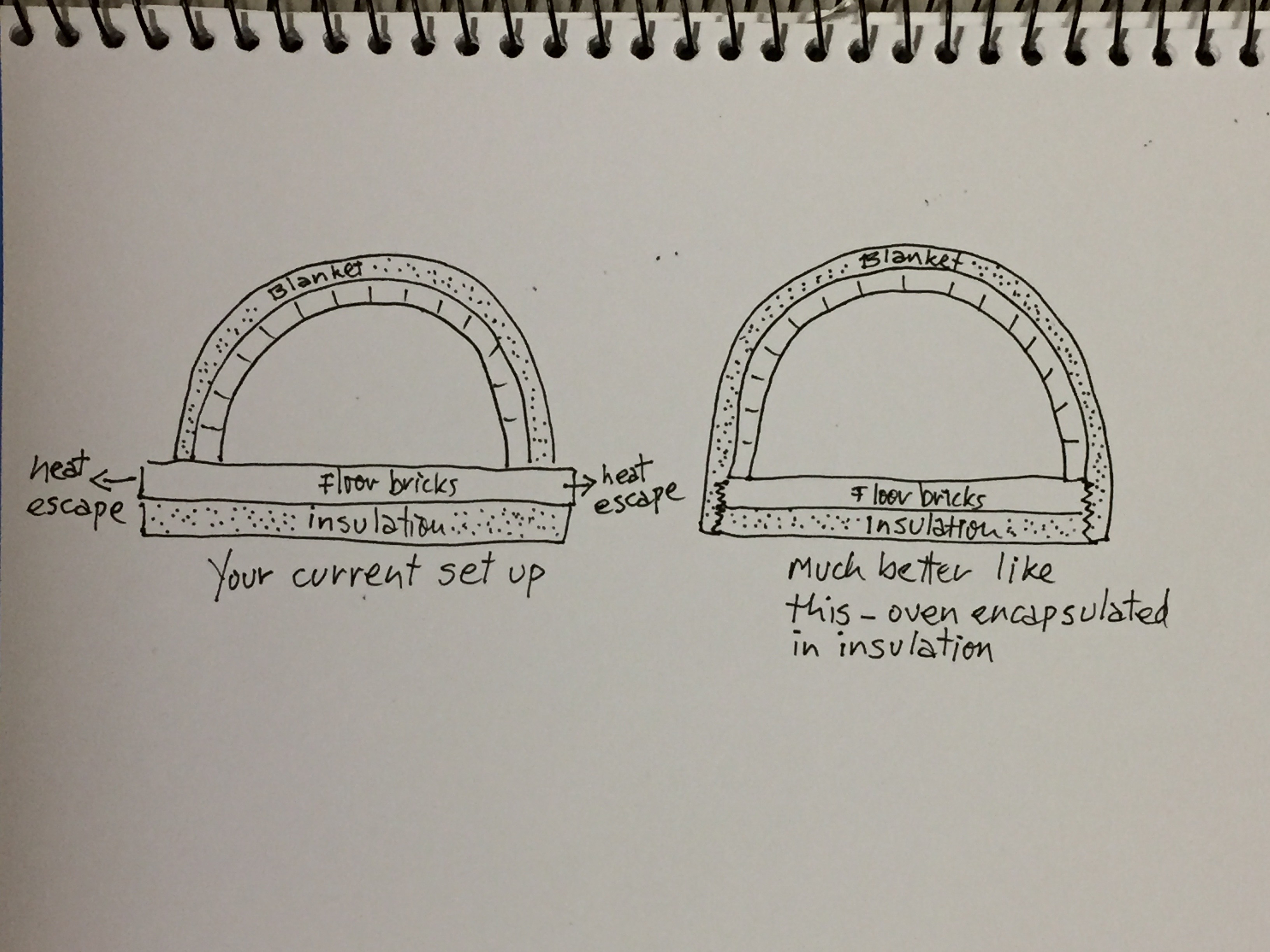

Ok. Sorry I thought your top layer of insulation was fire brick. If you are building an igloo then cut the protruding insulation off. If you are building an enclosure then just make sure the insulation is inside it. You don’t want any insulation that is absorbent exposed to the weather.

Maybe I'm misreading your design and/or I didn't explain too well. Here is a pic of what I meant.

oh i see no the floor bricks are cut inside the oven and the dome built around them the only thing that sticks out past the dome is the 2 insulation boards...i see what your talking about though should i cut the insulation back and put the blanket around the.edge of the board?

Maybe I'm misreading your design and/or I didn't explain too well. Here is a pic of what I meant.Originally posted by Chach View Post
not sure what you mean? I left a gap between the oven floor and the vent floor. I also have a gap between the side vent walls and the cast flue from the dome and I inserted 1/2" ceramic rope between the dome and the vent walls and flue. the floor bricks are flush to the end with the vent walls and also have a gap at the sides and is on thermal gold 12 and foamglas. I didnt however put Insulation on the the front of the walls of the vent just on the flue cast. should I put 2 little strips on those pieces?

Originally posted by david s View PostI notice that your floor bricks extend out past the blanket. The whole oven should be encapsulated in insulation otherwise heat will conduct outwards via the floor bricks. You could cut the bricks off so they don’t extend past the base of the dome. As these cuts are not seen they can be a bit rough. A diamond blade on a 6” angle grinder works pretty well, but wear a good mask. Then if you have any blanket offcuts left, insulate the space left where the floor bricks were.
