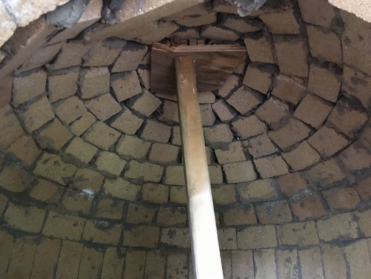

                            I did do a full side compound bevel on my bricks, I did to show myself I could, would I do it again, most likely not (a lot of saw time) That said, you can accomplish the same inside joint tolerance by just doing a bevel cut but only the first inch or so from the inside of the dome out (where the bricks conflict - you will not see this the first couple courses but as you go up this cut eliminates the "inverted V"), then let mortar be you friend and fill in the gap on the back side. I believe JRPizza did this and his inside joints look very nice. This way you can spend you time resources elsewhere.
                            Also here is an example of a build that did not use bevel angle and the inverted v is prominent.
