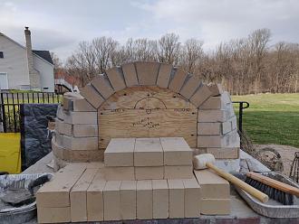

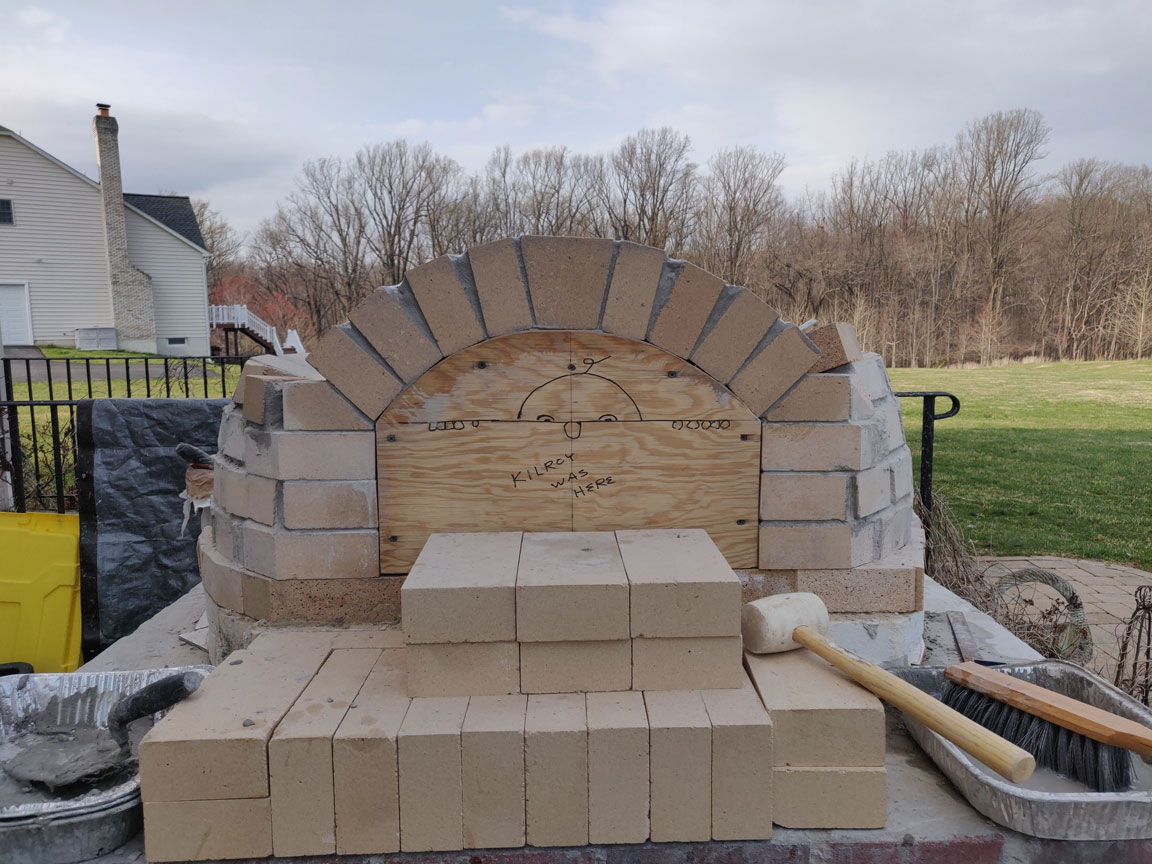

      After being out of town for a while, I am back from my hiatus with a status report. Over the past several weeks, I cut my base and began to lay my first 2 courses.
      I made a mistake at the dome entrance and needed to remove the "bookends" of the first course as the entryway brick was too thin. I have since rebuilt the bricks at the base of the inner arch to be squared off as shown in the pictures. All in all, the courses are going a lot faster than I thought they would. I've started to get into a rhythm where I will first lay all the bricks at the correct vertical angle (buttering on the bottom) and then I will go back around a second time while the bottom is still green and fill in the gaps in the side joints. Also, I've been very careful to re-wet the bricks with a wet brush when I'm doing this second mortar application.

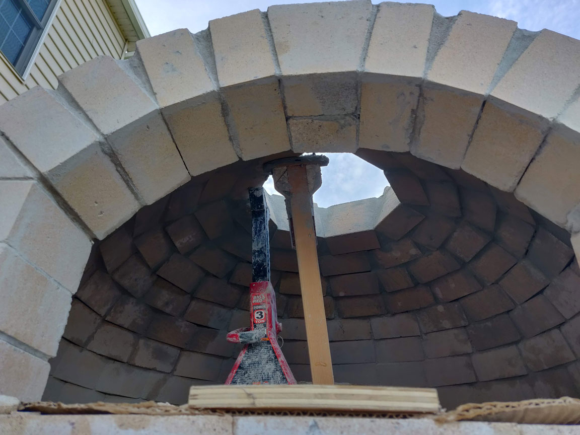

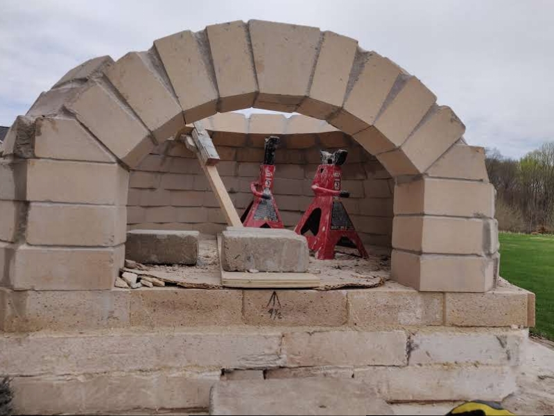

                I take it you are taking about the entry arch not the dome.because I can see from the pics the dome courses are using the IT alignment. The arch with vertical walls will be what is called an Axed Arch. There was a recent post where the program for General Tools "angleizer" was posted (it is no longer available from General Tools directly). It will calculate the Axed Arch based on brick size, radius, width, height. Remember the opening arch height needs to be around 63-65% of the dome height. I've used this program several times and it is spot on.
                I found the link,

                  Thank You!! Yes, it will be an Ax Arch. Right now I'm thinking the arch will be 12" tall (18" dome), is 66% within an acceptable margin of error?

                    Close enough for government work..............
                    Updated
                    I did notice that the 7.5" dimension may be without joints factored in, assuming brick thickness is 2.5". This may throw your opening ratio off enough to be a concern putting the ratio in the 70s. If this is the case you may have to reduce the 4.5" dimension and arch will be a little flatter. The flatter the arch the more sideward pressure there is and depending on chimney type may require some buttressing.

                      Ah, I see what you mean. Would there be any issue with instead just trimming the angle on the top block if its too high?

                        The anglelizer program calculates the tapering of brick so the mortar joints and taper shape of the brick are consistent. I am not sure what you mean by trimming the angle of the top brick, can't seen the pic, it is too small.

                          The only down side is cosmetic...the 1 row will be thinner when you look in. Nothing functional or structural I can think of.
                          I think its a bit awkward to do if you've already set the bricks, but if you mark it well you could cut as you've shown in place.

                            Long time no post... I've been waiting to continue construction due to the cold winter we've had up north, however, we're finally into spring and have just a few nights left around 30 degrees. As I am using Heat Stop 50 to mortar my courses, do I need to wait for a full week of above freezing temperatures? I've been worried that if I get 1 night below freezing it could shatter my fresh mortar and I'd loose structural integrity... am I being overly paranoid?
                            Also, over the fall I got the opportunity to go to Adelaide, AU and visit Maggie Beer's Farm Shop in the Barossa valley. I was able to talk with the chef who built/uses the pizza oven there- what a great guy! He was extremely helpful and encouraging as I was talking about my build and all the great folks here on the the forum. Here are a few pictures of Maggie Beer's pizza oven:

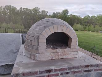

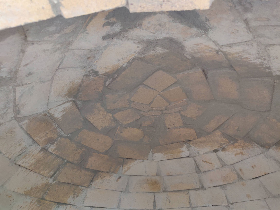

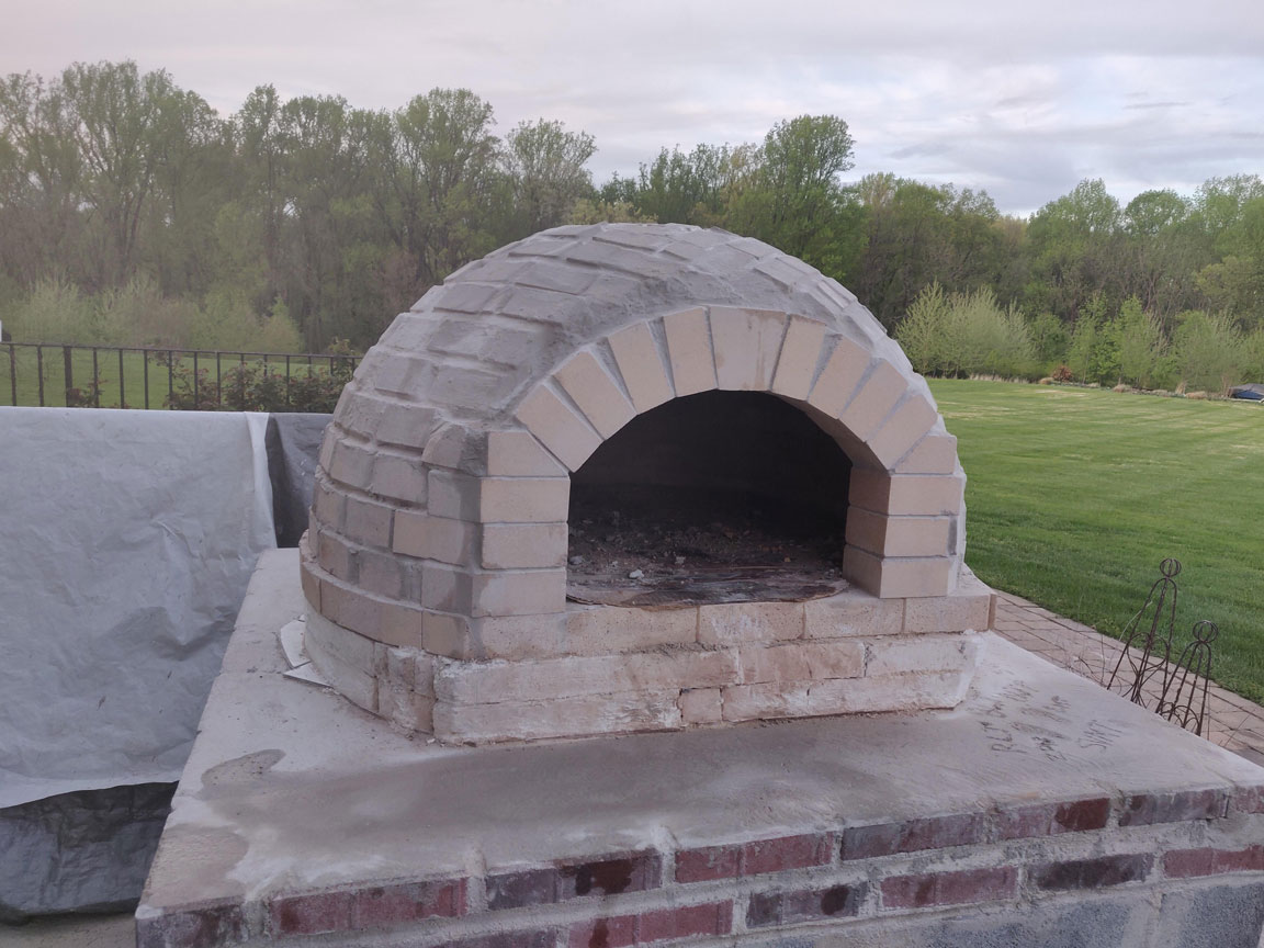

                              Finally finished my dome!
                              This weekend, I'm hoping I can clean up the inside and then I'm a bit confused as to what my next task should be, right now I'm planning the following order:
                              1. Construct the entry arch/flue
                              2. Lay Ceramic Blanket & seal (As I have 2 boxes of ceramic blanket, I plan to insulate the entry arch)
                              3. Cure the dome (I think it was recently decided that its now best to insulate the dome before curing?) If there is a sticky related to this, I would really appreciate someone dropping a link for me
                              Click image for larger version  Name:	image_85938.jpg Views:	1 Size:	203.2 KB ID:	412614Click image for larger version  Name:	image_85939.jpg Views:	1 Size:	257.6 KB ID:	412615Click image for larger version  Name:	image_85940.jpg Views:	1 Size:	139.0 KB ID:	412616Click image for larger version  Name:	image_85936.jpg Views:	3 Size:	144.4 KB ID:	412617Click image for larger version  Name:	image_85935.jpg Views:	3 Size:	173.0 KB ID:	412618

                                • 5262
                                #60
                                In the Forno Bravo plans there is curing out line in section 17. But a couple newer innovations, start with a halogen light, gets you around 150-75 F. Then a couple firings of charcoal briquettes gets you around 200 F (cook something dutch oven while your at it), then really "small" kindling fires, "don't" throw that extra log on, it can really spike the temp quickly,
                                then follow FB curing guide. You are looking at about a week. Also current best practice is to insulate but not stucco before curing, David S advocates placing plastic over the oven, if you see condensate form then oven is still wet, if you see steam, going too fast or hot.
