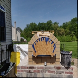

        A lot's been happening over the past 2 weeks. I built the hearth and yesterday insulated the dome with 2, 2" rolls of insulating blanket. I was pleasantly surprised that the blankets had some stiffness so they could be shaped. The most annoying part really was securing the mesh over top of the insulation. Last night I ran sterno cans for 6 hours and had ~115 degree fires. Today I plan to run my remaining sterno cans 2 at a time- this should bring a constant low 200 degree heat (a friend gave me a dozen cans for free so I figured I might as well use them). Tomorrow I plan to use some lump charcoal from my smoker in a cast Iron pot to get a 300 degree fire, then I'll start using wood on Tuesday.
        Hopefully next week I can then stucco the dome with quikwall. I'm planning 2 coats of stucco; 1 scratch coat + fortifier, 1 top coat with fortifier and crushed stained glass that I'm going to polish.
        I must say, it's quite rewarding to be this close to the finish-line, I'm already looking around for a few stacks wood to start cooking with!

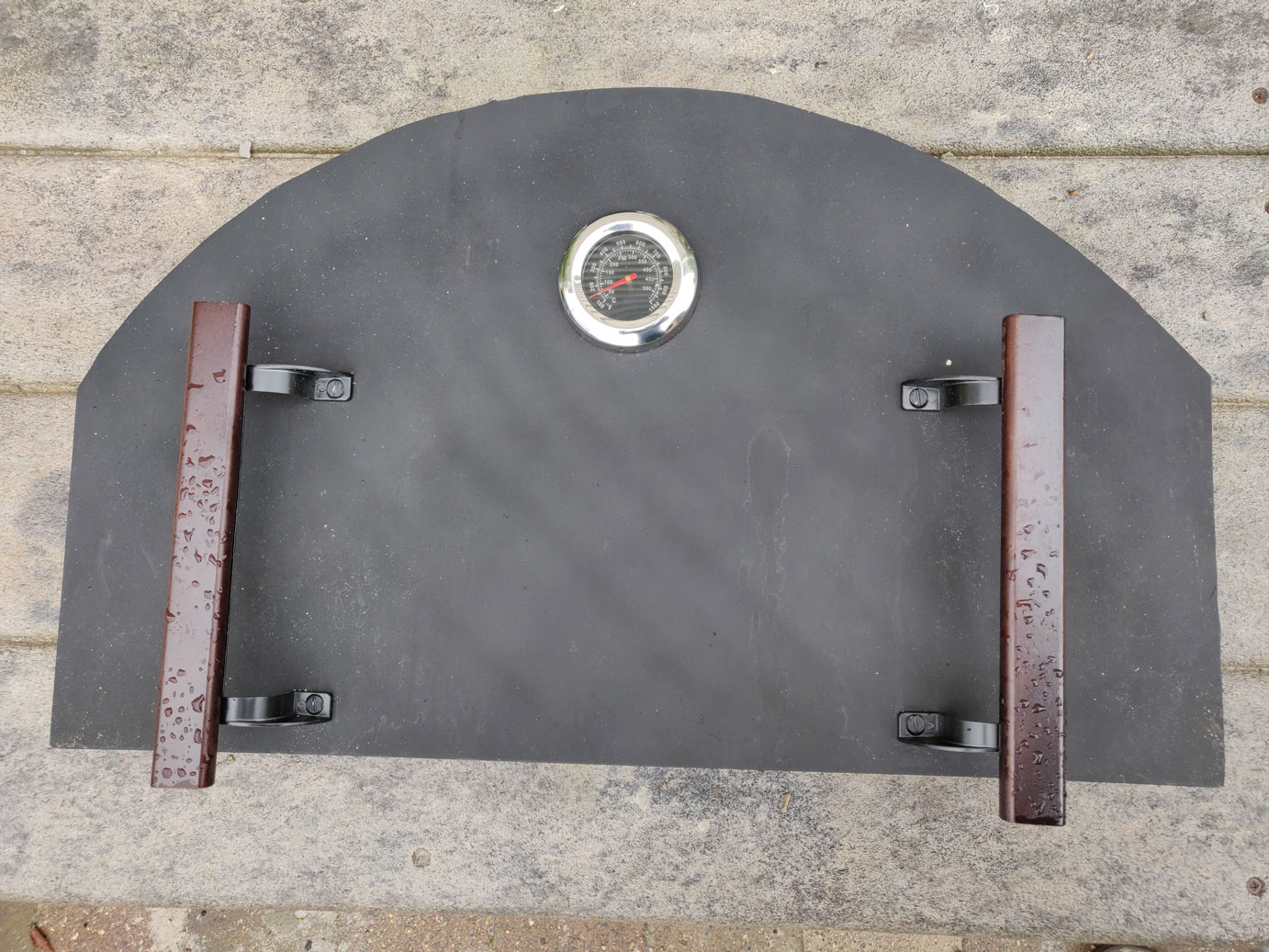

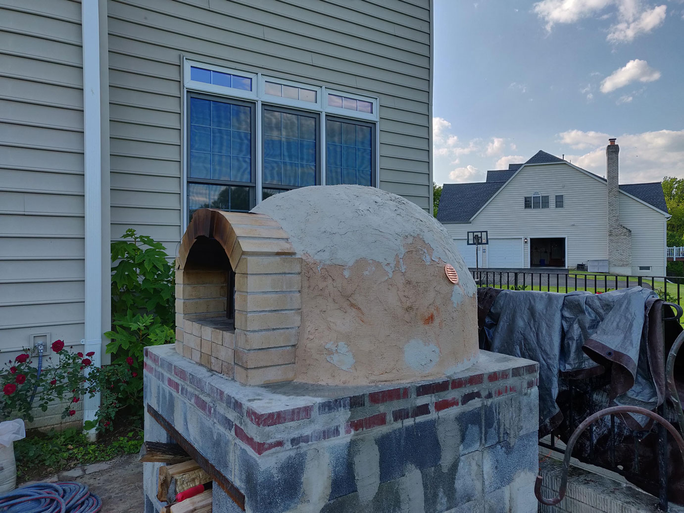

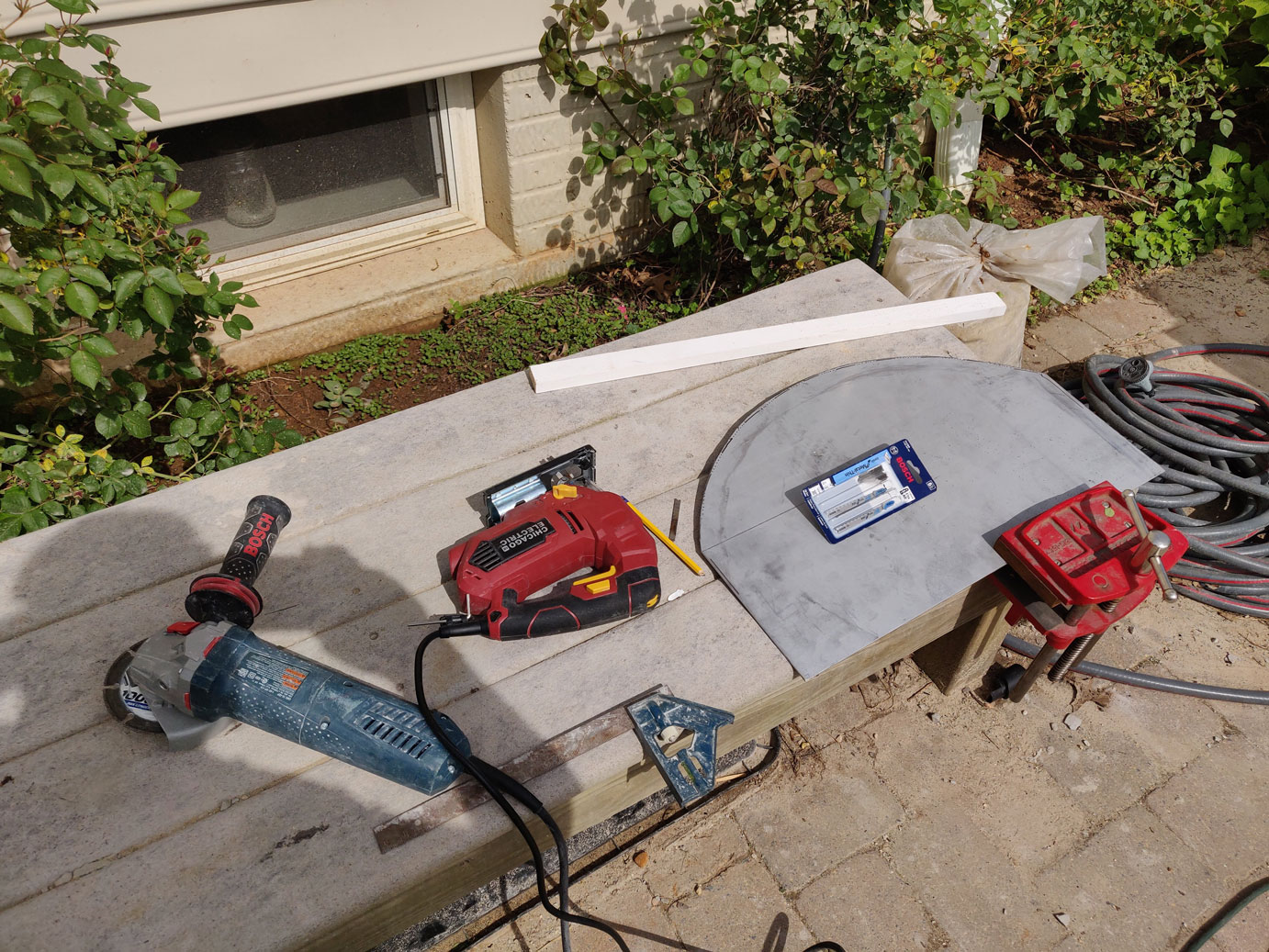

          #64
          A lot has happened since my last post- I was able to do a number of curing fires and I built my door. Tomorrow, I'm hoping to throw some sourdough in the oven and put my initial coat of stucco on. Also, I found some really nice copper vents that I think I'm going to use to help any steam escape: https://www.amazon.com/gp/product/B0...?ie=UTF8&psc=1

              Looks great, exciting times for you!
              I normally just use a short piece of copper pipe for the vent and seal it over once the oven is cured.
              I think some form of insulated door is a good idea especially if you want to cook the next day.

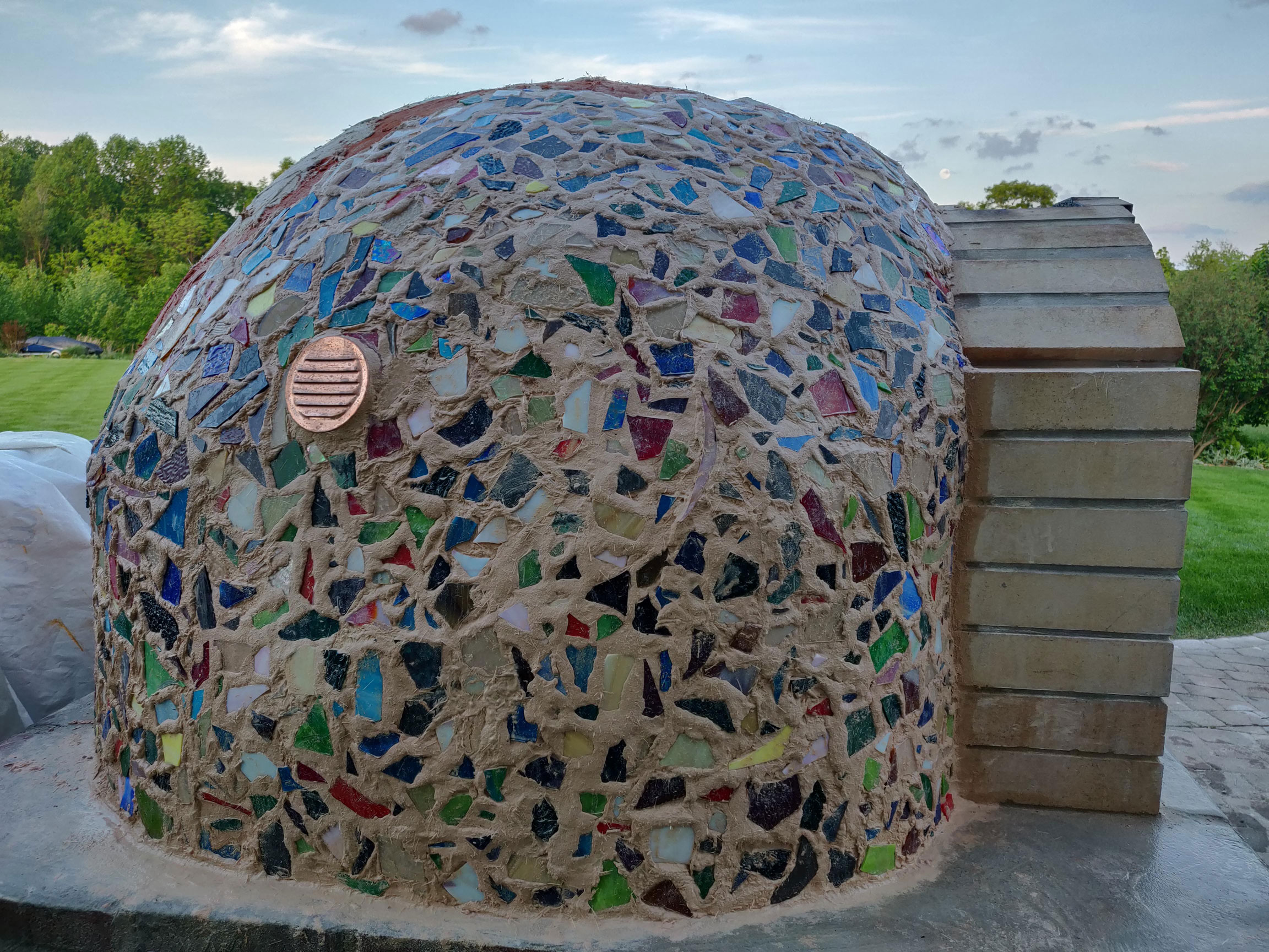

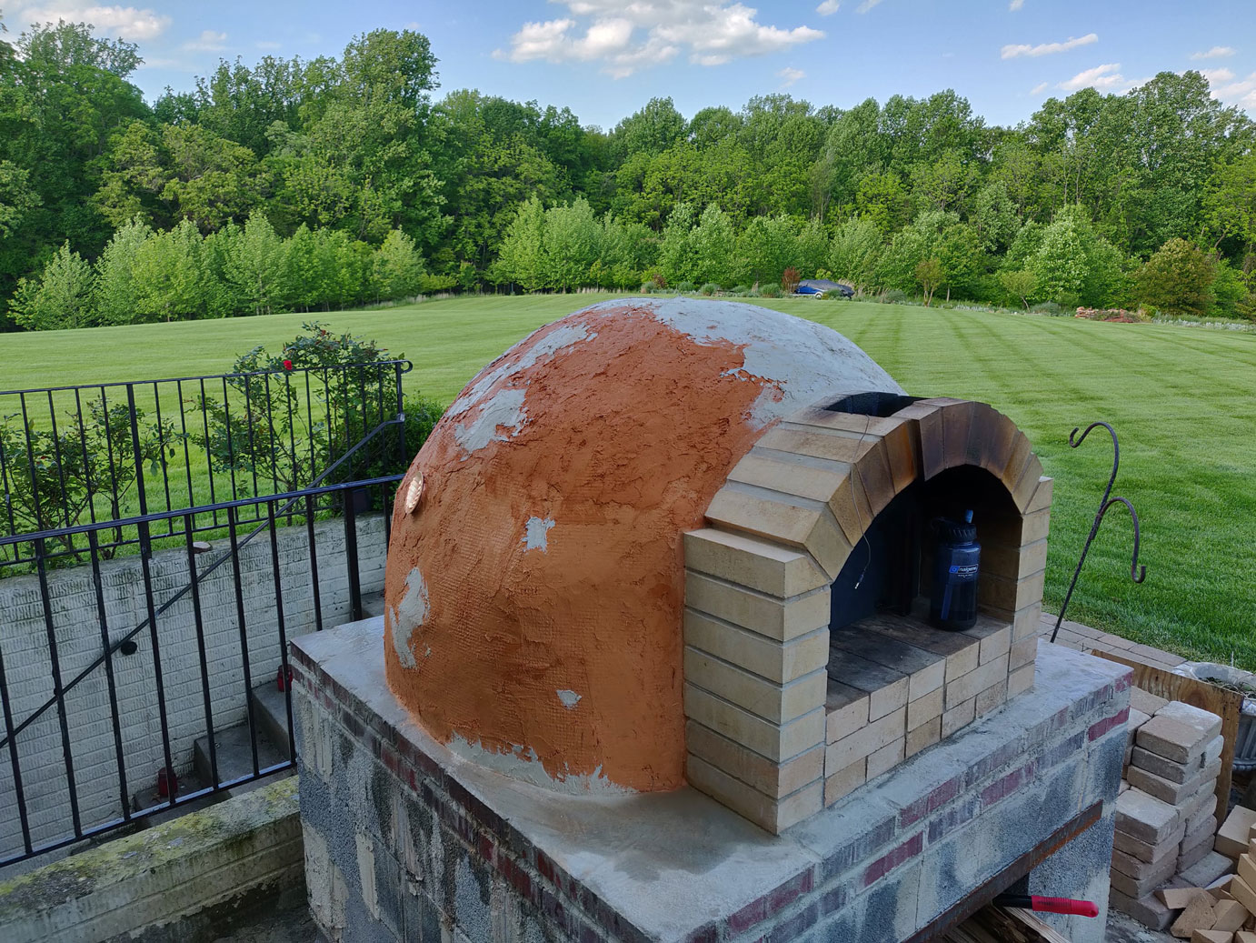

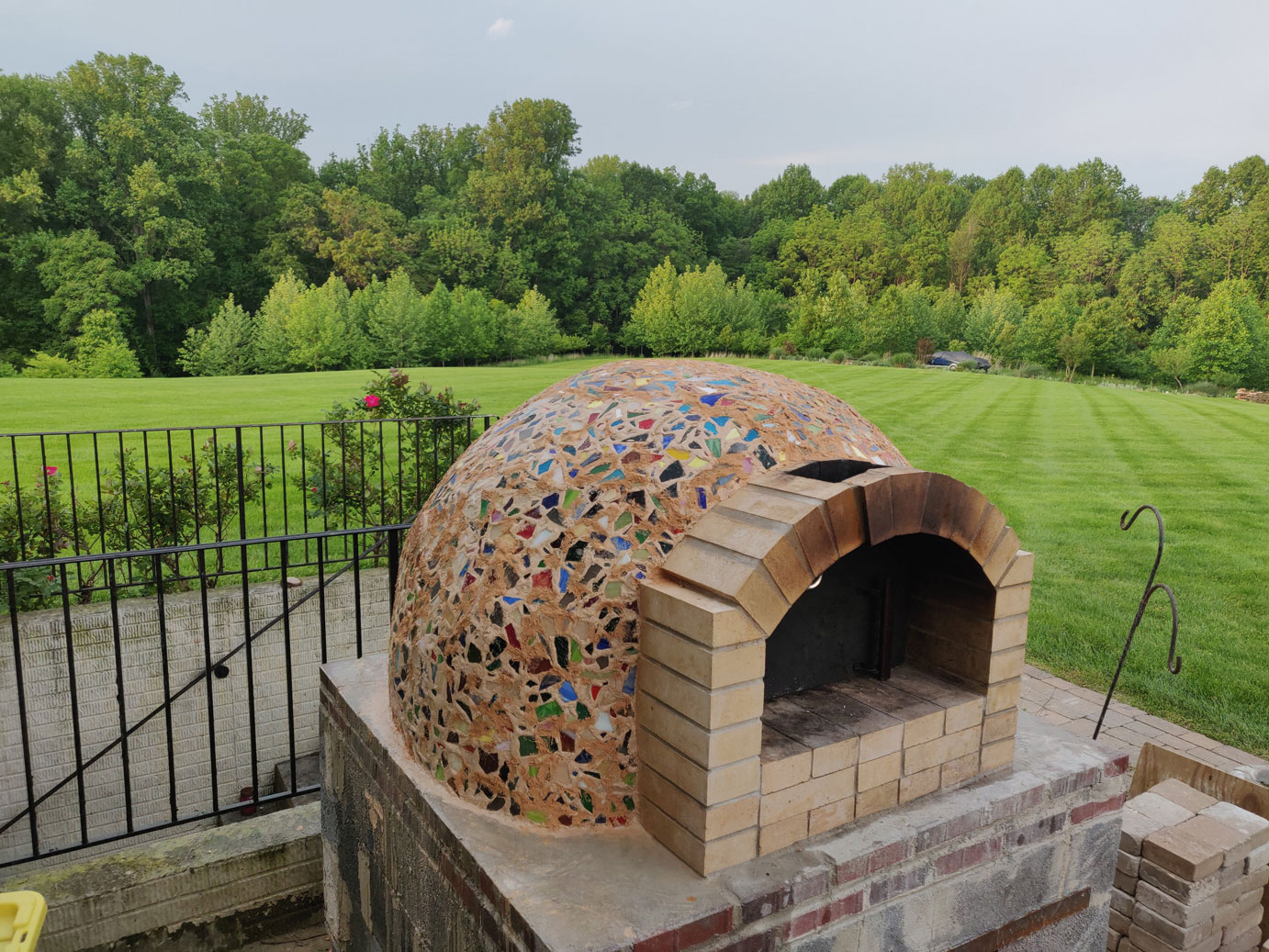

                        Just wanted to post a progress report. Yesterday, I was able to run a coat of quikwall over the dome and test various stains.
                        Today, I was able to run another coat of quikwall on my dome and began to decorate with the stained glass. Even though we are only partially done, I am VERY pleased with the results. I think I'm still going to skimcoat over some of the rough edges and come back with a polishing brush, to give it that finished look (an added bonus of the stained glass is that it hides any imperfections of the dome form geometry)

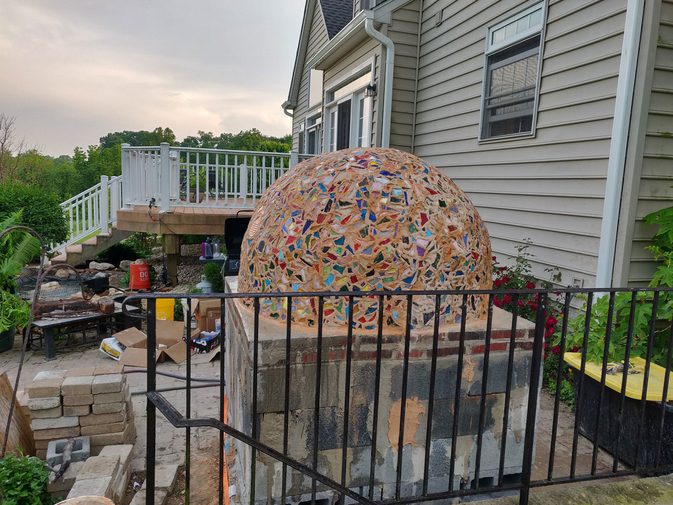

                          #72
                          Busy day, completed all the stained glass mosaic- pretty much worked from 7am - 7pm only stopping for lunch. Overall, I think it went well, I need to figure out how to polish/buff the glass as there are some mortar streaks on some of the pieces. Only thing left is to quikwall the base, buff/polish the dome, and install the chimney! Looks like we are on track for a Memorial Day Pizza Picnic!

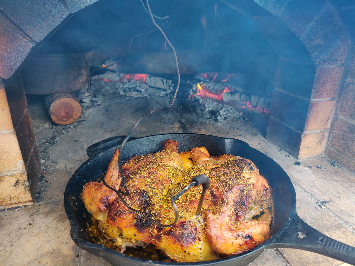

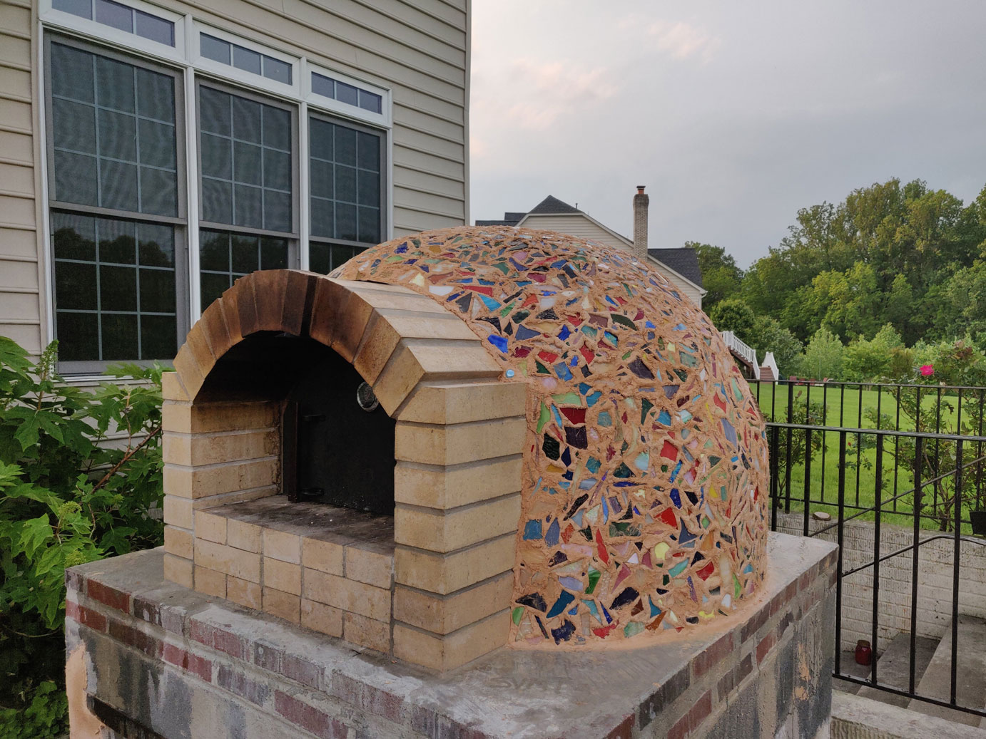

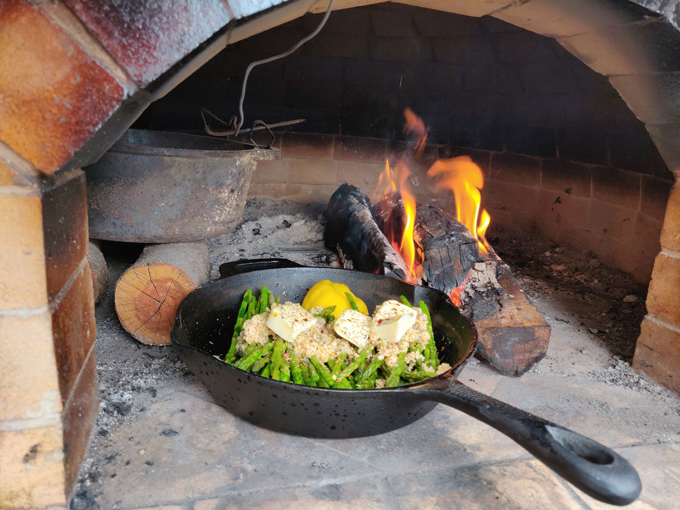

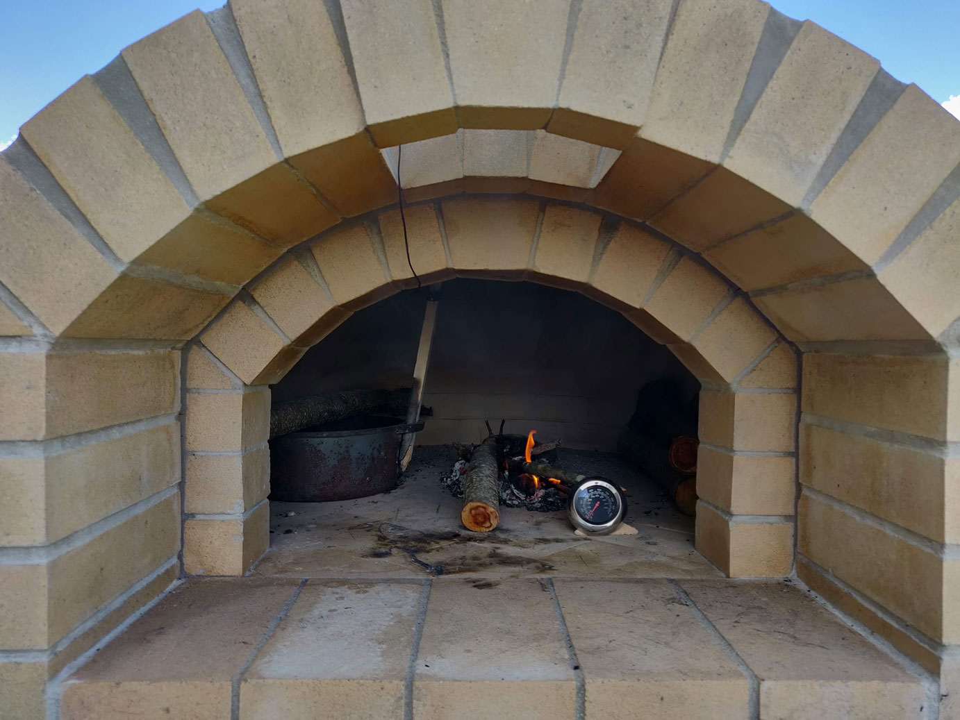

                            #73
                            Almost done!! We've been able to do quite a bit of cooking in the oven and I've used acid to clean up some of the stained glass. The crack in the back of the oven is frustrating (pictures 1 & 6) , but it looks like this is just due to thermal expansion (https://community.fornobravo.com/for...ne-crack/page2). Hopefully today, I can get the chimney laid and tomorrow cap it ...I can't believe that after almost a year this project is almost finished!
                              #74
                              The cracks could of been caused by the joints lining up. But as long as the shell is good then all is well. I build mine in 2012 and I still have a few things to do on my oven, so the work is really never over....lol
                              • JRPizza
                                • Jan 2012
                                • 1557
                                #75
                                If the oven wants to crack it will crack. I didn't have joints lined up so the crack in my oven just went right through a couple of bricks. I think it was david s that said you want your mortar to be weaker than your bricks - apparently not mine
