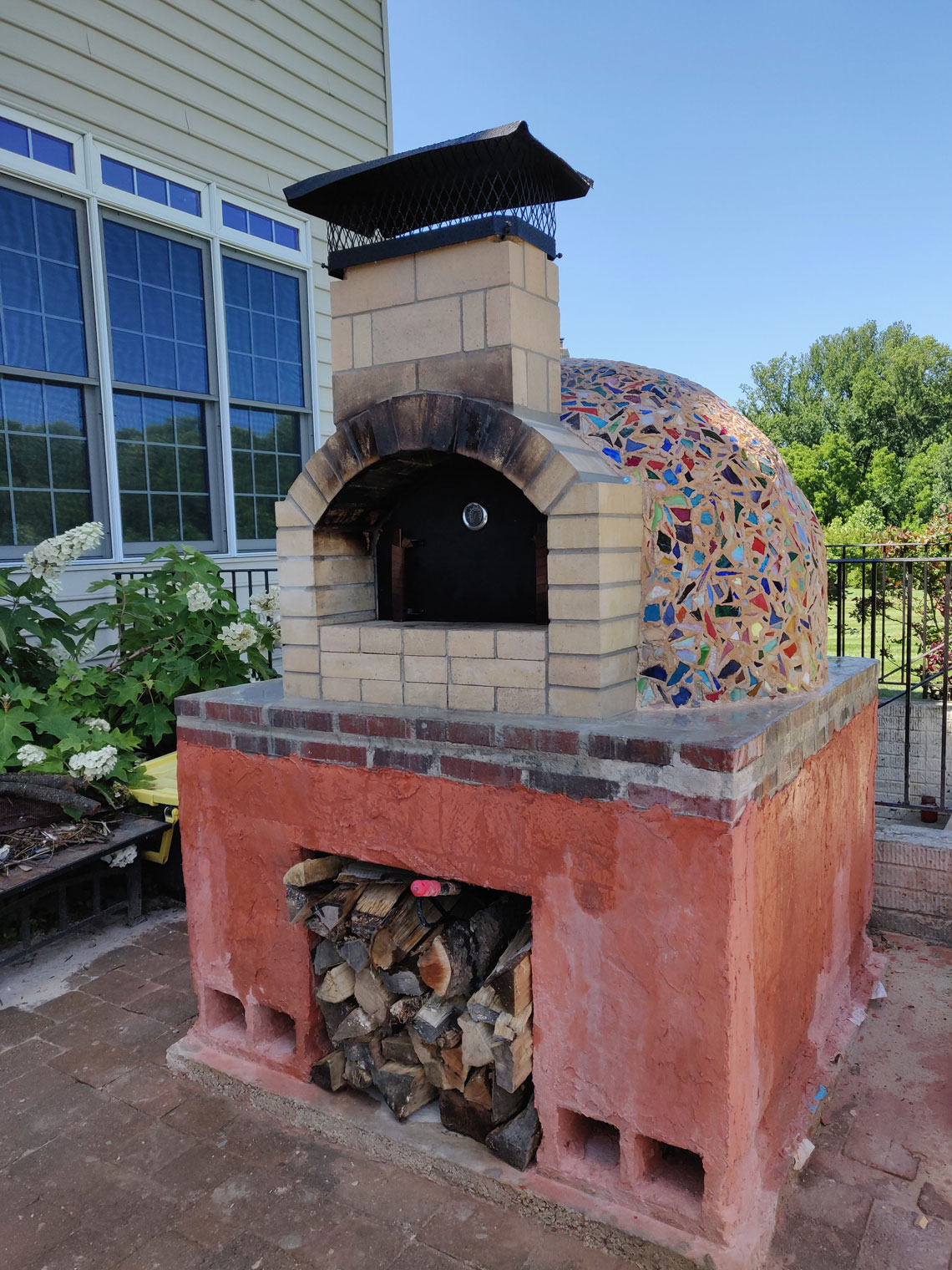

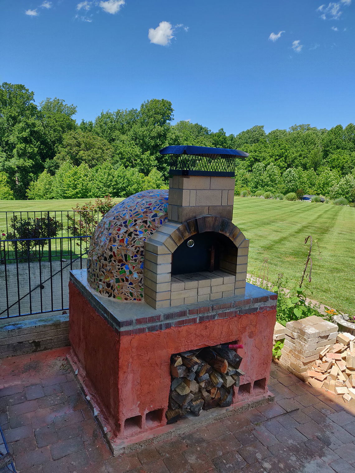

      The finished build:
      Click image for larger version  Name:	IMG_20190614_151728-(1).jpg Views:	1 Size:	510.1 KB ID:	414158
      Click image for larger version  Name:	IMG_20190614_151744.jpg Views:	1 Size:	393.8 KB ID:	414159
