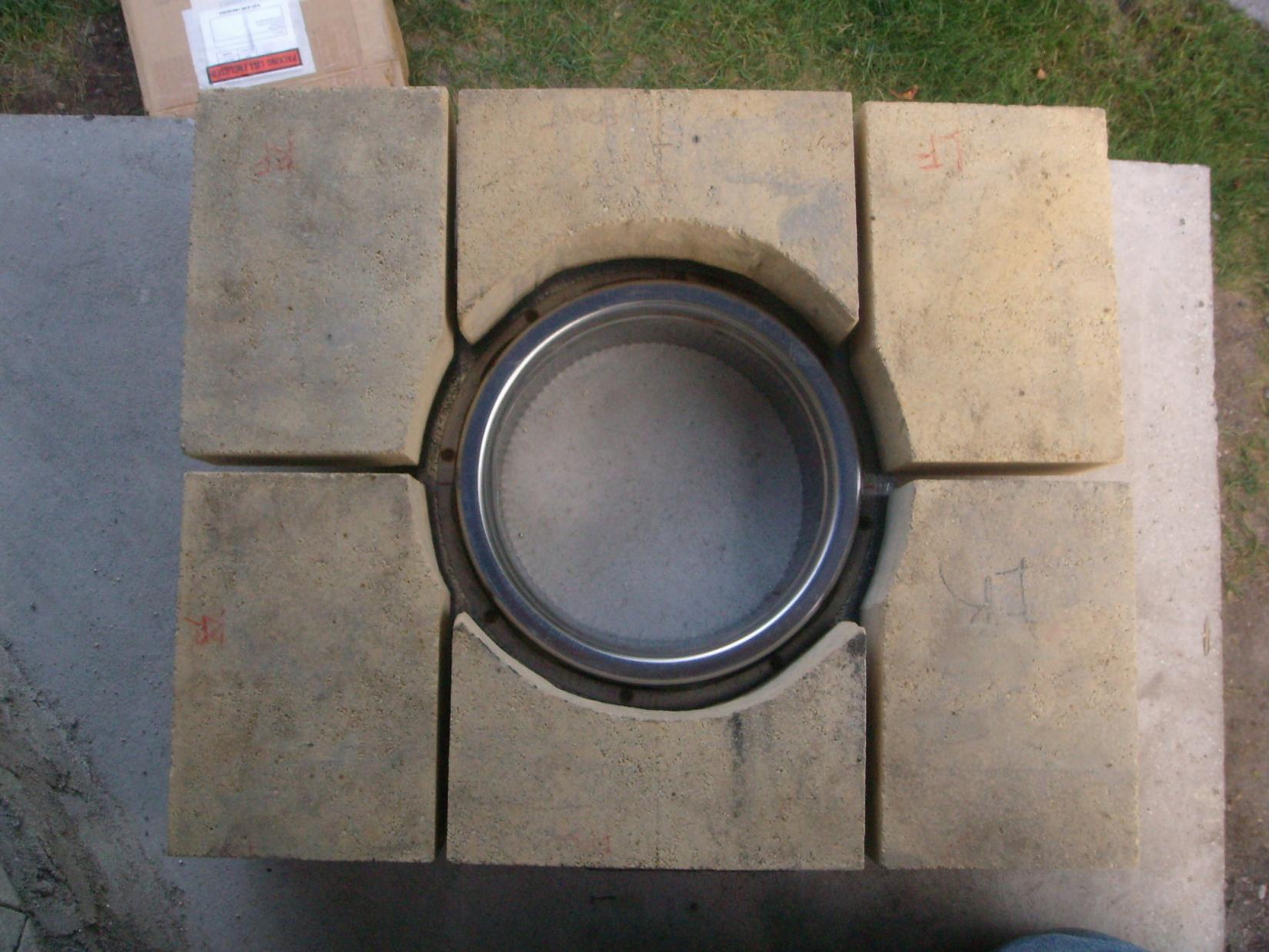

                        Thanks for the info. In the ratio, the first number 5-8 is the perlite, correct? And secondly, about how much am I looking for to buy? Just a ballpark figure, if I copied your technique.
                        Also, do you have your pipe secured at any other spot besides the anchor plate? Did you mortar bricks over top of it? It looks like you did not???

                        • #42
Name:	62B Cap Top 8.30.12.JPG
ID:	412195 Yes. I used 2 - 4cu ft bags, abt 10 bucks a bag ib 2012. There is a layer a brick on top of anchor plate, it shows in my pic log.

                          • #43
                            My anchor plate sits bolted to a layer of bricks, with a decorative "crown" around it that theoretically would allow me to unbolt and remove the plate if I ever needed to. My pipe goes up through my roof and gets additional support from the silicone boot/flashing that keeps the water out. We have two 3' sections of pipe with a cap on top.
