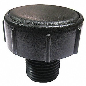

    Gulf and I used auto breather vents that are cheap, less that $10 at any auto parts store. they have a 1/2" male npt that you screw into a 1/2" pvc bushing that we set in the stucco.. Gulf added wire mess to his bushing to reinforce. These are placed at the apex of the dome.
      Click image for larger version  Name:	breather vent.jpg Views:	0 Size:	25.9 KB ID:	423345
      Oh nice. Just checked that out on your build, awesome. Does the pvc but against the ceramic blanket?

        No but it could, I had a couple inches of vcrete over ceramic blanket and an inch of stucco. I just let a channel from the ceramic blanket to the breather vent so any water that converts to steam can egress out.

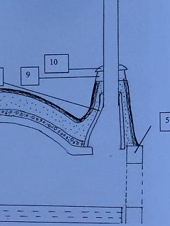

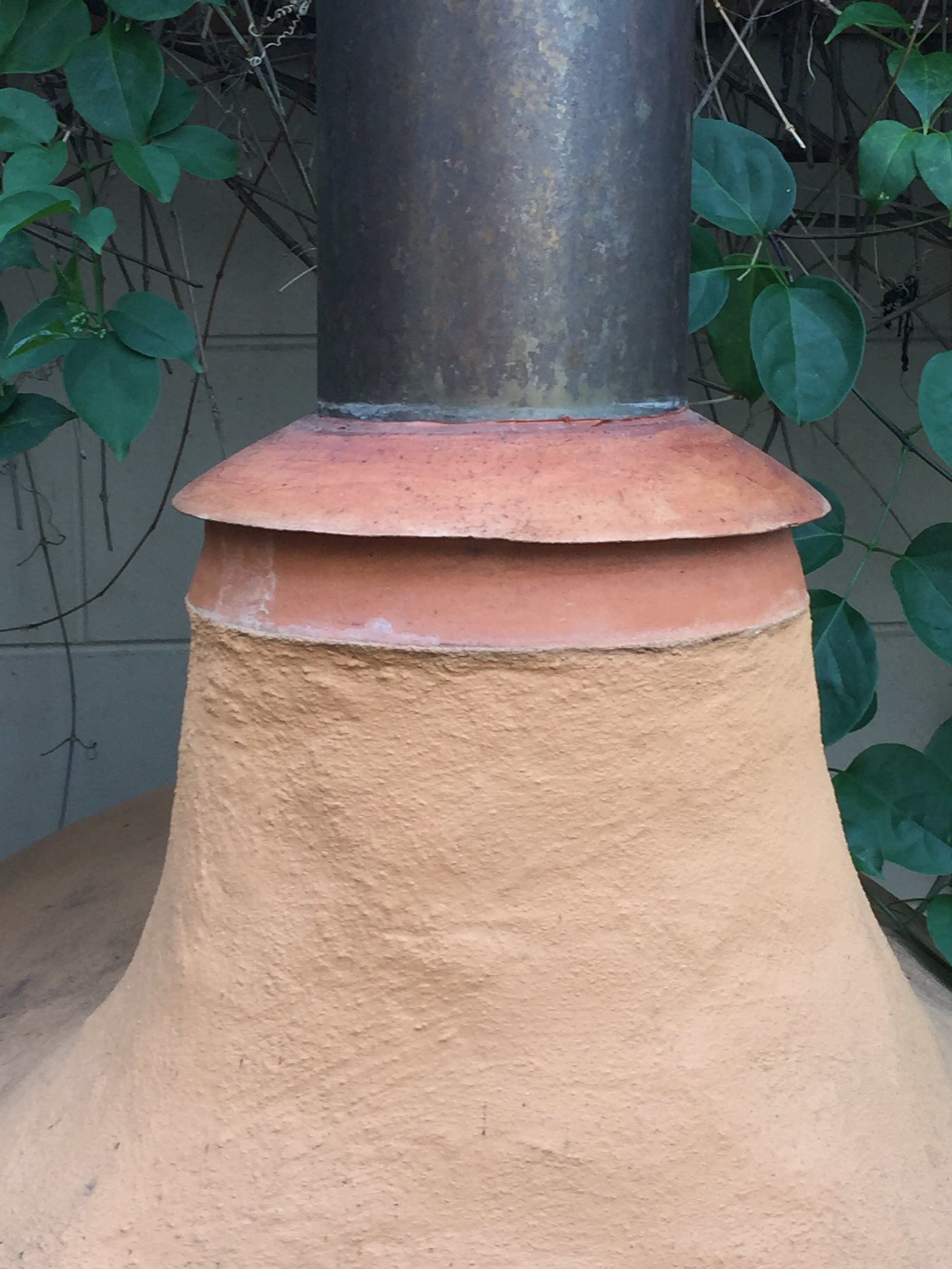

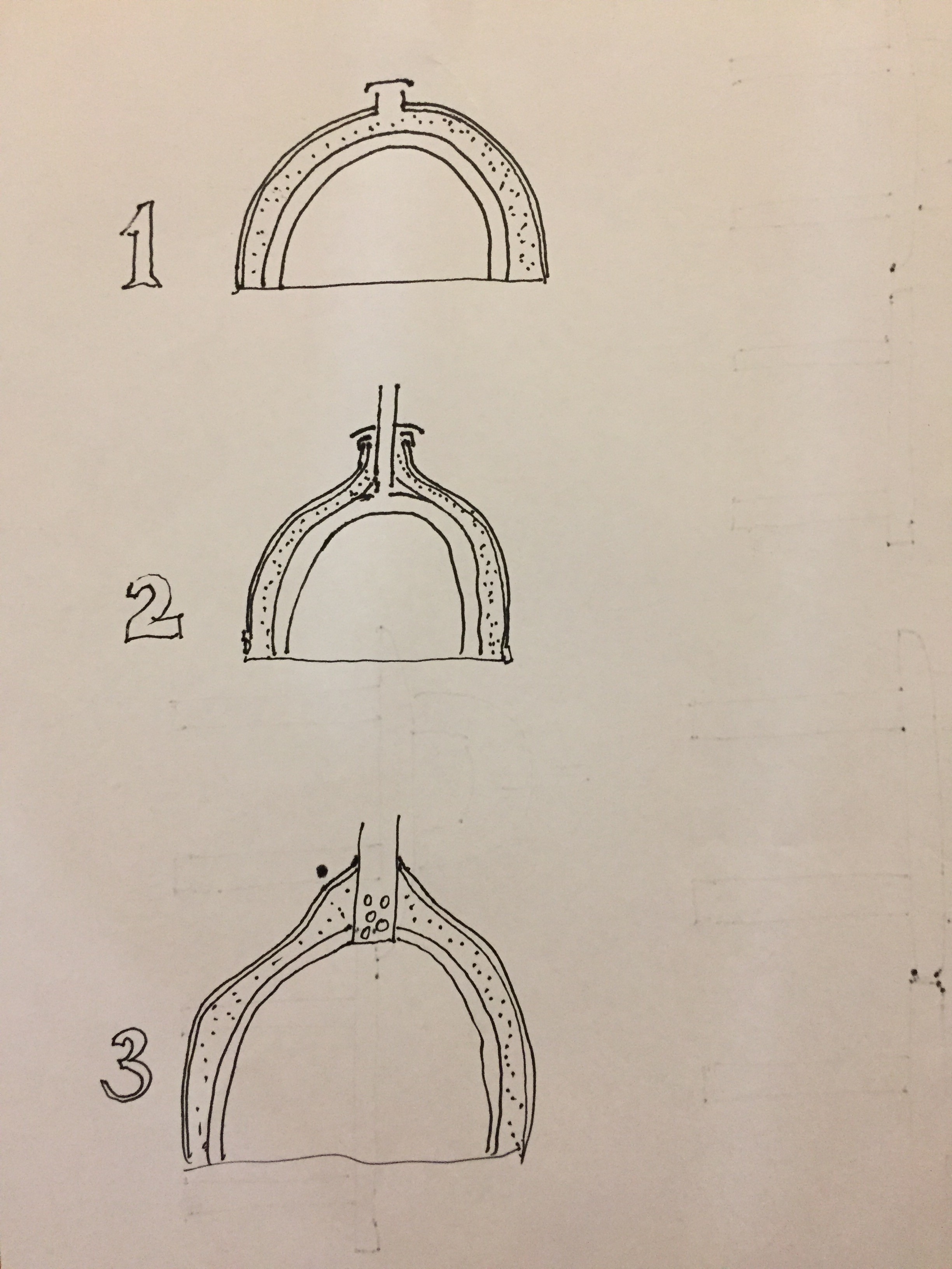

                As well as a vent at the apex of the dome (1) you could try this system (2) where the vent is incorporated around the flue pipe. There is a small space between the two caps 9 and 10 where moisture can pass. This has the added advantage of not having the render right up against the flue pipe with the resulting sealing and cracking problems there. It could also be possible to drill some holes in the flue pipe at its base so the vermicrete that surrounds it will allow the moisture to pass into the pipe (3)

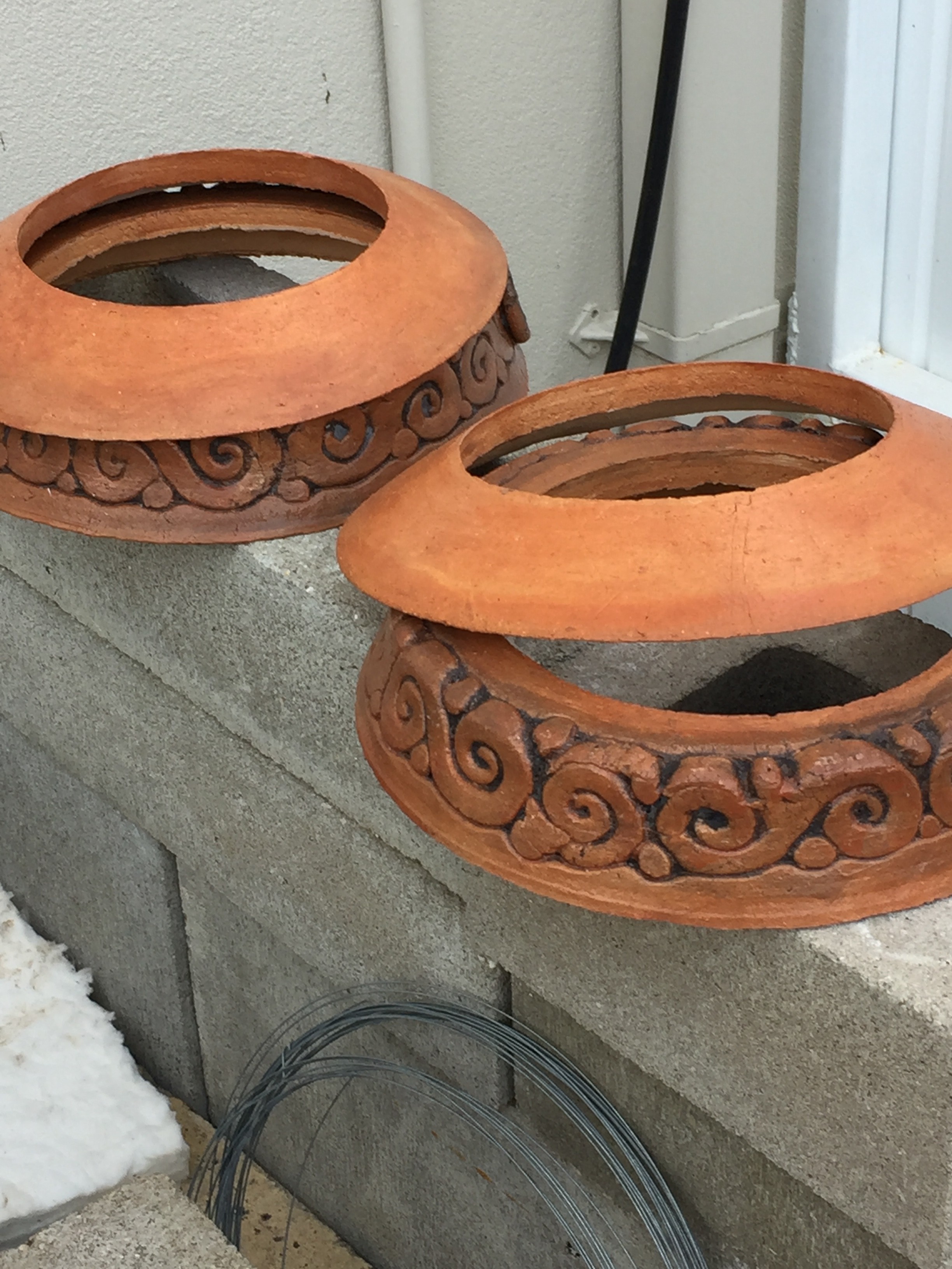

                  do you make/have made components 9 and 10 david s or buy them? what material?
                      Yes, I press mould them and fire them in my kiln
                      https://community.fornobravo.com/for...735#post394735
                      The same system could be fabricated in another material if you don't have access to clay, the skills and a kiln.
                      Click image for larger version  Name:	IMG_1079.jpg Views:	0 Size:	1.23 MB ID:	423568 Click image for larger version  Name:	IMG_1080.jpg Views:	0 Size:	980.3 KB ID:	423569
