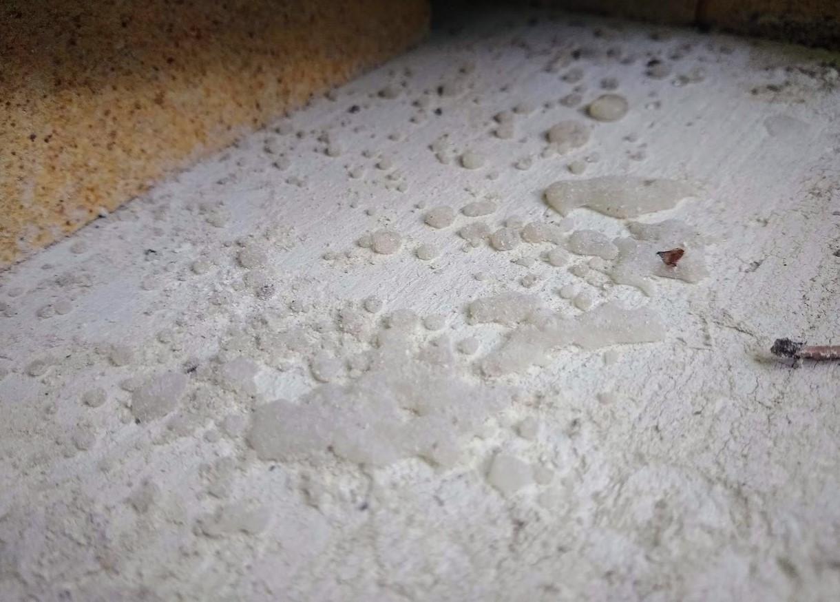

    As for the fiber board getting wet. This stuff I got from our sponsor sucks up water like a sponge. We had a little snaffu with the washing machine drain and flooded the garage floor. Of course I had some of the fiber board I was planning on using for my door. It nearly doubled in size. I then got some wet by mistake that had some bricks sitting on it... the bricks sunk into the board... I didn’t even get it that wet. It was mist from the wet saw. You can see why I’m hesitant to let it get very wet at all. The next time I’m in the States I will pick up some Red Guard to help seal around any exposed fiber board.
    Oh wow, I didn't realize it would do that. The board that I bought locally actually pools water so I didn't have to worry about that..

    Today I will do a small run and soak the crap out of them.... also, after they are set I will keep them moist. I’ve been trying to to use to much water to keep from getting my fiber board wet... it hates water.
    Let me know how it works for you, I imagine it can be pretty difficult to keep enough moisture in your brickwork in such a dry environment! I didn't worry too much about my board getting wet while doing my build knowing it would dry out during the curing fires.
