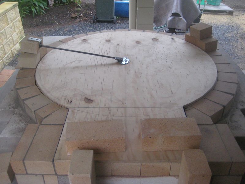

    Well, got the floor laid out and cut. Overall, pretty satisfied. Im not thrilled about the couple little floor pieces, but they really arent there to do anything but look good. Hope they stay in place. I might just put the first course brick that is next to the little pieces a bit closer so they cant fall. Probably will go with 1/3 bricks on the second and go back to halves to keep the joints from lining up.
    Went out to the base today and checked it for level... ugggh! It is far from level. What can I use to float it out to take out the imperfections. I have some stucco laying around if that would work. Worst spot is probably 5/32... maybe a bit more. I should have my FB board on Saturday... hoping so.
    Tomorrow I will make my IT and then build the inner arch form. Feels good to get something accomplished.

    Thank you Utah and Gulf for the rapid response... you just saved me a tremendous amount of time and grief. Before reading your posts I decided to make a jig to cut them all... ran a test of 6 brick and the results were substandard. Too much deflection on the blade cutting that little sliver. Tried it with a 8” blade and a 10” blade. No good.
    Before I took apart the floor I ran a peel over them several times and it didn’t catch at all. Man, I just have to have that herringbone pattern so I’ll just take the time to do the best I can with what I have. Might make some minor cuts as it gets out of whack... I will start in the middle and work my way out paying particular attention that they look good at the entry too. Guess I’m gonna have to let that perfectionist thing go a little or I will drive myself crazy.
    Also the floor will sit on the board that our hosts, Forno Bravo sells. Gotta throw ‘em a bone as it were. I should have the board next week as I’m making a trip to my Yuma mail box... need to make a decision on mortar soon too. Probably home brew as I think I can get the lime and fire clay in AZ too. If not, I’ll have to bite the bullet and go the Heatstop route.

    Thank you Utah for the tips on the IT... Thinking it will work out awesome... was thinking of sacrificing one fire brick and just attach the swivel directly to that and replace that brick with a good one.
    So, been trying to lay out the floor and it just isn’t working out... the further out I go the worse they fit together. Finally figured out that nearly every brick is out of square on one end... some as much as 1/16”. Only one end. The long sides and the other end are square. I’m going to try cutting an 1/8” off every bad end and try again... also found that the bricks are slightly convex on one side and concave on the other. I will put the concave side down for stability.
