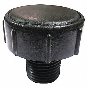

                          Seriously consider a dome vent at the apex of the dome in the stucco. so any moisture that converts to steam has an egress point .

                            This is the 1st time I heard of a adding a dome vent. I think I saw something in your pictures, and I wondered what that was. Now I get it. It's allowing moisture to escape the bricks and egress thru the stucco. So in general, I just add a hole in the top of stucco to let moisture escape? Q1) Anyplace you can point me to a size or type of a vent for this purpose? Is it as simple as a metal pipe? If you can point me to a thread on this, would appreciate that.

                              The vent that Gulf and I used are called breather vents and they are cheap, less than $10 at any auto parts store, the ones we used have a 1/2" male npt and a 1/2" female PVC bushing that is set in the stucco at the apex of the dome. Gulf added some wire mesh around his bushing for extra strength and surface bonding area. Looks like you golden with the building inspector.

                              Click image for larger version  Name:	breather vent.jpg Views:	0 Size:	25.9 KB ID:	424711

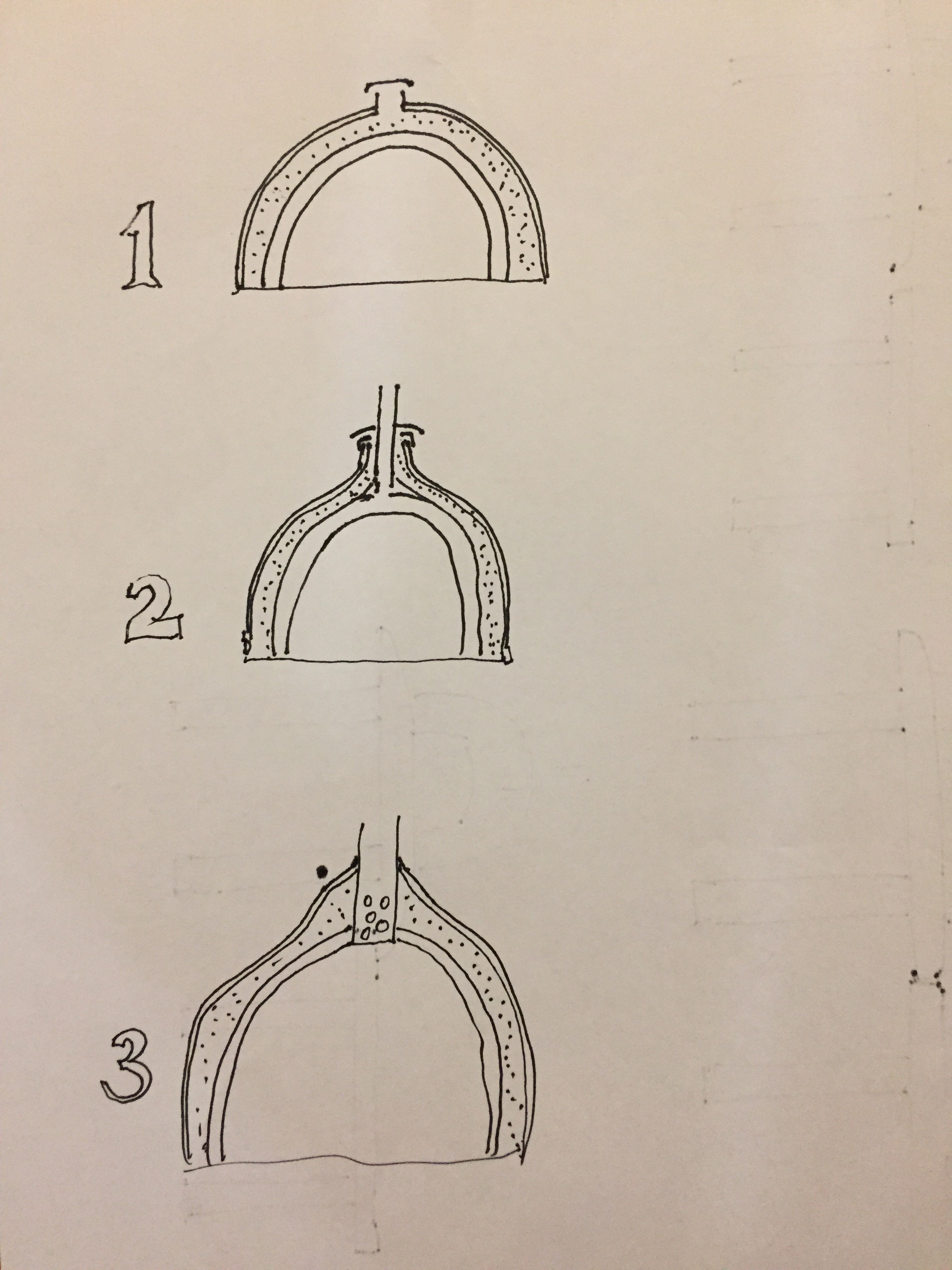

                                Here are a couple of alternative methods of venting the insulation space.
