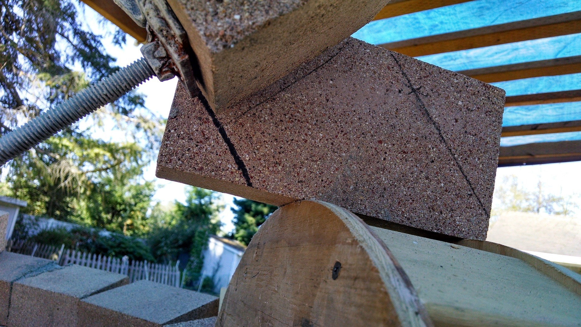

        here's a pic of my IT that now learning may not be OK to use as the brick C/L is not in the direct plane of the pivot, as it's off by 1/2 brick too low. Considering options as I;'m not with a welder to make a rod/tool to move the brick higher.

            First, you should not have to bevel the bottoms of the brick, the IT sets the angle so the brick face is perpendicular to the pivot point. On the IT, you need to correct where the centerline along the IT rod from the pivot point to the center of the brick. This ensures that the face of the brick is at 90 degrees to the center of the oven. The error by not doing this is cumulative through each course and by time you reach the upper courses the dome is out of wack. There are several "non weld" ITs out on the forum done with the correct orientation, just look around.

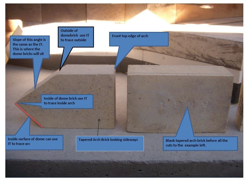

            You need to step back and get the arch bricks set up, marked, and cut before you go higher. A tapered inner arch, you start with the Top Dead Center Brick and work down each side of TDC, each brick is unique and cuts are skewed, and set by an IT. The pivot point of the IT should be at floor elevation for you will have to make dome radius adjustments for the dome to meet the arch correctly. Those two first course arch bricks need the 90s cut off along the ID radius of the dome.
            Click image for larger version  Name:	tapered arch.JPG Views:	8 Size:	86.6 KB ID:	422919

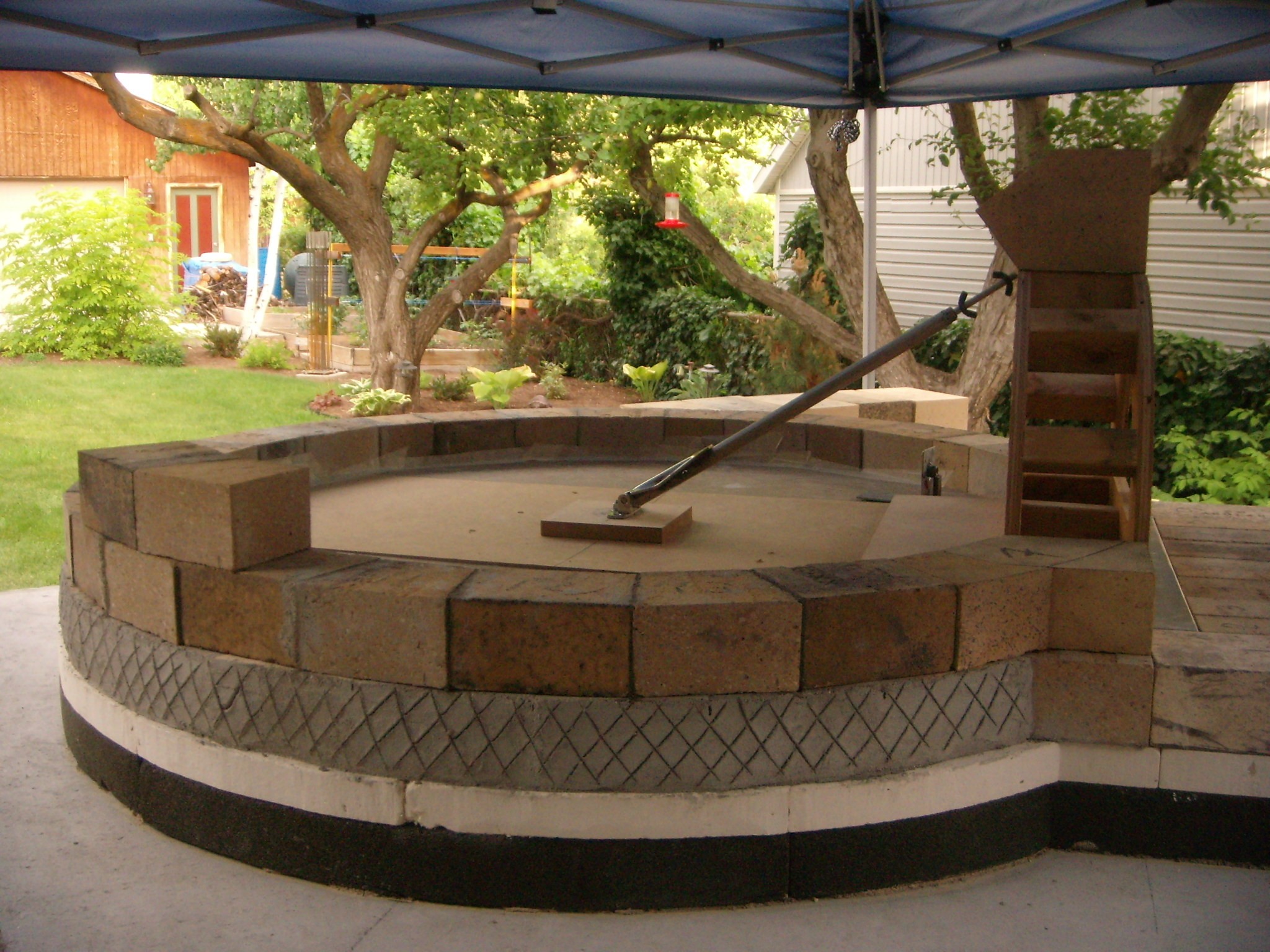

                  Much better on the IT, this should work. As Jr mentioned, you need to check TDC. I think your arch form is too far in, based the bottom arch form not lining up with inside diameter of the dome. This would be that 90 degree angle that is on the upper right corner of pic 3 that when you match the arch form it is not lining up with the inside ID of the dome. This affects how the tapered arch aligns.
                  Click image for larger version  Name:	32G Inner Arch 6.15.12.JPG Views:	0 Size:	634.0 KB ID:	422956
                  (My IT was raised, should of been at floor level) but notice how the bottom of the arch form aligns with the ID of the dome. This is where the arch form needs to be placed. The bottom arch brick should follow the ID rather than have a 90 degree angle, then line up the form.

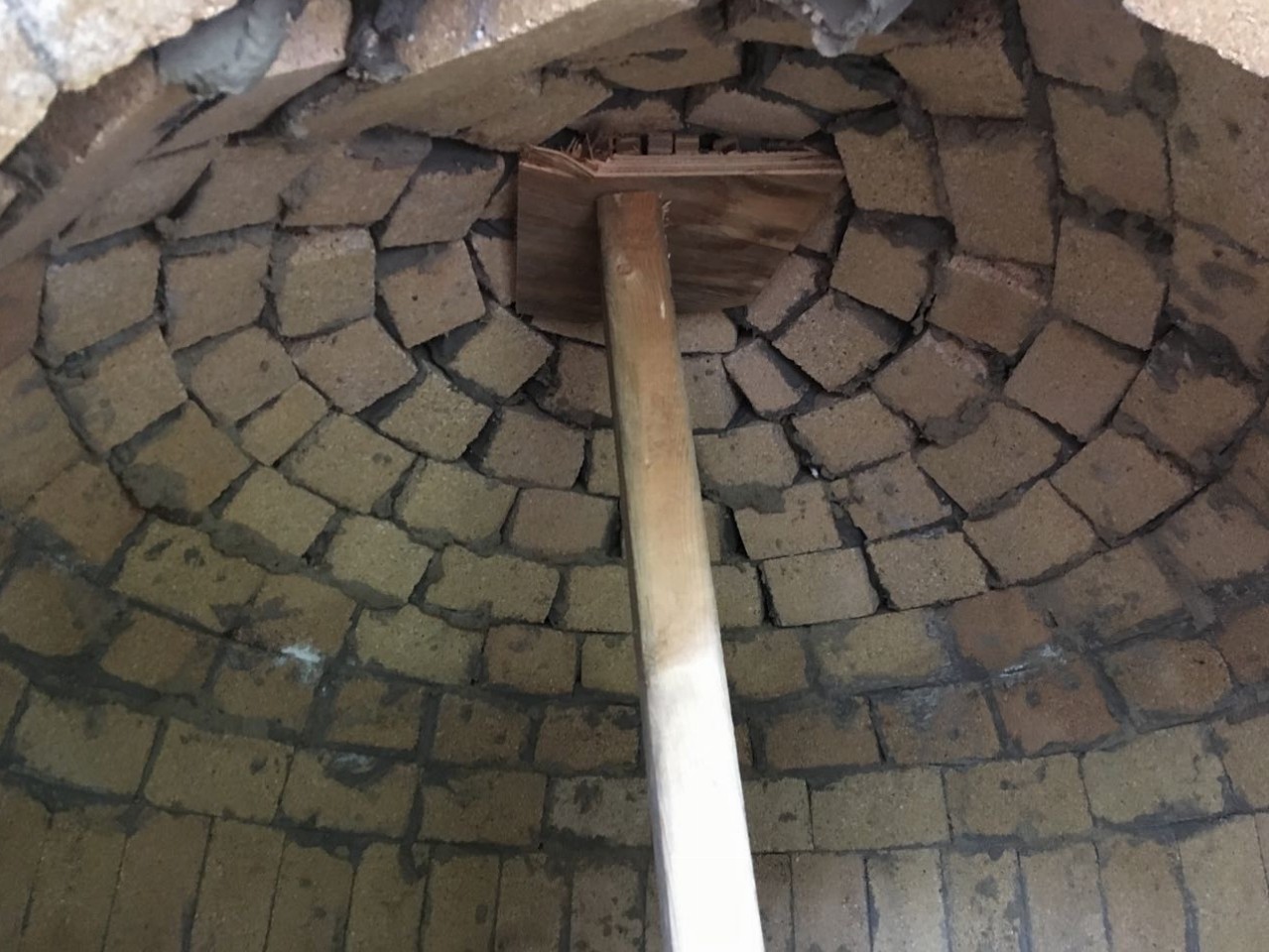

                        Yes, I did my best to eliminate the internal vee and minimize exposure of mortar to direct fire. I did this by beveling the sides so that the internal surfaces fit pretty tight and left large gaps on the rear that I filled with mortar. I think the second pic shows this pretty well. I didn't just bevel the inner edge but went all the way back as that worked best with my angle jig setup. I did not taper bricks to eliminate gaps in the rear and would not do so if I built again.

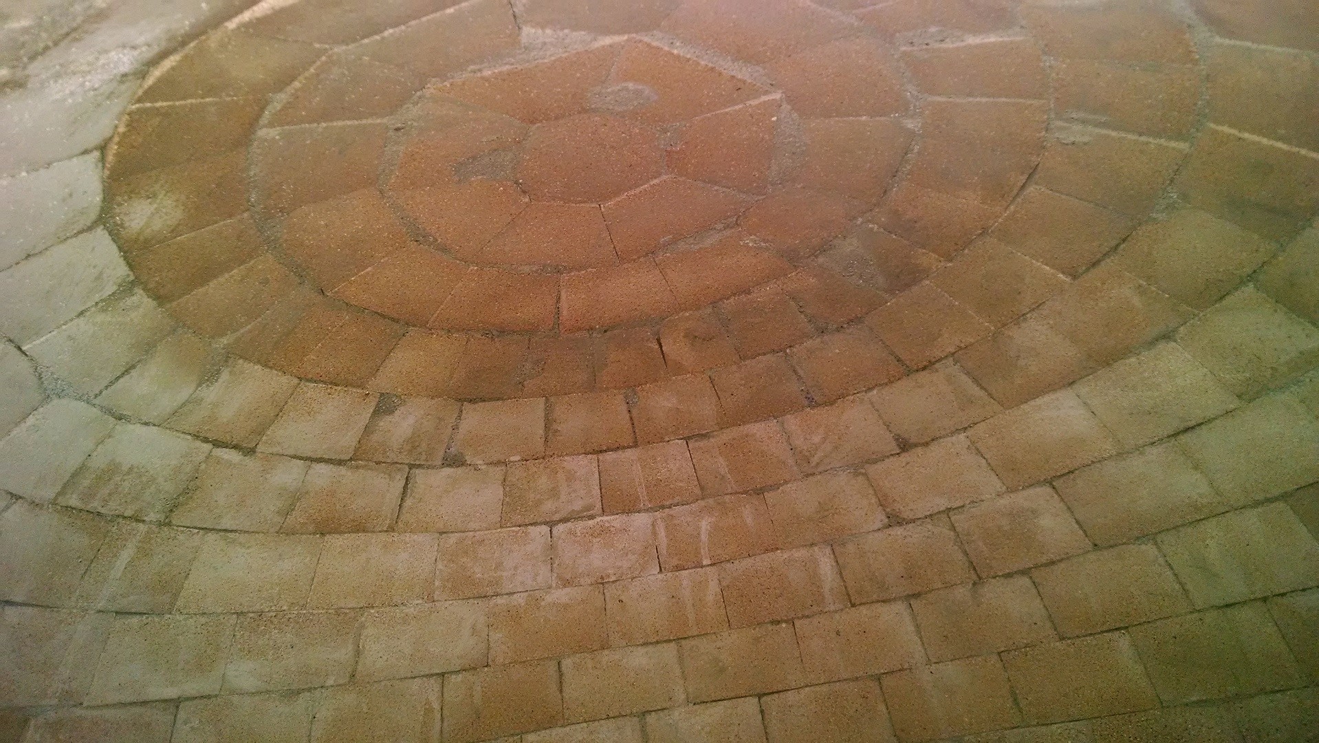

                                The Inverted Vs get larger and more pronounce as you move up and the diameter of the oven decreases. Here is what you will see if not adjusted. Click image for larger version
Name:	inverted v example.jpg
