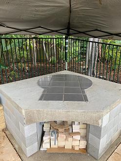

        Photos attached of current status, the hearth is laid and now collecting everything for the next stage.

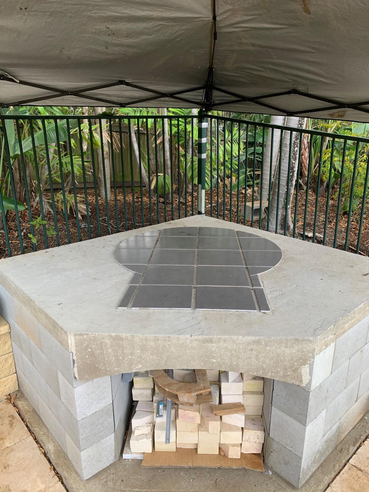

                          I found a box of unused ceramic tile from a bathroom upgrade so have stuck those to the hearth and drilled 12mm holes through the hearth for water drainage.

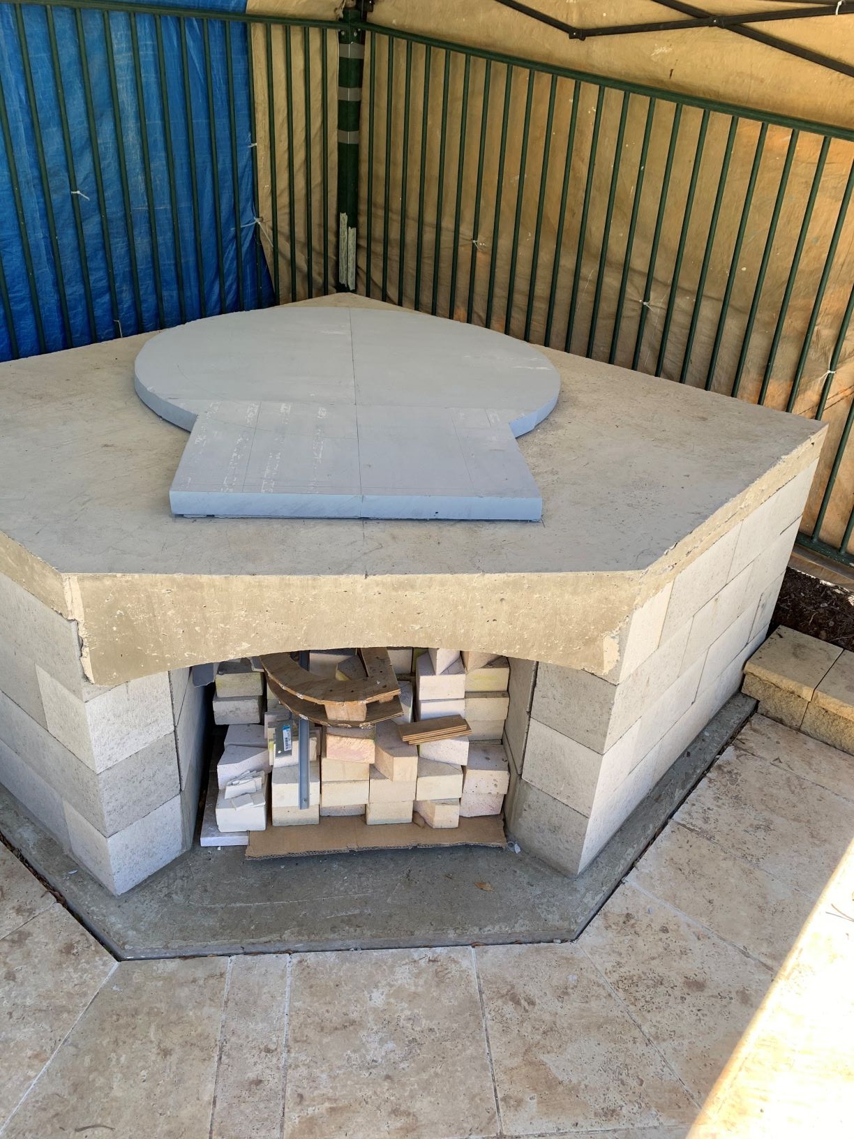

                          One layer of 50mm Cascil sheet for under oven insulation, I went for maximum usage of these sheets so my floor runs to the extent of the insulation beneath.

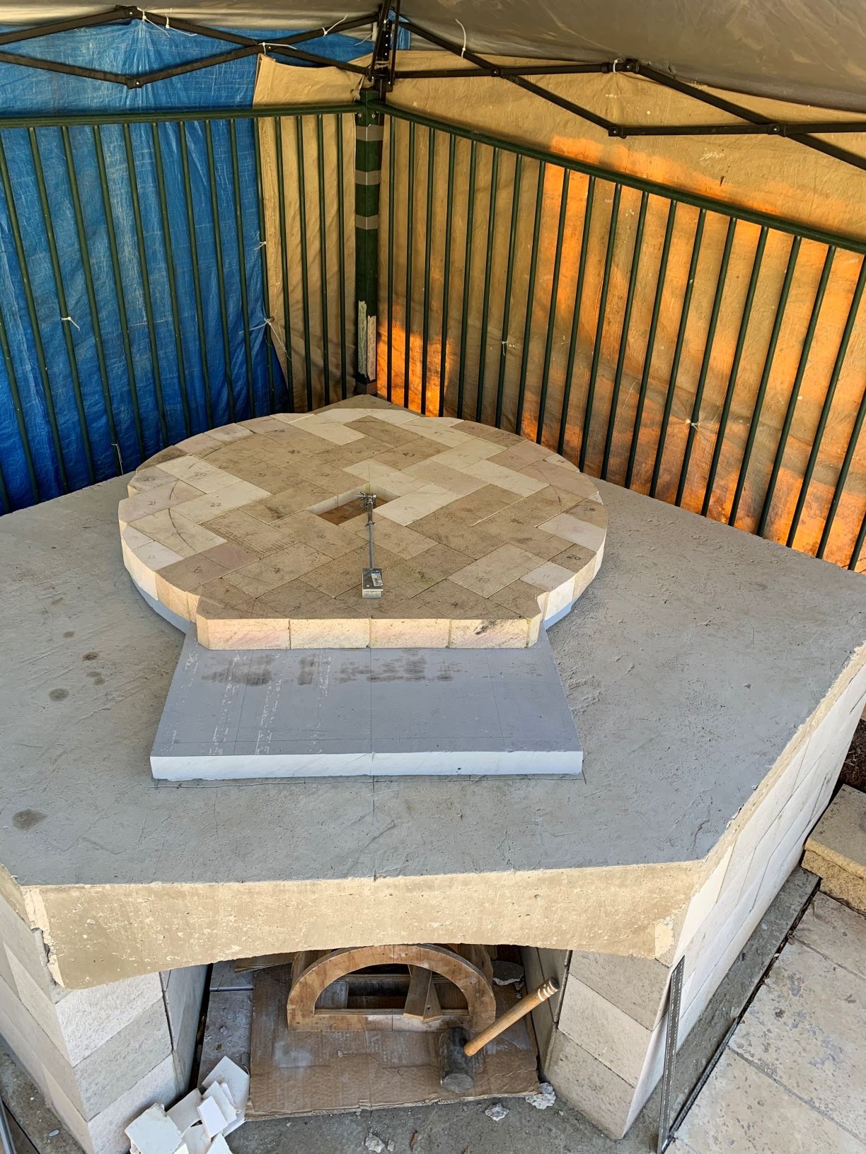

                          Assembled the floor in a herringbone pattern making sure I didn't have any of those small of cuts at the opening of the oven.
                          As I am constructing the dome header bricks directly on the oven floor, I did not worry about having a complete circular base, there are some small fillers missing that I am just going to "Mud" over with some homebrew.
                          I have mortored in the floor with a homebrew using the 3:1:1:1 ratio which went well but I didn't think that it went off rapidly at all. Actually even though I did wet the brick edges down slightly, I didn't think it stuck really well? I did check this morning and appears to be hard and cemented in place.
