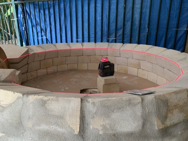

    My intent was to use my laser level and shoot a line around the inside of the dome, lined up to the top of the inside face and make sure all my bricks line up with that.
    Do you think that will prevent the Droop?

      Sounds like a great way of keeping your courses level.

        It certainly should. With the laser to set brick elevation and the IT to set the brick with the proper orientation, yes, it should turn out splendidly.

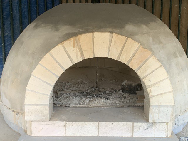

              A delayed post here as have had lots of interruptions.
              decided to trim up the arch bricks and finish that off.
              I had to change the Top brick and although the arch is a bit rough I figure it won’t really be seen, some of the gaps are a bit big.
              Mortared in course 5 but got lost again at the arch to dome transition. Left it for a few days and then final bit the bullet and cut it by eye, was happy with that.
              As usual was racing daylight by the time I finished but thought I would put the level on to check everything. I was sure it would all be ok but no, I could see the “Droop”. Luckily I had time to reset and check again.
              I think I will set the laser for each course from here on.

                That looks fantastic! I have no idea why I did not think of using a laser. (Considering I own one!)

                  bloody neat work for an angle grinder. Well done.

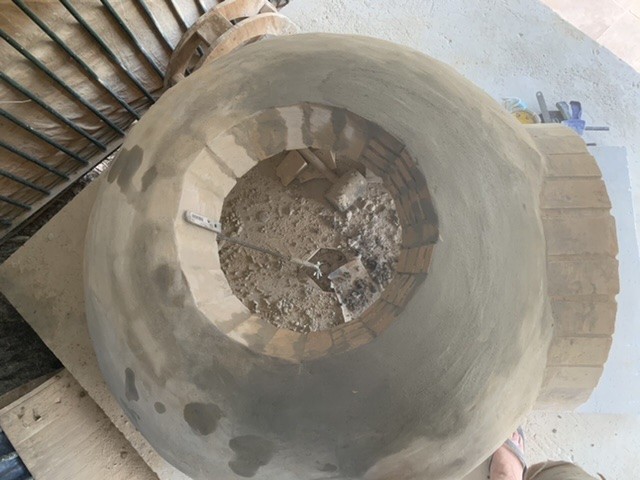

                    Hi All,
                    Well I obviously not paying enough attention on the last course and let my arch intersecting brick run out.
                    I did recognise I was getting droop using the laser and I corrected for height but didn’t correct to keep it round.
                    Hence when trying to close this last course and clear the arch I noticed the arch intersecting brick was way out.
                    I really don’t feel like cutting that part of the course out and doing it again, I think I will mortar in a packing wedge and move on, maybe when I am finished I might take to it with a grinder to disguise any imperfections? ( of which there are a few).
                    Mortar is my friend, right?
                    By the way Dave, I cut all the arch bricks with a 7” circular saw fitted with a masonry blade which although it did the job, was a bit rough, I bought a wet saw the next weekend so have cutting everything course 4 and above with that.
                    Still not getting the results I want but that is the angles playing with my mind, Don’t overthink it!!!!!

                    • Delta
                      • May 2013
                      • 65
                      #55
                      Photos now hopefully

                        Good of you to catch the "droop" early. In any event, it will be near impossible to see so all good!

                          Based on what Delta described, I think it may have been a slight elongation of the dome "beaver tail". That can be caused by the inner arch being placed or cut just a little too far forward. Most domes end up with a little of both the beaver tail and the dreaded droop. The beaver tail can be the cause of the droop. The fix for both are just mortar and brick. I used the laser myself to correct the droop across the inner arch. It worked just fine for me. I happened to have had one so I used it. But, for future builders following the build, there are otther methods with simple tools to get the same results. If you have it, use it. But, no need to go out and buy one. The olnly reason I'm adding this is, after my build, someone went out and bought the wrong type of laser level. Of course it was useless for the project.
                          It's looking might fine Delta, I'm looking forward to you closing the dome. That's a biggie!
