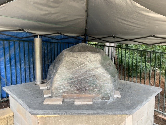

    Yep, bit the bullet and did my first layer of render today. I used a 4:1:1 mixture. Now just leaving it sit and dry for the next couple of days - or even week and a bit. Depends how busy I get with my return to work.
    Have also been very careful not to get the oven wet. I decided to do my curing fires once my perlite layers went on.
    Stupid me the, other night forgot to cover it, luckily we only got a little bit of rain, so my insulation layer was a bit damp in the morning. Nothing that our hot and dry QLD weather did not fix up.

      I find it is better to eliminate the water from the oven after insulation, but before rendering the outer shell. This way moisture can escape far easier. However it then presents the problem of the dry insulation sucking the water from the render layer leaving it with insufficient water for the hydration process. My solution is to wrap the whole oven in cling wrap after the render layer (I do it in one single layer to save time) . Sponge finish to remove any tooling marks. After 24 hrs you can see beads of moisture under the cling wrap so it works pretty well. Leave it for a week for enhanced strength before unwrapping. (forget this advice if you're building a dog kennel style).
      Bondcrete is ok, but a dedicated acrylic fortifier like Lanko Bondit 752 added in same quantity as water to the render mix is better.
      I like to add a layer of 10:1 vermicrete over the blanket as rendering directly on to the blanket is difficult because it's a bit springy.
      Also, don't render directly against the flue pipe or you're likely to get cracks there that can provide water entry. Wrap some cardboard around the pipe so when you remove it there's around a 5 mm gap that you can fill with high temp silicon.

          I rendered straight onto the blanket, didn’t go to bad, only did a thin layer as I planned on doing another two layer on top to get the strength.
          I didn’t keep it moist as I thought I would do that with next couple of layers.
          I have rendered up the side if the chimney but not on top of it where the flue penetrates as I thought I might cap it with a copper or stainless top?
          Hatzi and I are both wondering whether we should be including any AR fibres in the Render?

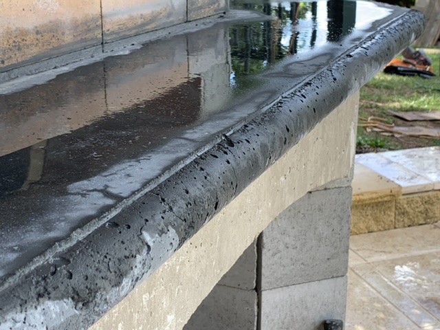

                Have decided to do a black polished countertop with a bullnose edge.
                Have formed up and sealed the hearth, just got to tie the reo in and can then pour.
                I am just going to use a 4:1:1 of builders loam, cement and lime, will add some bondcrete and the AR fibres I found this morning and a jet black cement colour additive.
                Have got a shovel full of white marble stones which I will smash up and push down into the countertop top and then hope to polish up when cured.
                I figure if it ends up looking like sh*t, then I can just lay tiles over it instead.

                  I decided to do th countertop top today and changed my mind and used high strength 55kpa premix, it goes off quick don’t it!
                  Anyway, happy enough with it, it looks black at the moment and will see how it polish’s up?
                  Can alway lay tiles if it’s no good.
                  Cheers.

                      So the countertop came out ok but I didn’t have enough time to pay attention to the bullnose which is what stands out like a third ball.
                      I got a sanding disc from All Prep Equipment to see what it comes up like, 50 grit and if I kept polishing I think it would look good but am happy with what I got, the white marble chips sank a bit to much so I can’t see them, oh well.
                      My real issue is that the bullnose needs a lot of filling.
                      Can it be filled and recovered, or should I cut the bullnose off and have square edge.
                      I think I will move on to get to a cooking stage and come back to the cosmetic decisions later.

                          Really looks good. The bullnose will be easy to fill/patch with plaster or thinset (or just Portland cement-without the gravel of course ). You might even consider painting it with a contrasting accent paint after filling. Yes, many of us continue to do "detail upgrades" for a long time after the first pizza.

                              Added them to the render regardless, seems to have worked ok.
                              I now have a furry dome which may help the final colour coat stick better?

                                You can fill pinholes and voids, then wait a few days and polish. When you are satisfied with your result coat it with a concrete or stone sealer, which will retain the wet look. I first started with an orbital sander fitted with wet and dry paper and adding a minimal amount of water. It did work, but now I have a purpose made angle grinder with variable speed, good electrical cut off and a central water feed with diamond pads in various grades which Velcro on and off. A pretty good machine. My Mum once sanded back a home built concrete shower base with wet and dry paper by hand. It looked pretty good, but hours of elbow grease.
