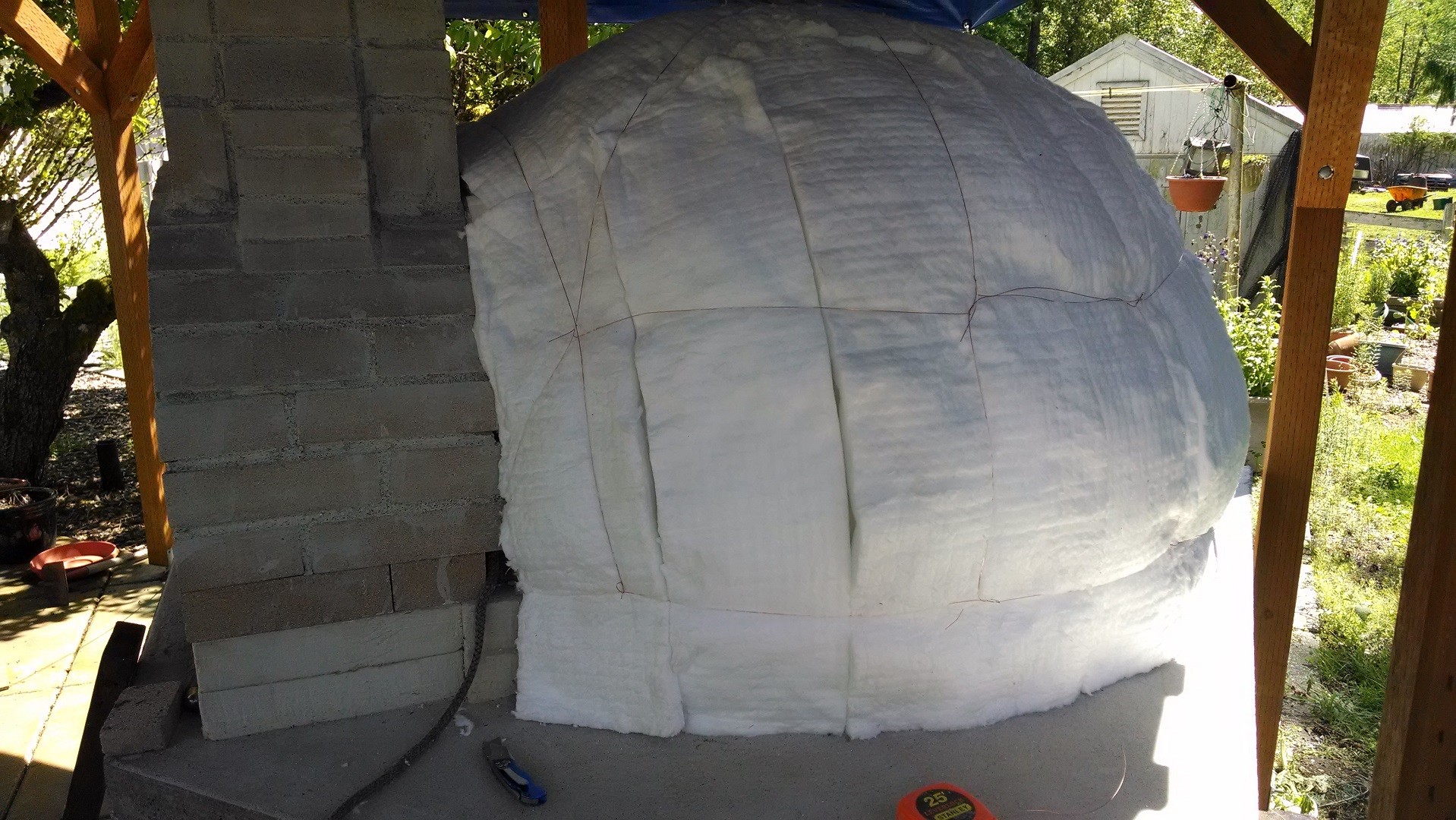

      Nice looking work! I built my chimney before I insulated. It might be easier working without the chimney and vent arches, but if they are there it will give you a good reference point as to where and how to trim the insulation around the arch. I ended up butting the insulation right up against the rear of the chimney. Click image for larger version

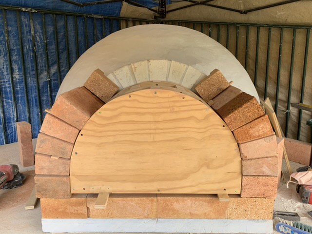

                    Anyway I have made up a new arch template and cut the lower few courses for the landing area out of red pressed commons.
                    Does this look like I’m on the right track?
                    Can I just bevel off the landing brick at 45 degrees where it meets the oven floor and fill it with insulation blanket as a heat break? I don’t have any stainless tube handy.

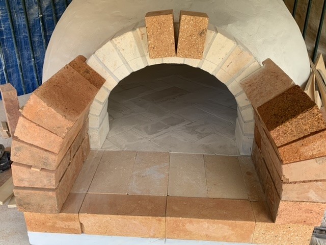

                              Pushed on and started the landing.
                              Just used some ceramic rope to make a Thermal Break, I think it will do.

                                Good to see some thermal breaks. It's an often overlooked feature of oven building. Will you use one on the landing/floor also?
