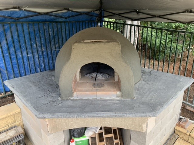

    Yep, bit the bullet and did my first layer of render today. I used a 4:1:1 mixture. Now just leaving it sit and dry for the next couple of days - or even week and a bit. Depends how busy I get with my return to work.
    Have also been very careful not to get the oven wet. I decided to do my curing fires once my perlite layers went on.
    Stupid me the, other night forgot to cover it, luckily we only got a little bit of rain, so my insulation layer was a bit damp in the morning. Nothing that our hot and dry QLD weather did not fix up.

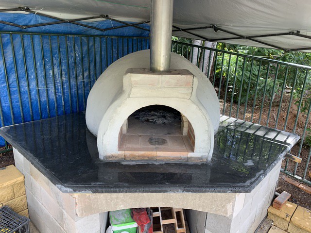

                Back to it after a week off.
                Have decided to do a black polished countertop with a bullnose edge.
                Have formed up and sealed the hearth, just got to tie the reo in and can then pour.
                I am just going to use a 4:1:1 of builders loam, cement and lime, will add some bondcrete and the AR fibres I found this morning and a jet black cement colour additive.
                Have got a shovel full of white marble stones which I will smash up and push down into the countertop top and then hope to polish up when cured.
                I figure if it ends up looking like sh*t, then I can just lay tiles over it instead.
                Once cured I will restart the rendering of the dome now I have fibres.
                Does anyone see an error in my ways?
                Cheers.

                  I decided to do th countertop top today and changed my mind and used high strength 55kpa premix, it goes off quick don’t it!
                  Anyway, happy enough with it, it looks black at the moment and will see how it polish’s up?
                  Can alway lay tiles if it’s no good.
                  Cheers.

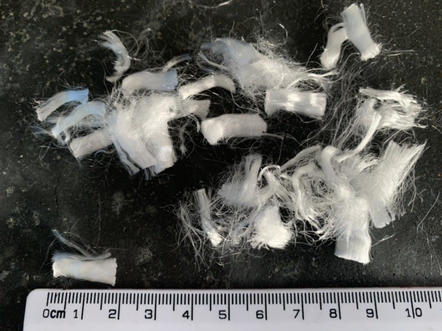

                    My apologies re fibres. I was getting you mixed up with Hatzi. I thought you were looking for a mix to render the outer shell, but now realise you were wanting the fibres for the countertop. I think Lyndons probably sold you the two pack plastic Sika fibres rather than the AR fibreglasss ones. They are good for a slab, but the AR fibres being shorter and softer are much better and easier to work for a rendered coat.
                    Pictured are the two pack plastic fibres (left pic) and the AR glass fibres (right pic) to show the difference. I used to use the plastic fibres in the render coat, but found I often had to pick out fibres that stuck out from the surface.

                      Thanks for that.
                      Attached is a photo of the fibres I have.
                      I didn’t put them in the countertop, late afternoon pour and a high MPA blend which goes of quick meant I was just to rushed.

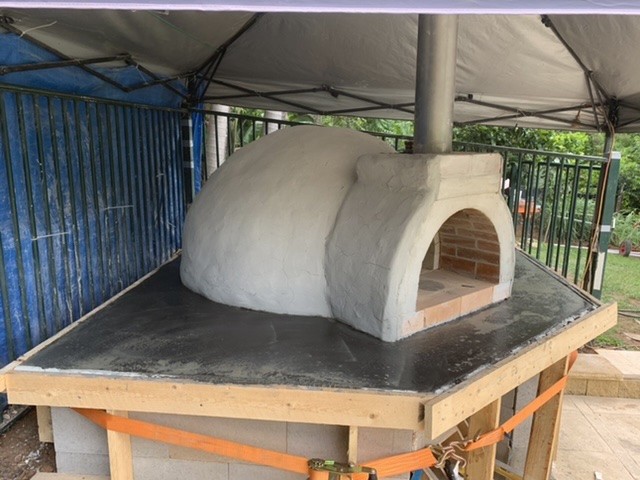

                      I intend to add them to the second render coat tomorrow along with some Lancrete 503?
                      So the countertop came out ok but I didn’t have enough time to pay attention to the bullnose which is what stands out like a third ball.
                      I got a sanding disc from All Prep Equipment to see what it comes up like, 50 grit and if I kept polishing I think it would look good but am happy with what I got, the white marble chips sank a bit to much so I can’t see them, oh well.
                      My real issue is that the bullnose needs a lot of filling.
                      Can it be filled and recovered, or should I cut the bullnose off and have square edge.
                      I think I will move on to get to a cooking stage and come back to the cosmetic decisions later.

                        • Really looks good. The bullnose will be easy to fill/patch with plaster or thinset (or just Portland cement-without the gravel of course ). You might even consider painting it with a contrasting accent paint after filling. Yes, many of us continue to do "detail upgrades" for a long time after the first pizza.

                            They are the polypropylene fibres which increase compressive strength but do little for flexural strength. They are the finer fibres I referred to in the two pack system, fibres in the brown bag, left hand pic. If you add them make sure you mix them around double the time you think as they clump and are a bit hard to disperse. They are also the same fibres you can add to a castable mix as burnout fibres leaving behind a network of mini pipes to help moisture escape without altering the density of the castable. Don't worry they won't reach anything like the 160C at which temp they melt, if you are adding them to the render for the outer shell. They also impart better workability to the render mix. You will find the stuff virtually sticks to your trowel.

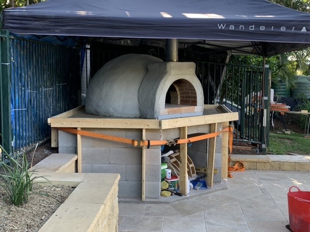

                            • Thanks Dave,
                              Added them to the render regardless, seems to have worked ok.
                              I now have a furry dome which may help the final colour coat stick better?
