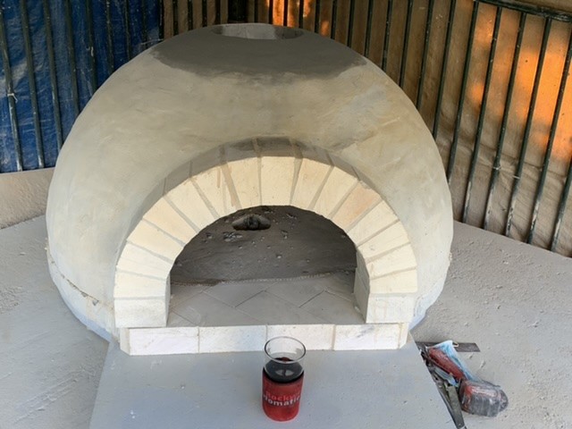

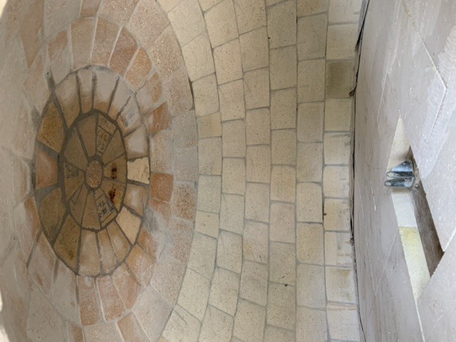

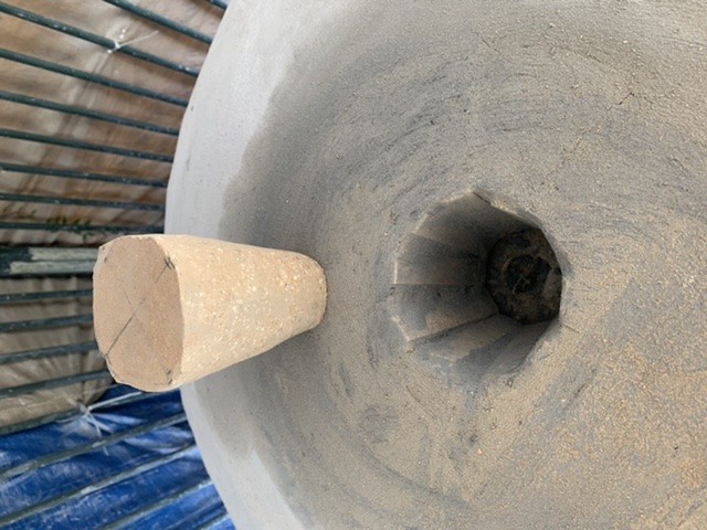

    Well the Xmas period has been productive, have managed to complete courses 9 & 10 & plug the dome, what a great feeling!
    Had some problems removing my wooden brick and chipped a couple of floor bricks, luckily I was able to lift and turn these over.
    At this stage I am quite pleased and eager to push on but in reality, maybe I should hurry up and slow down?
    I don’t know if I should attempt the chimney or the insulation next?
    Cheers

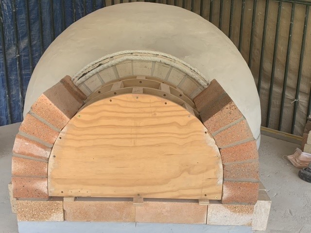

                    Anyway I have made up a new arch template and cut the lower few courses for the landing area out of red pressed commons.
                    Does this look like I’m on the right track?
                    Can I just bevel off the landing brick at 45 degrees where it meets the oven floor and fill it with insulation blanket as a heat break? I don’t have any stainless tube handy.

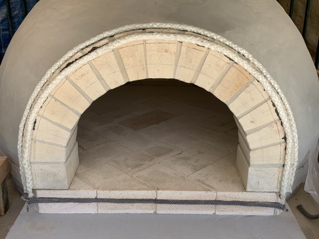

                              Pushed on and started the landing.
                              Just used some ceramic rope to make a Thermal Break, I think it will do.
                              • #75
                                Good to see some thermal breaks. It's an often overlooked feature of oven building. Will you use one on the landing/floor also?
