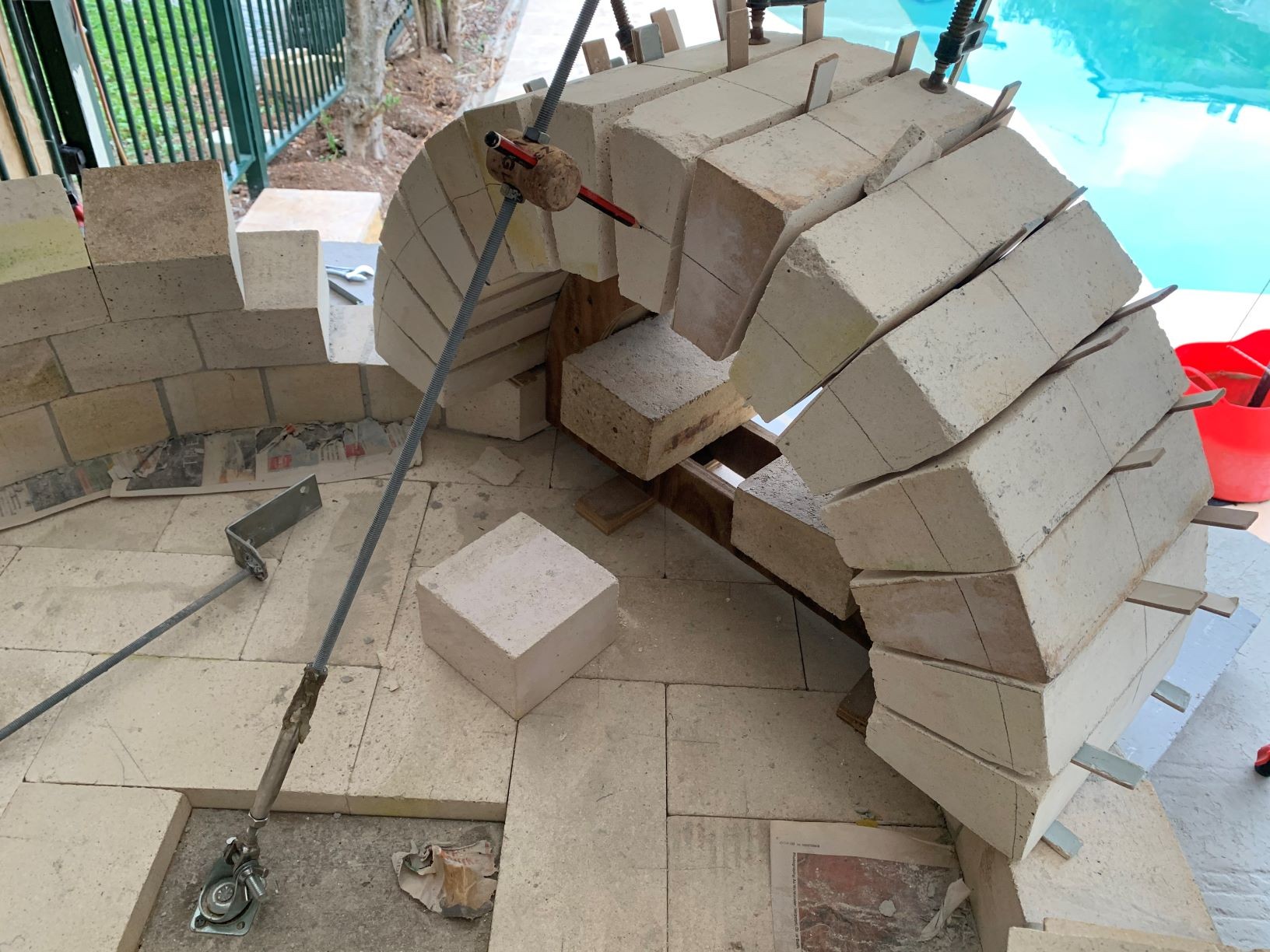

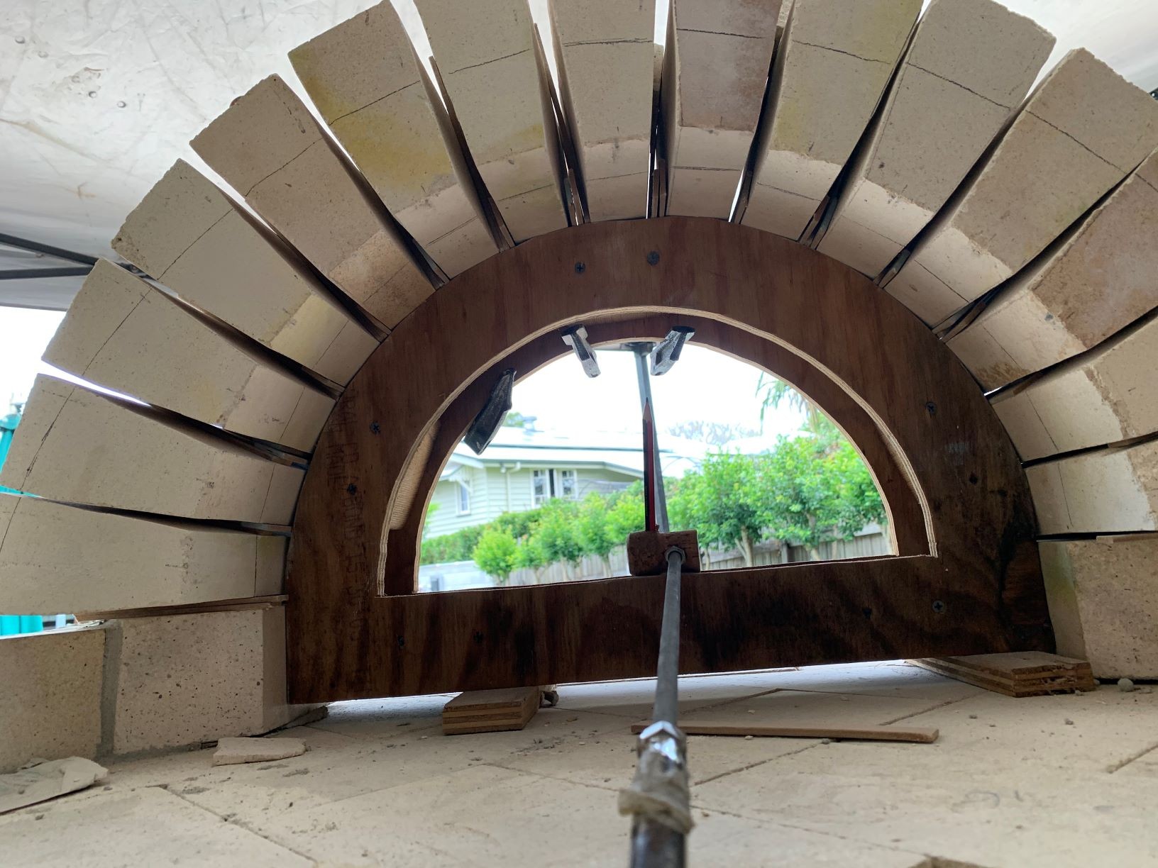

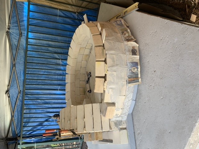

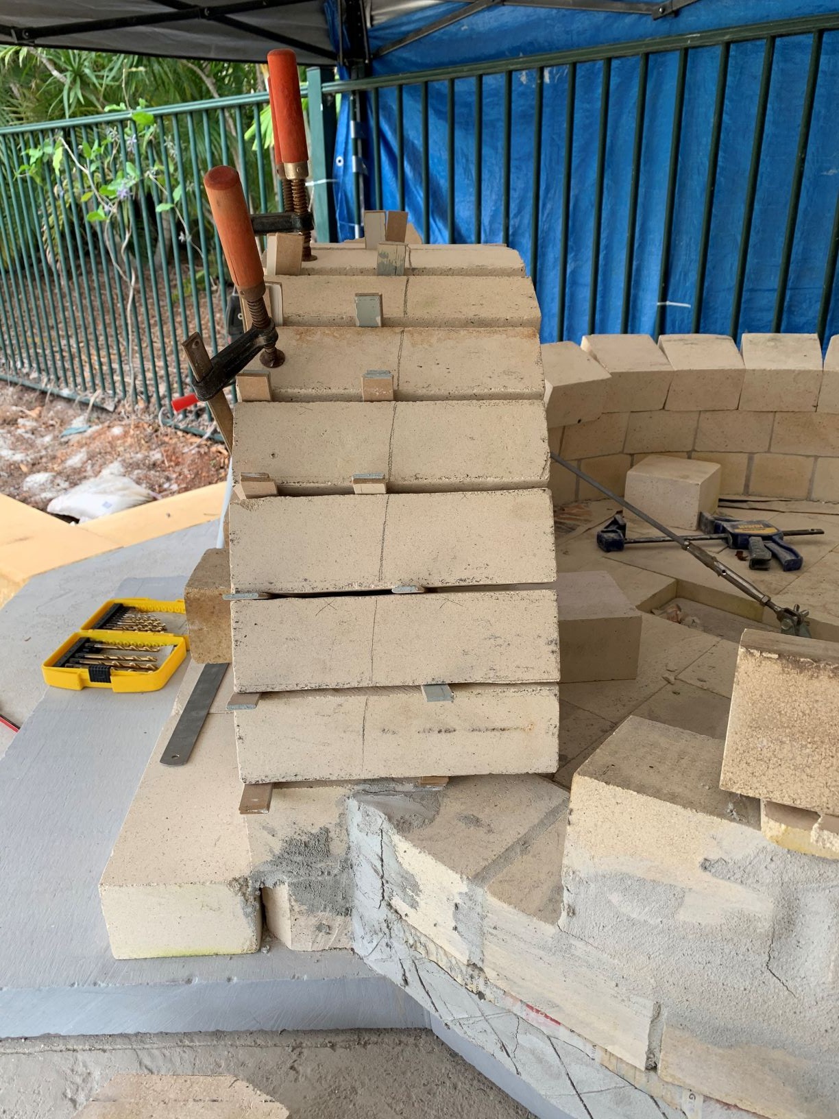

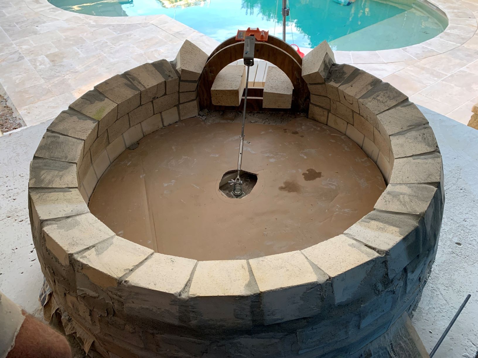

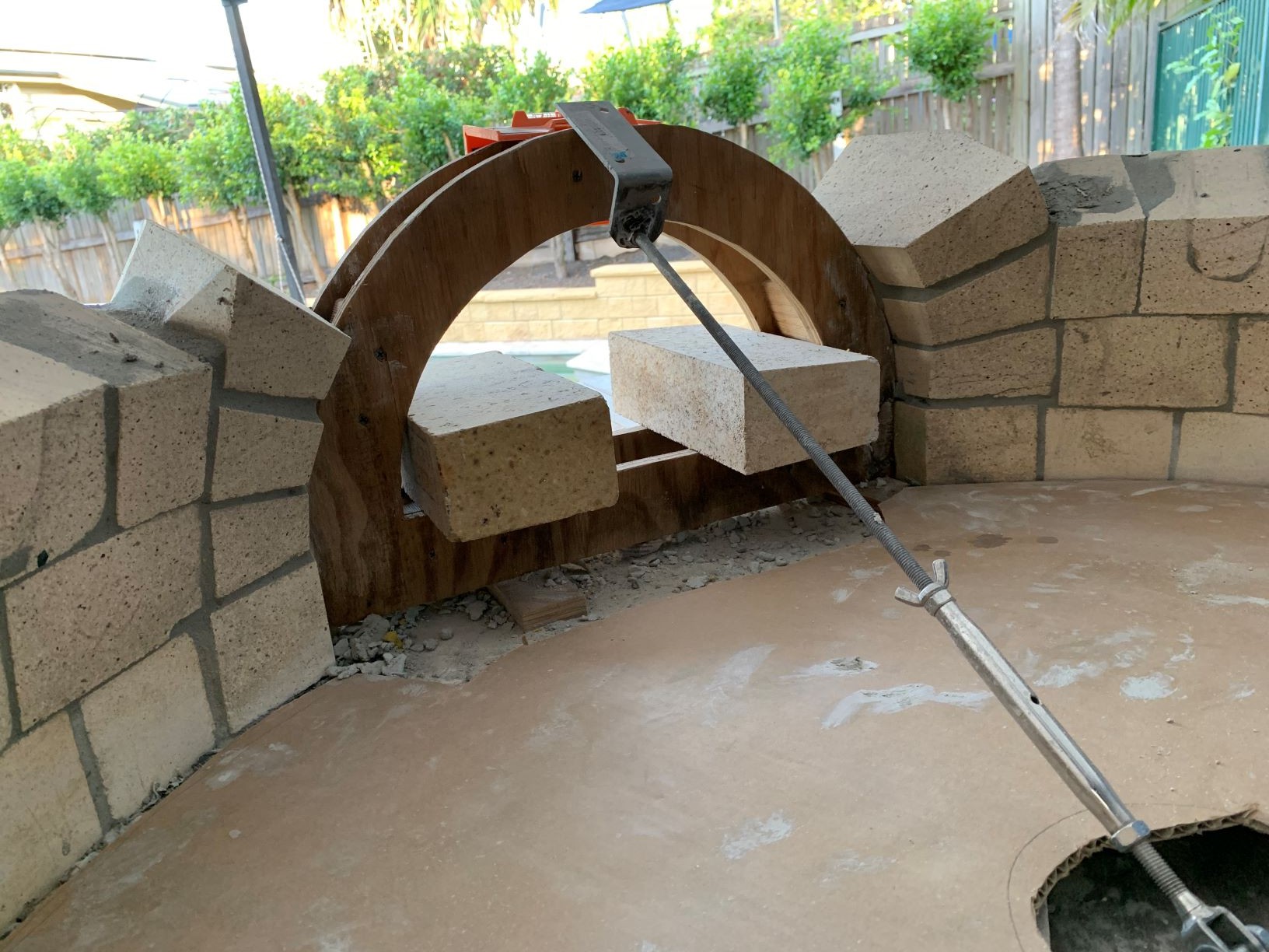

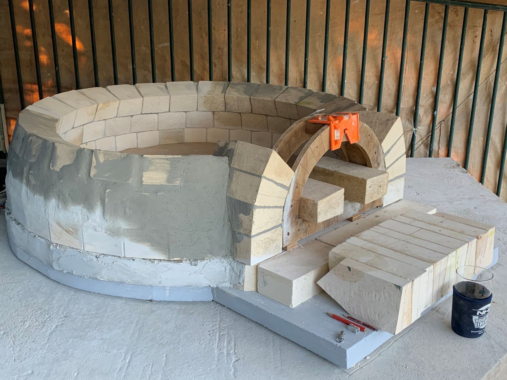

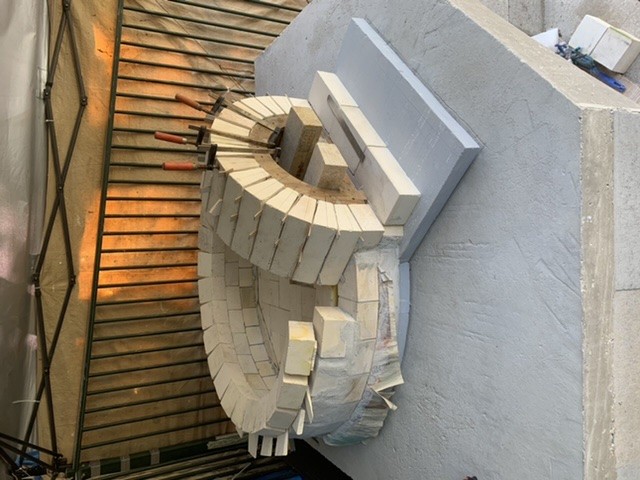

Well done a wet saw!
Don’t even think about using fire brick for external stuff. It just absorbs water even out of the air. And plain firebrick looks pretty dull. Use ‘commons’ the solid bricks without the holes. My entranceway and chimney are all commons no problems.
regards Dave
