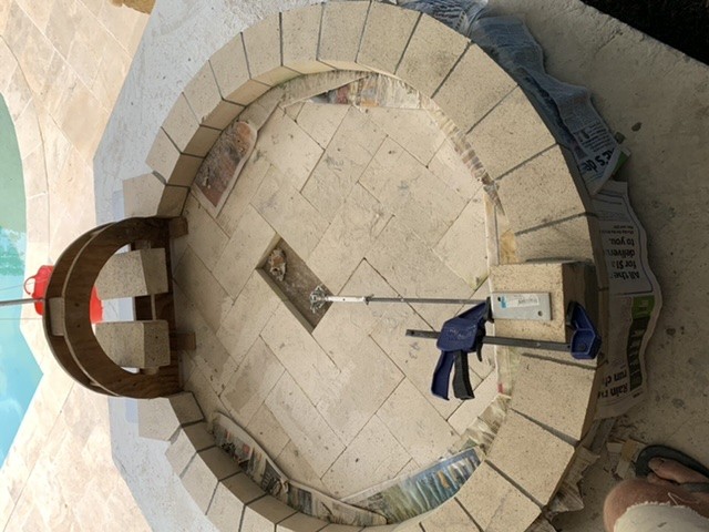

          • #20
            If you look at my build I also had trouble with adhesion on the first course. I did like you and refined my process - brick prep, mortar consistency, and application. Also, once you start to add courses with mortar on all sides of the bricks it will all stick together fine.

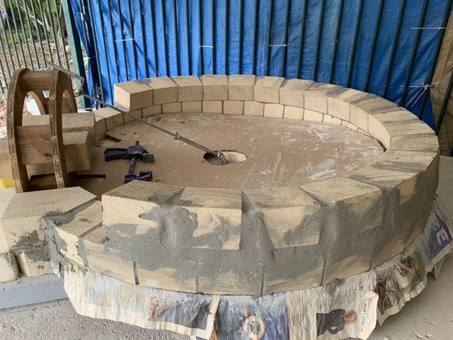

              • #22
                Put the second course down yesterday.
                I don’t have the arch bricks cut so will just build up to arch and cut them in as I go up, does this sound like a sensible idea?
                Just now need to work out how to mark out the bevel(?) for the third course as the inverted V is now showing.
                I was wondering if I can use my laser level to mark the bevel?
                Any thoughts.
                Cheers
                • #23
                  To get rid of the inverted Vee I used a sliding T bevel, which you can pick up here in the States relatively cheap. If you don't have one they are a nice addition to the tool box as I have used mine to transfer/copy angles many times doing home repairs since I built my oven. For brick beveling I would just lay the handle of the bevel along the top of a brick and then eyeball the blade upward perpendicular to the plane of the base of the oven. Then I'd tighten the knob and take the bevel over to my saw to transfer the angle. I tried using the spreadsheet and a digital caliper to set my saw but found just transferring the angle to be much faster and more reliable.

                    • #25
                      I didn't realize you were working without a saw - that will certainly make cutting the bevels more difficult. Yes, for all same width bricks the bevel should be constant along a row. Without a saw you could always use an angle grinder with masonry disk and just rebate the inner edge with the bevel - no need to take the angle all the way to the outside end. Some builders have done that to reduce the amount of cutting necessary and still close up the Vees

                        • #27
                          Not sure about when to switch to thirds. I went a different way - in an attempt to keep all my vertical joints centered on a brick below, I make the bottom width of the bricks in a row the same width as the upper ID face of the brick below it (let me know if I messed up the explanation). This led to my bricks becoming smaller and smaller as I progressed upward but kept the joints neat. I probably went through more bricks that way but a big part of building an oven is figuring out what makes sense to you and is within your skill set and sticking with it. With my saw set-up I cut an edge with just enough taper, then flipped the brick over to cut to width with the proper taper on the other side. I repeated that for the remminant and was left with an increasingly larger leftover as the bricks got smaller. Somewhere in the build I got to where I was getting 3 bricks out of one but would have to stick my head into the oven with a ruler to figure out when. I even got to the point where I could have used 1/4 bricks but switched back to 1/2 at that point which kept the joint pattern correct. Sorry about the long winded reply.

                            • #29
                              G’day
                              Its great to get a neat result but sometimes you’ve got to work with what you have. I built to a ply form with an angle grinder and a brick bulster. The inverted v aren’t dreaded the pic is my oven yesterday still standing. I had a crack at cementing the gapes but decieded I didn’t really like small spaces and just left it as it was. It’s been 10 years now. Still cooks and definitly still standing.
                              Remember it’s a dome and gravity holds everything together the mortars just there to keep the brick orientation to each other and there not the glue that keeps the dome upright.
