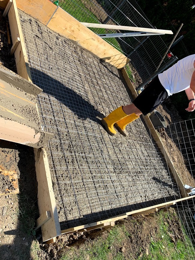

      Since I'm waiting for the CaSil boards to be delivered, I post some pictures of the construction phase

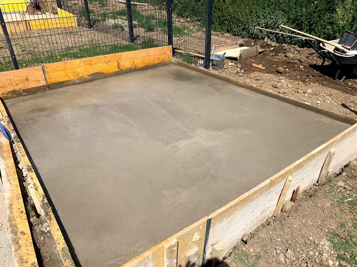

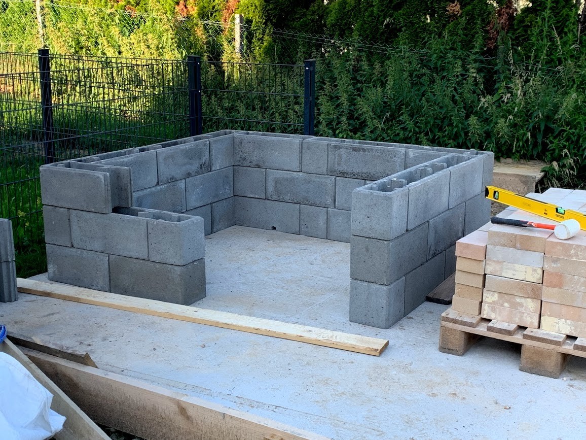

        STARTING THE BASE
        I wanted to make a slightly different oven base, with a side part to use as a "table" or a place for a barbecue.

          Finally the starting point of today ...
          Waiting for the CaSil Boards to come

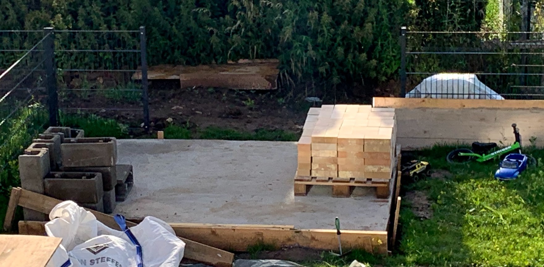

              today, waiting for the calcium silicate boards, I did some dry stacking
              I’m in a way happy that they’re easy to cut with the chisel and the grinder , but in a way I’m worried that they are too soft Click image for larger version

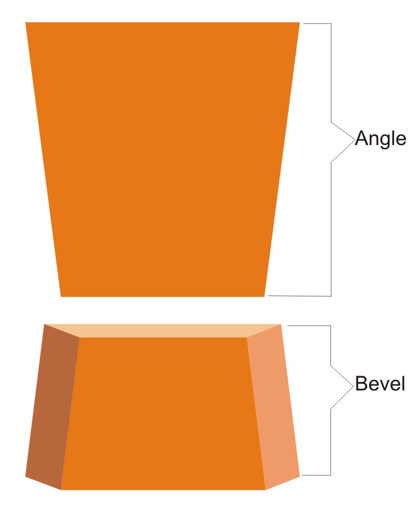

                It looks good! I couldn't get my bricks to get much tighter than that. They opened up a bit doing the dome, so I hope the gaps won't be a problem. I don't know if it is wise to fill in the gaps with the silica/fireclay or mortar or just leave them alone. I could use some wisdom on that too!
                Are your bricks refractory/fire brick or insulating brick? The low to medium-duty refractory bricks are pretty easy to cut with an angle grinder or wet saw, but insulating bricks are super easy and can be cut with a hand saw.
                ARTISTADIMATTONE Google Photo Album-https://photos.app.goo.gl/jdqojBBCZxazcJ3A9
                  As you move up in courses and the dome diameter decreases, unless you bevel the bricks you will start to see what we call an "inverted v" mortar joint. This can be reduced by beveling the top inner corners of the bricks either with a grinder or wet saw. You only need to remove the conflicting material, typically a inch or so back from the top inner corners of the bricks. JR Pizza did this, I did full taper and bevels but that takes time.

                        Yesterday the calcium silicate boards arrived and today I today I put them on the hearth, covered with aluminum foil and on top some tiles. After that, I pour the perlite/concrete layer, about 4 cm
                          The aluminum foil layer seems to have been resurfacing again recently on several builds. I guess the school of thought is some sort of water resistant layer. It goes both ways, Water that gets in also gets trapped limiting egress out. IMHO, I do not think aluminum foil provides any value to the build.
