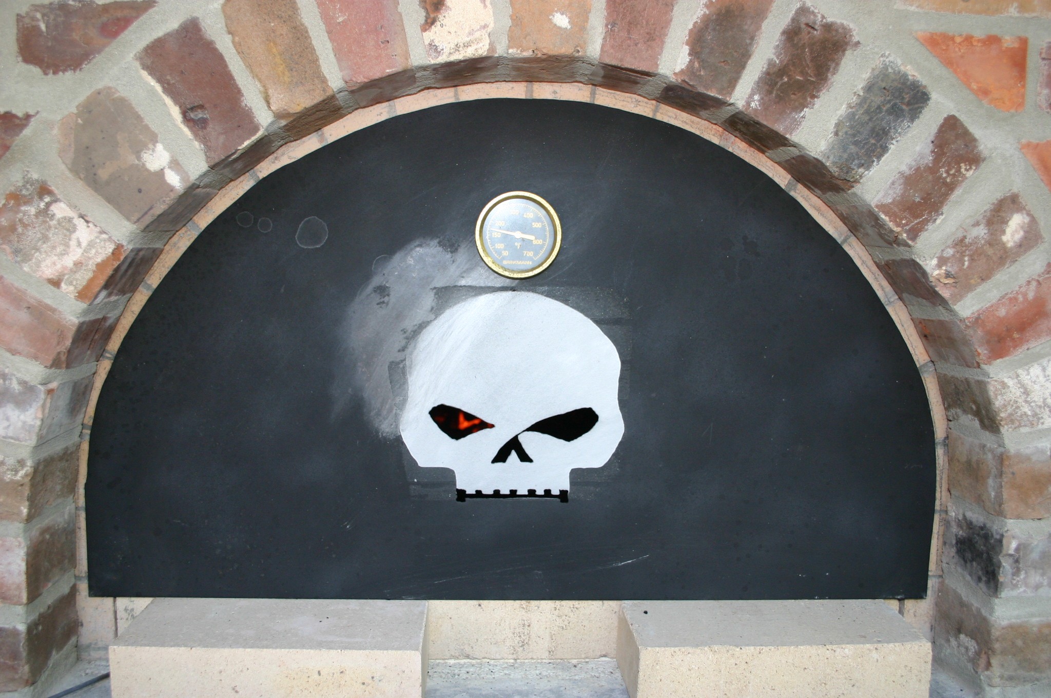

      A small fire will help, if you can resist the temptation of overloading the oven. Many could not! The briquettes alone will work if done correctly. The first few starter fulls will have to be fully fired before placement inside the oven. As the drying advances, they can be partially fired since the draw of fresh air from the oven has been established to feed the burning coals. Once the oven gets hotter a door can be placed partially closed, the draw will still fire the coals with O2 and it will hold more of the heat in. I haven't seen the blast door concept mentioned lately. But this was mine that I used during the drying process. The temp guage helped a lot ito keep up with the progress imo.
      Click image for larger version  Name:	curing 006.JPG Views:	0 Size:	561.6 KB ID:	433027
