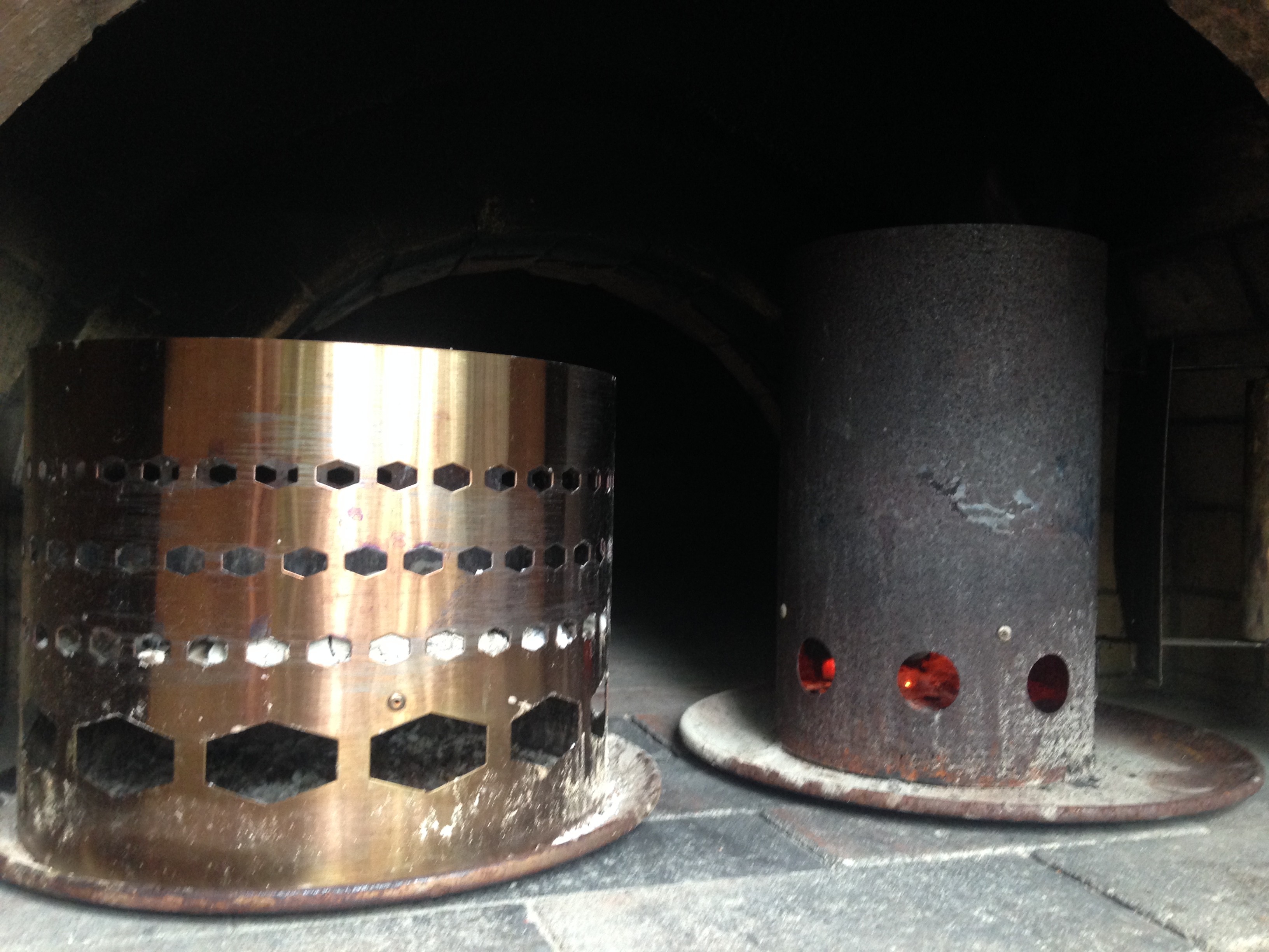

        In the mean time, you may want to find a charcoal chimney starter. There are commercial types made over here that are easy to find. However, many are made with galvanized steel. The one on the right is the one that I used to place all the charcoal in my oven for it's drying fires. It was galvanized. The galvanize has long burned off. The one on the left is made of Stainless Steel.

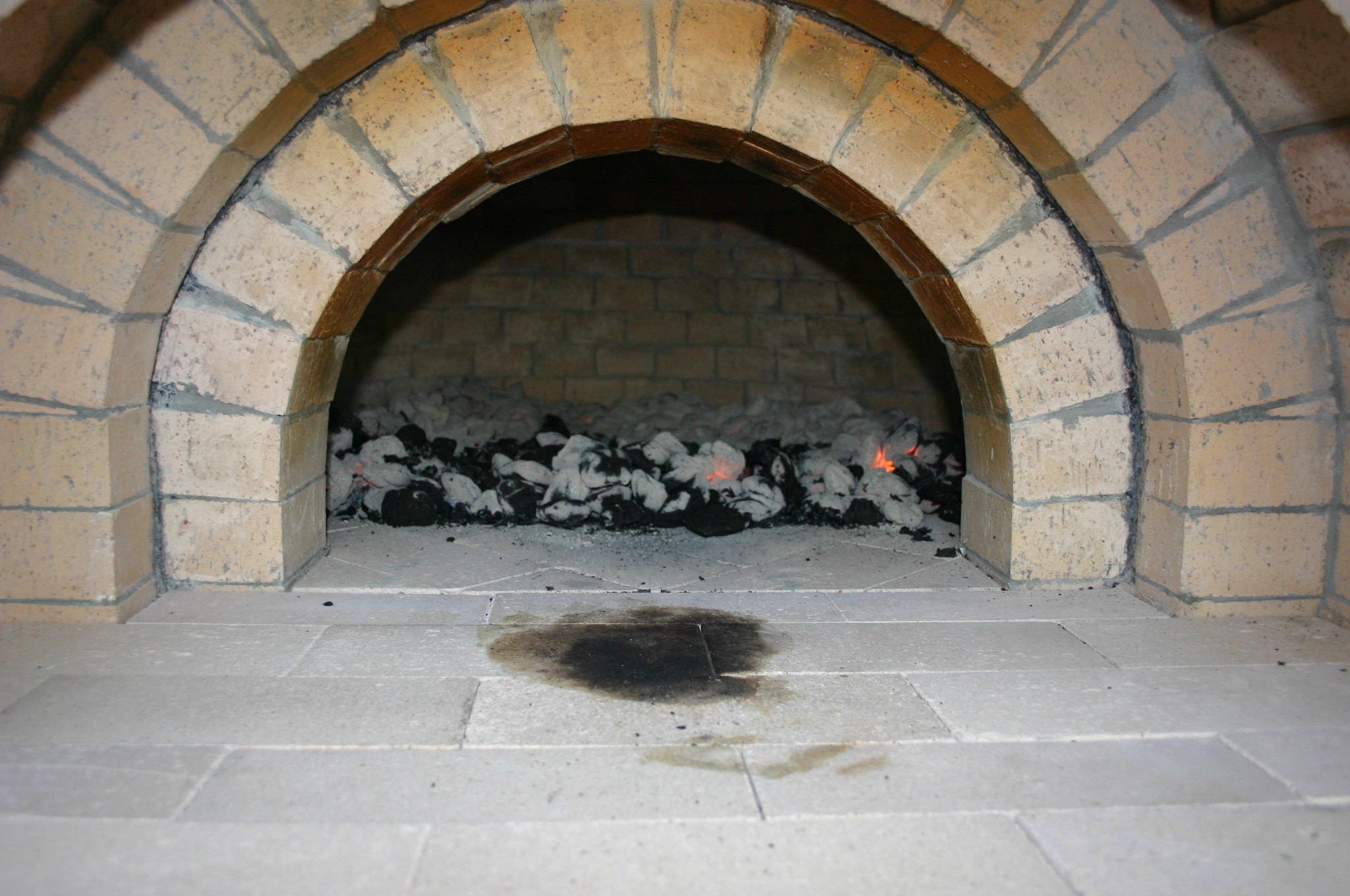

        Before commercial chimney starters were available, lots of folks made their own out of large bean cans. Back then I then started my charcoal bricquettes in the entry with paper (no liquid starter). Notice the stain on the entry floor. I now use a cheap pizza undeneath and other methods to start the charcoal. I also use the starters inside the oven now with lump charcoal to add a little extra heat for certain cooks.
        Elevating the charcoal a little above the floor will increase the heat due to the added air from undeneath. That can be accomplished with a coal grate placed spaced a little above the floor. Switching to lump charcoal after a couple of days can also increase the heat. Lump charcoal burns hotter than briqettes.

          So do you cook in the oven with just the heat from your stainless chimney starter?

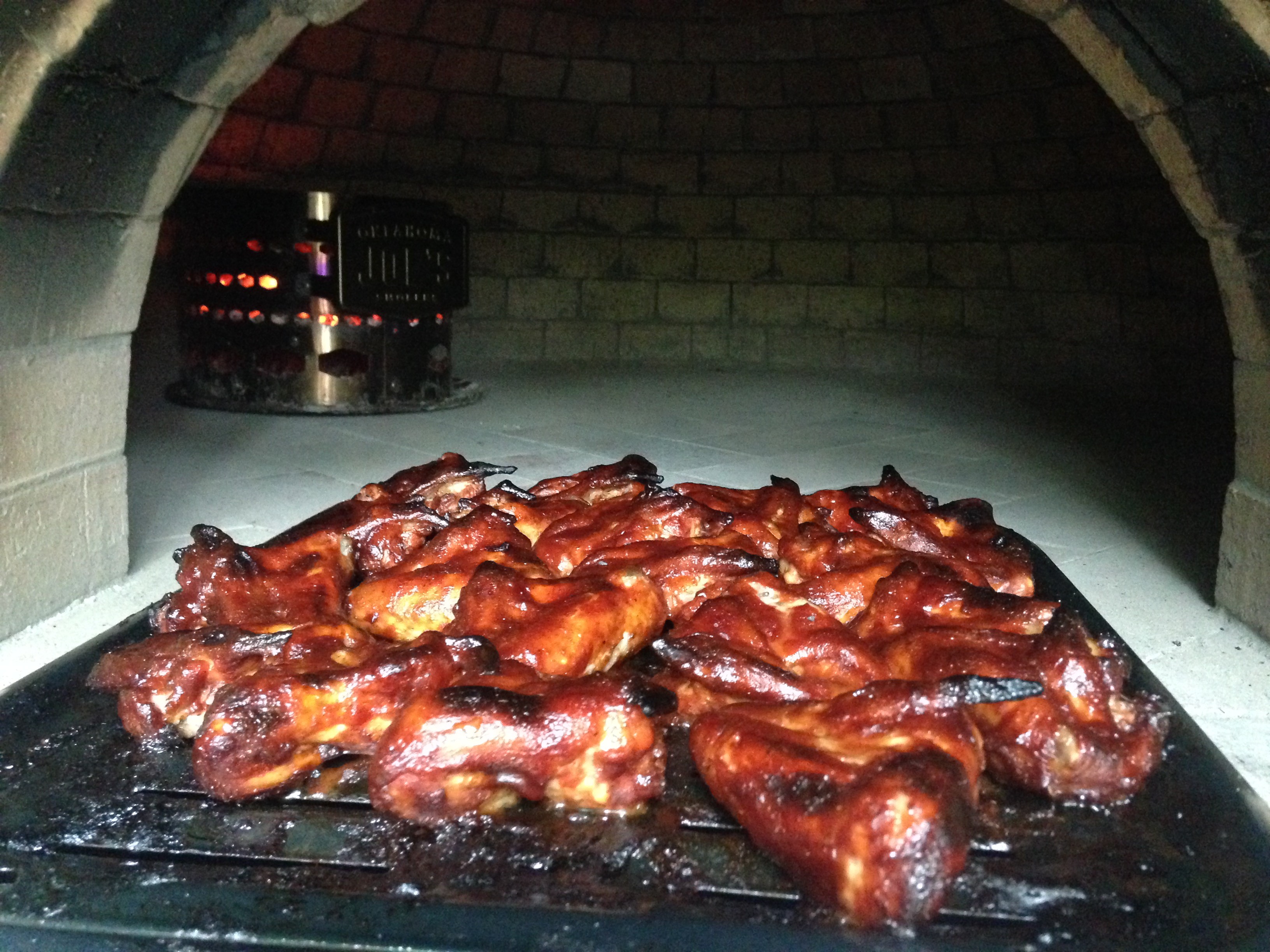

            Not at all. I use it in an oven on the decline "to add a little extra heat for certain cooks." If I have an oven on the decline that is about 250F to 275F, and wanted a 350F oven for a 3 hour cook, I will place a full starter in there with the insulated door partially closed until it burns down. Usually about an hour. I then remove the starter and close the insulated door for about 15 to 20 minutes and then check the temp.
            For the wings above, the oven was probably about the same temp. I cook chicken hot and fast. I started about half a chimney starter full and placed it in the oven with the wings and the door partially open. I probably rotated the broiler pan a couple of times for an even cook. I have a 44" oven. Your mileage may vary .

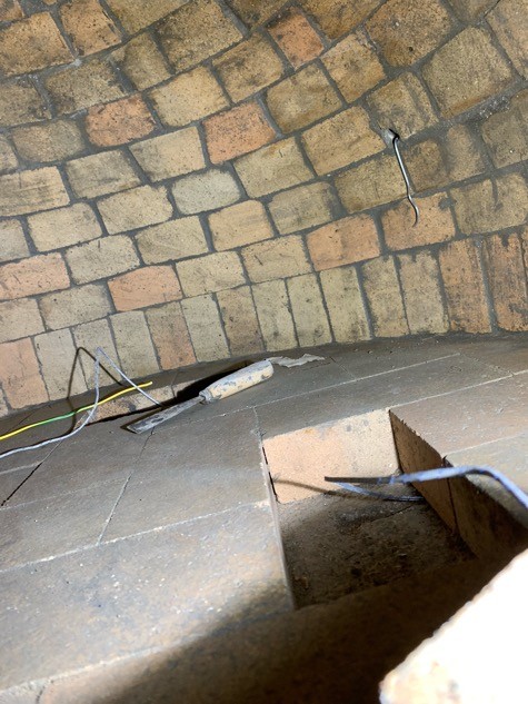

ID:	432937Thermocouples for the Smart Oven 3.0 dome !
                        Tomorrow i start the curing fire !!!!
                        I’m so excited!!!!Click image for larger version
