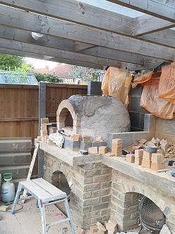

    A few more laid this afternoon.

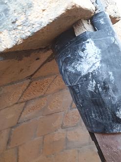

    Ope-dog Thanks. The IT has worked perfect apart from you can't keep going in the same direction as there is a bolt screwed in to the base. So you have to reverse around the direction or it will either tighten or unscrew if you don't reverse.
    some of the IT's on here are amazing but very complicated, mine is very basic from bits laying around.
    The main issue and the reason my build isn't perfectly round is my cutting skills. I used a piece of string to create the circle for the template, then didn't cut very well with a jigsaw, then the cooking floor didn't have perfectly flat edges. This might not sound a big deal but there is about a 1" difference in one part of the circle, where the row meets the inner arch.
    UtahBeehiver The IT is offset as I added a bit of timber between the length of metal and nail. I done this after completing the first row.

    replied
    There are a couple issues with this design that should be addressed. First the center pivot point is not at the center of the dome, this will affect the diameter of the oven as you move up. Second, most important of all. From the pivot point (center off the oven at floor elevation) along the IT rod "Needs" to intersect the mid point on the brick face, This ensures that the brick face in perpendicular to the center of the oven with the correct tilt, if not the error is cumulative as you move up throwing off each course face more and more. Third, IT rod length should be adjustable.
    There are some simple IT out there, just make sure these three items are incorporated in the design.

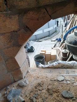

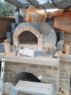

  • Neil.B
    replied
    Few more bricks laid today. Couldn't get much done as i can't bend over for long due to bad back and it's to tight a space to stand up
    First row above inner arch. Each arch brick was cut to match the row of bricks.
    Not perfect, but I'm happy.

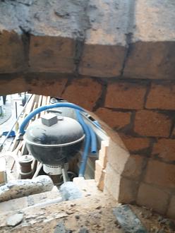

  • Neil.B
    replied
    Got the inner arch and a few more bricks laid today. Took the arch form work out straight away.
