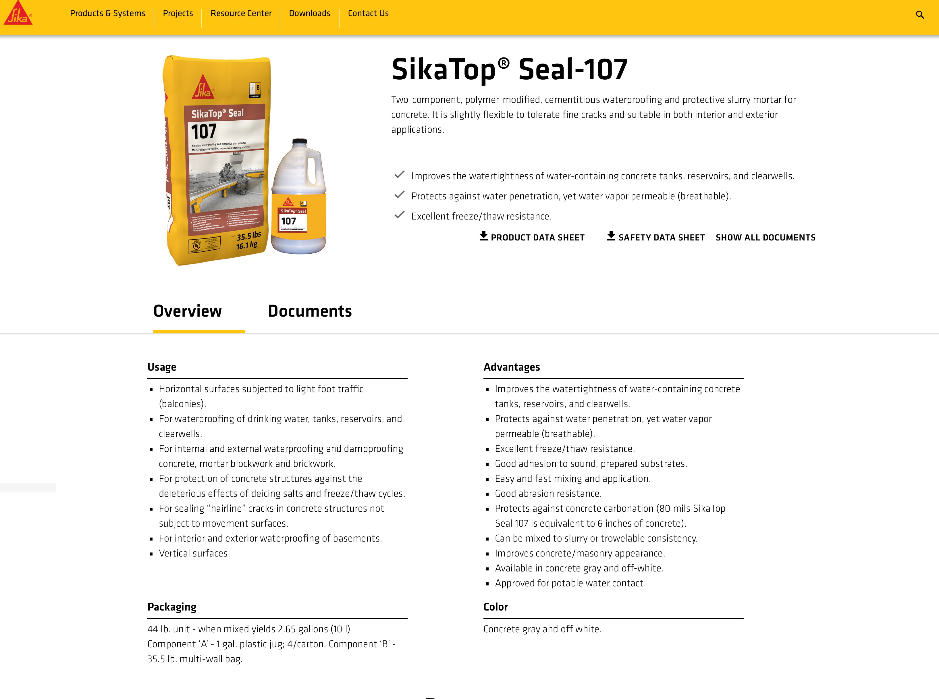

                  After a bit more research, has anyone use this product (Sika #107 Top Seal)? See attached. So, I'm thinking of troweling a base layer of typical mortar mix over the perlcrete. Over that mortar mix trowel this Top Seal #107 product over that, which would provide the waterproofing I'm looking for. Does this seem like a good way or finishing the dome? Thanks.

                    #219
                    I think, Les (Les' Build) from Lake Tahoe used and elastomer stucco coating the seems to hold up well in his high elevation and cold climate. You will have to look in his build thread for the name, Dura something.

                      #220
                      Thanks, Russel. I looked at Les's oven build thread. Dryvit is the "system" sealer he used. I looks like it's something similar to Top Seal #107 I'm looking at. I suppose there's a few of these waterproof sealer systems available.... finding the best one for our environment and someone locally who carries it is the next step. Thanks for the reply.

                        #221
                        Yes, Dryvit is the name, kind of close with my recall. I think several members have used this product.
                          I have used a number of Sika products over the years. All are good. I think that should work as a waterproof plaster. I intend adding a layer of the same product to my plaster render oven as the existing outer layer is not waterproof enough for my liking. But then, I probably don't have to as I have a waterproof foil layer under. Most people here advise against a foil layer for fear of trapping moisture under.

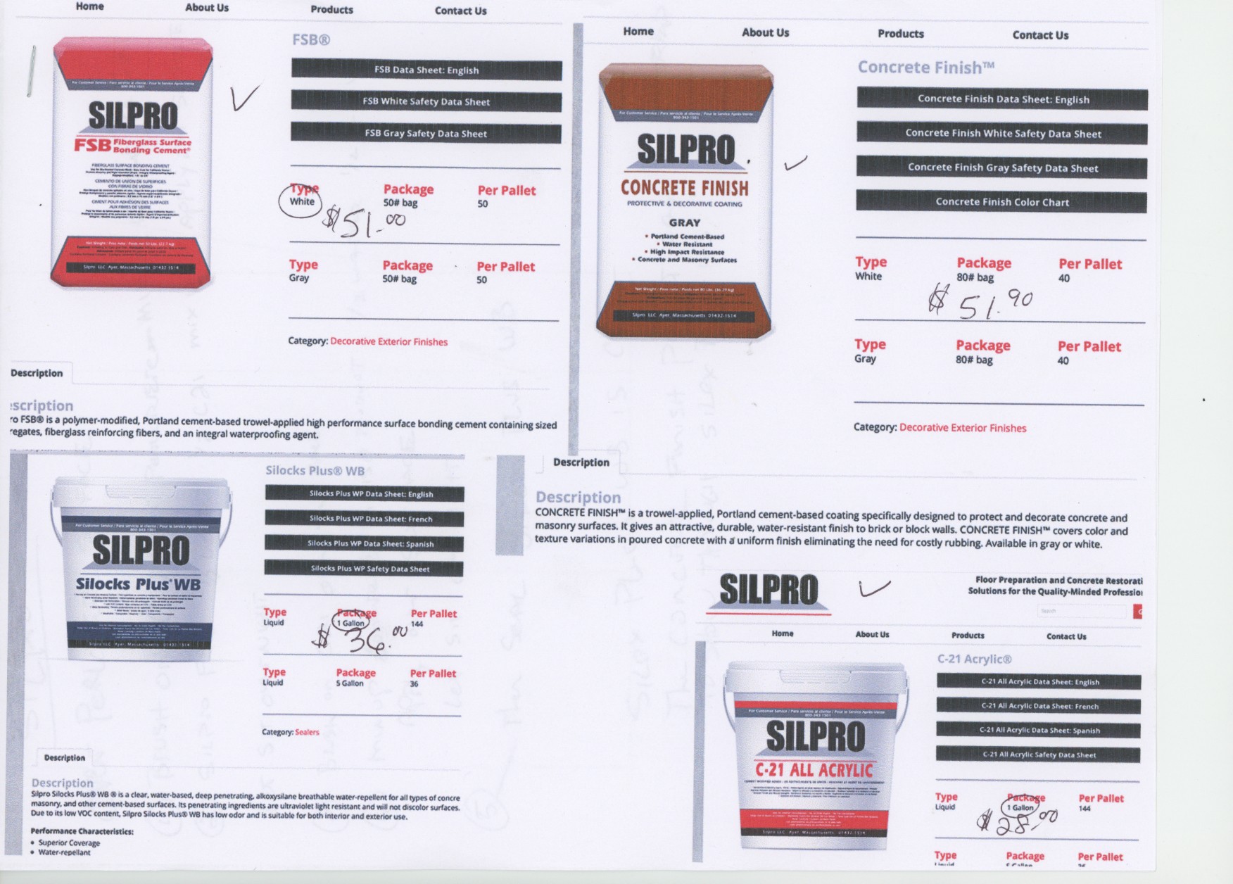

                            After yet more research and a conversation with a rep at Silpro, I'm going to use this method noted below for the final render over the perlcrete .......for those that are interested.
                            This should provide the 1) strength and 2) the weatherproofing I'm looking for.
                            1) Over the perlcrete surface of the dome brush straight (not diluted) C-1 All Acrylic mixture. It's kind of sealer and bonding agent.
                            2) When that dries, trowel on a layer of FSB Fiberglass Surface Bonding Cement (mix with 50# bag is 1/2 water and 1/2 C-1= to 5 or 6 quarts of this mixture)
                            3) Next day or when the FSB cures, trowel on a layer of Concrete Finish (this comes in white or gray. I'll get white and can be tinted). Mixed with the 1/2 water -1/2 C-1 mixture.
                            4) When cured, coated with Silocks Plus WB ( a clear sealant).
